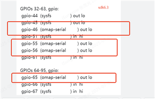

2. The gpio num is different the same config in dts between sdk 6.3 and sdk 9.1/9.3
such as in sdk 6.3:
while use sdk9.1 :
The gpio numbers of the I2C external expansion IO PCA9535 in sdk 6.3 have changed from 496-511 to 2026-2041 in SDK 9.1 ,Can we keep it consistent with the old sdk through simple modifications
