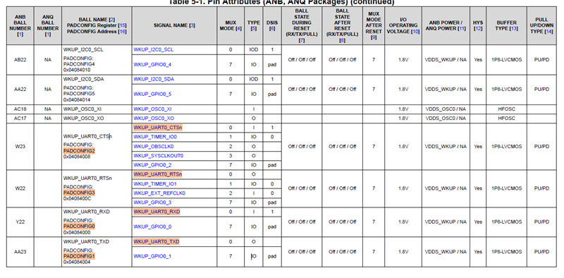

Hi Team,
While working on the AM62L3 platform and generating pin configurations using the SysConfig tool, I observed that the wkup_i2c and wkup_uart peripherals are listed under a separate section called mcu_pmx, indicating they belong to the MCU domain pinmux. However, when referring to the k3-am62l3-evm.dts file in the TI SDK, I noticed that the pin configurations for these peripherals are placed under the &pmx node, which typically refers to the main domain pinmux controller. This creates some confusion regarding which domain—pmx or mcu_pmx—should be used when adding pinctrl entries for wkup_i2c and wkup_uart in the device tree. Could you please confirm the correct domain for these peripherals and clarify whether the usage of &pmx in the EVM DTS is intentional or if these should ideally be placed under mcu_pmx as per the SysConfig output? Understanding this mapping clearly will help ensure that our custom board's pin configurations are applied correctly.

  • Hi Dheeraj,
    Thanks for reporting the above. It seems to be bug in the Pinmux tool.
    I have checked internally and got the information that we only have a single pmux node for the device tree. There is no MCU domain for AM62L devices.
    The same information can be verified by referring to datasheet also. There are no MCU_PADCONFIG registers for wkup_uart, and wkup_i2c. These peripherals also uses the PADCONFIG define in Main domain.
    Please refer below images.
