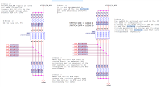

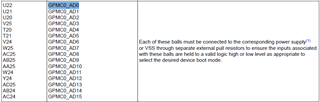

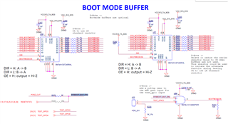

as below screenshot show, if we do not use GPMC function(no NOR/NAND flash), if these PINs(GPMC0_AD0~GPMC0_AD15) must connect to VSS(if these PINs not used)? or can we just leave it open?
also, these multi_function PINs can be used as other function as below show, right?
