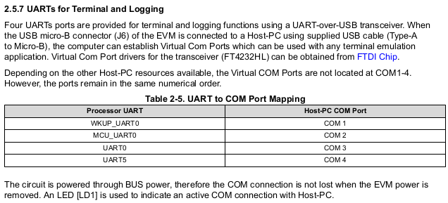

TDA4AEN-Q1: boot from uart- which uart?
Part Number: TDA4AEN-Q1
we want to use the boot from UART option for the first bring up of our custon board, since the eMMC flash will be blank.   the TRM says use port 0 UART.  but there are three different "port 0" on the tda4.  there's the MCU-UART, the WAKEUP_UART, and the A53 UART.  which one am i to use?  thanks!
