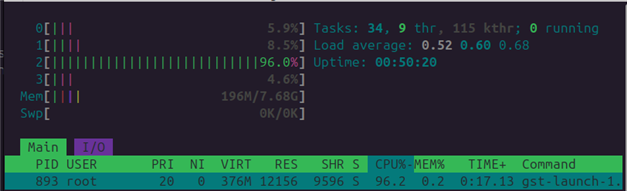

Hi i'm using this pipeline
root@am62pxx-evm-lohr-recovery-mode:~# gst-launch-1.0 -v v4l2src device=/dev/video3 ! video/x-raw,format=UYVY,width=1280,height=720,framerate=30/1 ! videoconvert ! video/x-raw, width=1
280, height=720, framerate=30/1, format=NV12 ! waylandsink sync=false
but my CPU usage is too high.
How can I low the cpu usage?

  • Hi Sergio,
    could you please replace software 'videoconvert' with hardware accelerated plugin 'tiovxcolorconvert' .
    color conversion tasks to dedicated hardware accelerators on TI SoCs, leading to significantly lower CPU utilization and higher performance compared to software-based conversions.

  • Hi Sergio,
    tiovxcolorconvert is not present on  AM62P.
    Can you share the output when you don't use videoconvert and use kmssink as the display sink instead of waylandsink.
    I guess, waylandsink is doing an additional videoconvert before displaying the contents.

  • What version of SDK are you testing with Sergio?
    kmssink driver-name=tidss sync=false
    Also, I want you to remove the videoconvert from the pipeline, when using the above element (kmssink)
