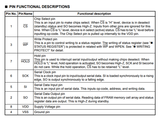

Hi All,
We plan to connect Nor Flash to OSPI.
We would like to connect FeRAM (MB85RS4MTPF-G) as well. Can we use normal SPI?
If possible, are there any changes to the specifications compared to when connecting to OSPI?
