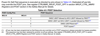

In our original hardware design, MCU8&9 is pulled up for MCU_BOOTMODE setting.
And now PBIST and LBIST are needed.
Could we change the POST sequence while eFuse programming in our factory without modifying the HW BOM?
SOC PN:  TDA4VE88T5AALZRQ1

    Which PBIST and LBIST are you looking at? The MCU_BOOTMODE pins dictate the HWPOST behavior, and this is run even before ROM gets to run.
    You can run PBIST and LBIST for other modules in s/w.
    No, this is not possible. There is no eFuse control for this. The only eFuses the Customer can program are associated with the Security eFuses that are programmed using KeyWriter.

  • Hi Suman,
    We are processing MCU and  A-core  PBIST/LBIST.
    So, the bootmode value must be updated to MCU9=0 If SOC executes MCU BIST first?
    By the way, the eFUSE programming which can replace the POST sequence is in TI's Factory?
  • Hi Ryan,
    A-Core PBIST/LBIST would have to be triggered in s/w through the SDL API.
    The BIST for MCU and Wkup domains being a Safety island needs to be run through the HWPOST.
    Yes, the bootmode value has to be latched with MCU9=0, not something you can modify using s/w. HWPOST is run before any s/w is run.
    This section is a common chapter on all the TDA4 TRMs, but the footnote is only applicable to the earlier TDA4VM SoCs. There is no such provision for later devices including TDA4VE/TDA4VL.
    We will be adding another footnote for this in future TRM updates to make this clear.
