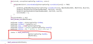

    I have spent some times to look into IpcNotify Init function. Inside IpcNotify Init, there is HwiP_construct function that causes an issue. I have attached the capture from IpcNotify init function below.
