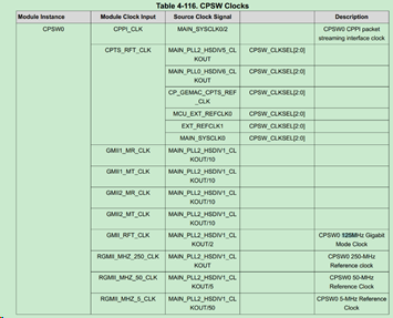

  • Hello
    We use the Marvel 88q5152, we do not change is mannualy, we just change the phy->link to up and phy-speed to 1000, the uboot then try to change the mac control register to 0xA1.
    Additionally could help clarity how the GMII_RFT_CLK is selected, it is by any register or automatically once the mac control register is set?
    My understanding is that the Linux drivers should already handle clock configuration as well as all necessary MAC register configurations to bring up your Ethernet interface and that the only changes that are necessary on your end is ensuring your device tree is correctly configured and you didn't unknowingly connect to a lower link speed link partner (assuming there are no issues on your Marvel PHY configuration and custom hardware).
