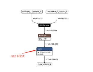

TDA4VH-Q1: When the convolutional layer is set to 16-bit, the board-end demo will crash when running to this convolutional layer
Part Number: TDA4VH-Q1
Other Parts Discussed in Thread: AM69A
We are using the tidl model import tool, and we found that when the convolutional layer is set to 16-bit, the board-end demo will crash when running to this convolutional layer.
We tested and found that only the convolutional layer with a gridsample layer before it would cause this issue.
All the data is in the compressed package.

  • One additional point: we tested it on version 11.08 of TIDL model import tool.
    hongyao
    I test it on 11.0.8.0 tidl with edgeai tidl tools. I cannot reproduce this issue.

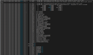

    My infer log on evm:
    root@am69-sk:/opt/edgeai/edgeai-tidl-tools/examples/osrt_python/ort# python3 onnxrt_ep.py -m gridsample16bit

    [C7x_1 ]    103.837838 s: dstMemPtr:     1686411904
         9,         819583,         289935,         783583,           8270,           3376,                 0,              0,             ,
     Sum of Layer Cycles 9864195
    [C7x_1 ]    103.837866 s: Link Id 3825205376,  Number of TR required = 1
    [C7x_1 ]    103.837893 s: ===================================================
    [C7x_1 ]    103.837914 s: Link Index 3825205376
    [C7x_1 ]    103.837937 s: Flow 1 Src Shape: 0 Sink Shape 0
    [C7x_1 ]    103.837966 s: Link->src-> icnt (dim); 4 256 (4) 1 (4) 1 (1024)
    [C7x_1 ]    103.837997 s: Link->sink-> icnt (dim); 4 256 (4) 1 (4) 1 (0)
    [C7x_1 ]    103.838017 s: srcMemPtr:     4432208384
    [C7x_1 ]    103.838034 s: dstMemPtr:     1686563456
    [C7x_1 ]    103.838062 s: Link Id 3841982592,  Number of TR required = 1
    [C7x_1 ]    103.838090 s: ===================================================
    # NETWORK_EXECUTION_TIME =    12.26 (in ms, c7x @1GHz) with DDR_BANDWIDTH (Read + Write) =    69.24,    39.60,   108.84 (in Mega Bytes/
     ...[C7x_1 ]    103.838133 s: Flow 1 Src Shape: 2 Sink Shape 0
    [C7x_1 ]    103.838164 s: Link->src-> icnt (dim); 384 32 (416) 2 (13312) 172 (0)
    [C7x_1 ]    103.838199 s: Link->sink-> icnt (dim); 384 32 (17056) 8 (545792) 43 (384)
    [C7x_1 ]    103.838221 s: srcMemPtr:     1745438720
    [C7x_1 ]    103.838239 s: dstMemPtr:     4295362560
    [C7x_1 ]    103.840050 s: Start Layer Idx 8
    [C7x_1 ]    103.840075 s: kerInitArgs->funcStyle           1
    [C7x_1 ]    103.840099 s: kerInitArgs->No                  256
    [C7x_1 ]    103.840121 s: kerInitArgs->inChOffset          1056
    [C7x_1 ]    103.840144 s: kerInitArgs->validColsIn         513
    [C7x_1 ]    103.840167 s: kerInitArgs->validColsPerRowIn   0
    [C7x_1 ]    103.840188 s: kerInitArgs->validRowsIn         0
    [C7x_1 ]    103.840211 s: kerInitArgs->inputPitchPerRow    256
    [C7x_1 ]    103.840234 s: kerInitArgs->outputPitchPerRow   256
    [C7x_1 ]    103.840257 s: kerInitArgs->inWidth             128
    [C7x_1 ]    103.840279 s: kerInitArgs->pad                 0
    [C7x_1 ]    103.840301 s: kerInitArgs->maxHeight           128
    [C7x_1 ]    103.840323 s: kerInitArgs->subMChannels        32
    [C7x_1 ]    103.840345 s: kerInitArgs->Fr                  3
    [C7x_1 ]    103.840367 s: kerInitArgs->Fc                  3
    [C7x_1 ]    103.840389 s: kerInitArgs->strideX             1
    [C7x_1 ]    103.840410 s: kerInitArgs->strideY             1
    [C7x_1 ]    103.840444 s: kerInitArgs->dilationX           1
    [C7x_1 ]    103.840467 s: kerInitArgs->dilationY           1
    [C7x_1 ]    103.840489 s: kerInitArgs->bias                32767
    [C7x_1 ]    103.840511 s: kerInitArgs->activationType      2
    [C7x_1 ]    103.840533 s: kerInitArgs->mode                0
    [C7x_1 ]    103.840555 s: src0Addr->data_type              1
    [C7x_1 ]    103.840577 s: src0Addr->dim_x                  1152
    [C7x_1 ]    103.840599 s: src0Addr->dim_y                  32
    [C7x_1 ]    103.840622 s: src0Addr->stride_y               2368
    [C7x_1 ]    103.840644 s: src1Addr->data_type              1
    [C7x_1 ]    103.840666 s: src1Addr->dim_x                  642
    [C7x_1 ]    103.840689 s: src1Addr->dim_y                  128
    [C7x_1 ]    103.840712 s: src1Addr->stride_y               2112
    [C7x_1 ]    103.840734 s: dstAddr->data_type               1
    [C7x_1 ]    103.840756 s: dstAddr->dim_x                   384
    [C7x_1 ]    103.840778 s: dstAddr->dim_y                   32
    [C7x_1 ]    103.840801 s: dstAddr->stride_y                832
    [C7x_1 ]    103.840818 s: End Layer Idx 8
    [C7x_1 ]    103.841260 s: Not enough memory to allocate intMemPtr in MSMC
    [C7x_1 ]    103.841299 s: Warning: Trying to get scratch mem from DDR. Expect performance degradation!
    [C7x_1 ]    103.841333 s: Link Id 3758096512,  Number of TR required = 3
    [C7x_1 ]    103.841361 s: ===================================================
    [C7x_1 ]    103.841391 s: Link Id 3808428160,  Number of TR required = 1
    [C7x_1 ]    103.841419 s: ===================================================
    [C7x_1 ]    103.841447 s: Link Id 3825205376,  Number of TR required = 1
    [C7x_1 ]    103.841475 s: ===================================================
    [C7x_1 ]    103.841504 s: Link Id 3841982592,  Number of TR required = 1
    [C7x_1 ]    103.841836 s: Alg Init for Layer # -    9
    [C7x_1 ]    105.184129 s: TIDL_process is started with handle : 100000000
    [C7x_1 ]    105.184171 s: PREEMPTION: Requesting UNLOCK for priroty object and targetPriority 256 is serviced
    [C7x_1 ]    105.184218 s: PREEMPTION: Requesting LOCK for priroty object with handle = 100000000 and targetPriority 256
    [C7x_1 ]    105.184273 s: PREEMPTION: Request of LOCK for priroty object with handle = 100000000 and targetPriority 256 is serviced wit0
     ....[C7x_1 ]    105.184371 s: TIDL_activate is called with handle : 100000000 - Copying handle of size 20144 from 100000000 to 682d200
    [C7x_1 ]    105.184457 s: PREEMPTION: Requesting UNLOCK for priroty object and targetPriority 256
    [C7x_1 ]    105.184499 s: PREEMPTION: Requesting UNLOCK for priroty object and targetPriority 256 is serviced
    [C7x_1 ]    105.184545 s: PREEMPTION: Requesting LOCK for priroty object with handle = 100000000 and targetPriority 256
    [C7x_1 ]    105.184599 s: PREEMPTION: Request of LOCK for priroty object with handle = 100000000 and targetPriority 256 is serviced wit0
    [C7x_1 ]    105.184633 s: Coreid 0 Layerid to execute = 2
    [C7x_1 ]    105.184662 s: Core 0 Alg Process for Layer # -    2, layer type 29
    [C7x_1 ]    105.184689 s: Processing Layer # -    2
    [C7x_1 ]    105.184752 s: Core 0 End of Layer # -    2 with outPtrs[0] = 6800d800
    [C7x_1 ]    105.184783 s: Coreid 0 Layerid to execute = 4
    [C7x_1 ]    105.184812 s: Core 0 Alg Process for Layer # -    4, layer type 41
    [C7x_1 ]    105.184837 s: Processing Layer # -    4
    [C7x_1 ]    105.184885 s: Core 0 End of Layer # -    4 with outPtrs[0] = 68000000
    [C7x_1 ]    105.184913 s: Coreid 0 Layerid to execute = 3
    [C7x_1 ]    105.184941 s: Core 0 Alg Process for Layer # -    3, layer type 29
    [C7x_1 ]    105.184967 s: Processing Layer # -    3
     .....[C7x_1 ]    105.185039 s: Core 0 End of Layer # -    3 with outPtrs[0] = 6800d800
    [C7x_1 ]    105.185067 s: Coreid 0 Layerid to execute = 5
    [C7x_1 ]    105.185095 s: Core 0 Alg Process for Layer # -    5, layer type 43
    [C7x_1 ]    105.185119 s: Processing Layer # -    5
    [C7x_1 ]    105.186923 s: Core 0 End of Layer # -    5 with outPtrs[0] = 100060800
    [C7x_1 ]    105.186952 s: Coreid 0 Layerid to execute = 6
    [C7x_1 ]    105.186982 s: Core 0 Alg Process for Layer # -    6, layer type 41
    [C7x_1 ]    105.187007 s: Processing Layer # -    6
    [C7x_1 ]    105.187359 s: Core 0 End of Layer # -    6 with outPtrs[0] = 1008b4c00
    [C7x_1 ]    105.187387 s: Coreid 0 Layerid to execute = 7
    [C7x_1 ]    105.187416 s: Core 0 Alg Process for Layer # -    7, layer type 38
    [C7x_1 ]    105.187440 s: Processing Layer # -    7
    [C7x_1 ]    105.187471 s: Core 0 End of Layer # -    7 with outPtrs[0] = 1008b4c00
    [C7x_1 ]    105.187497 s: Coreid 0 Layerid to execute = 8
    [C7x_1 ]    105.187526 s: Core 0 Alg Process for Layer # -    8, layer type 1
    [C7x_1 ]    105.187550 s: Processing Layer # -    8
    [C7x_1 ]    105.194287 s: Core 0 End of Layer # -    8 with outPtrs[0] = 100060800
    [C7x_1 ]    105.194317 s: Coreid 0 Layerid to execute = 9
    [C7x_1 ]    105.194346 s: Core 0 Alg Process for Layer # -    9, layer type 29
    [C7x_1 ]    105.194371 s: Processing Layer # -    9
    [C7x_1 ]    105.195199 s: Core 0 End of Layer # -    9 with outPtrs[0] = c030b000
    [C7x_1 ]    105.195227 s: Coreid 0 Layerid to execute = -1
    [C7x_1 ]    105.195262 s: PREEMPTION: Requesting UNLOCK for priroty object and targetPriority 256
    [C7x_1 ]    105.195308 s: PREEMPTION: Requesting UNLOCK for priroty object and targetPriority 256 is serviced
    [C7x_1 ]    105.195354 s: PREEMPTION: Requesting LOCK for priroty object with handle = 100000000 and targetPriority 256
    [C7x_1 ]    105.195409 s: PREEMPTION: Request of LOCK for priroty object with handle = 100000000 and targetPriority 256 is serviced wit0
    [C7x_1 ]    105.195453 s: TIDL_process is completed with handle : 100000000
    [C7x_1 ]    105.195492 s: PREEMPTION: Requesting UNLOCK for priroty object and targetPriority 256
    [C7x_1 ]    105.195535 s: PREEMPTION: Requesting UNLOCK for priroty object and targetPriority 256 is serviced
    [C7x_1 ]    106.199925 s: TIDL_deactivate is called with handle : 100000000 - Copying handle of size 20144 from 682d2000 to 100000000
    APP: Deinit ... !!!
    REMOTE_SERVICE: Deinit ... !!!
    [C7x_1 ]    106.200041 s: PREEMPTION: Removing priroty object with handle = 100000000 and targetPriority = 256,      Number of obejcts 6
    REMOTE_SERVICE: Deinit ... Done !!!
       106.539062 s: IPC: Deinit ... !!!
       106.539875 s: IPC: DeInit ... Done !!!
       106.539896 s: MEM: Deinit ... !!!
       106.539906 s: DDR_SHARED_MEM: Alloc's: 8 alloc's of 20016464 bytes
       106.539914 s: DDR_SHARED_MEM: Free's : 8 free's  of 20016464 bytes
       106.539921 s: DDR_SHARED_MEM: Open's : 0 allocs  of 0 bytes
       106.539933 s: MEM: Deinit ... Done !!!
    APP: Deinit ... Done !!!
    root@j784s4-evm:/opt/0711_simple_demo2#

    Ouput : dataId=6, name=/bev_encoder/con_layer.0/con_layer.0.0/layer/layer.0/Conv_output_0, elementType 6, scale=1.000000, zero point=0, layout=0
        144423488,    137.733 0x797860223010
    worstCaseDelay for Pre-emption is 0.0000000
    Network File Read done
    Calling algAlloc
    TIDL_initDebugTraceParams Done
    TIDL Memory size requiement (record wise):
    MemRecNum   , Space               , Attribute   , Alignment   , Size(KBytes), BasePtr
    0           , DDR Cacheable       , Persistent  ,  128, 19.67   , 0x00000000
    1           , DDR Cacheable       , Persistent  ,  128, 0.66    , 0x00000000
    2           , DDR Cacheable       , Scratch     ,  128, 16.00   , 0x00000000
    3           , DDR Cacheable       , Scratch     ,  128, 4.00    , 0x00000000
    4           , DDR Cacheable       , Scratch     ,  128, 56.00   , 0x00000000
    5           , DDR Cacheable       , Persistent  ,  128, 259.38  , 0x00000000
    6           , DDR Cacheable       , Scratch     ,  128, 24943.00, 0x00000000
    7           , DDR Cacheable       , Scratch     ,  128, 0.12    , 0x00000000
    8           , DDR Cacheable       , Scratch     ,  128, 24576.12, 0x00000000
    9           , DDR Cacheable       , Scratch     ,  128, 32771.00, 0x00000000
    10          , DDR Cacheable       , Persistent  ,  128, 293.47  , 0x00000000
    11          , DDR Cacheable       , Scratch     ,  128, 4096.25 , 0x00000000
    12          , DDR Cacheable       , Persistent  ,  128, 0.12    , 0x00000000
    13          , DDR Cacheable       , Persistent  ,  128, 141038.69, 0x00000000
    14          , DDR Cacheable       , Persistent  ,  128, 0.00    , 0x00000000
    15          , DDR Cacheable       , Persistent  ,  128, 0.12    , 0x00000000
    Total memory size requirement (space wise):
    Mem Space , Size(KBytes)
    DDR Cacheable, 228074.61
    NOTE: Memory requirement in host emulation can be different from the same on EVM
          To get the actual TIDL memory requirement make sure to run on EVM with
          debugTraceLevel = 2
    Num,    Space,     SizeinBytes,   SineInMB
       0,    17,        20144,      0.019 0x5b52cf4c2880
       1,    17,          672,      0.001 0x5b52cf4c7800
       2,    17,        16384,      0.016 0x5b52cf4c7b80
       3,    17,         4096,      0.004 0x5b52cf4cbc00
       4,    17,        57344,      0.055 0x5b52cf4ccd00
       5,    17,       265600,      0.253 0x7978fcc9e080
       6,    17,     25541632,     24.358 0x79785e9c7080
       7,    17,          128,      0.000 0x5b52cf4c1700
       8,    17,     25165952,     24.000 0x79785d1c6080
       9,    17,     33557504,     32.003 0x79785b1c5080
      10,    17,       300512,      0.287 0x7978fcc54080
      11,    17,      4194560,      4.000 0x79785adc4080
      12,    17,          128,      0.000 0x5b52cf4c1800
      13,    17,    144423616,    137.733 0x797852408080
      14,    17,            1,      0.000 0x5b52cf4dad80
      15,    17,          128,      0.000 0x5b52cf4dae80
    Total External Memory (DDR) Size =    233548401,    222.729
    TIDL init call from ivision API
    0           , DDR Cacheable       , Persistent  ,  128, 19.67   , 0xcf4c2880
    1           , DDR Cacheable       , Persistent  ,  128, 0.66    , 0xcf4c7800
    2           , DDR Cacheable       , Scratch     ,  128, 16.00   , 0xcf4c7b80
    3           , DDR Cacheable       , Scratch     ,  128, 4.00    , 0xcf4cbc00
    4           , DDR Cacheable       , Scratch     ,  128, 56.00   , 0xcf4ccd00
    5           , DDR Cacheable       , Persistent  ,  128, 259.38  , 0xfcc9e080
    6           , DDR Cacheable       , Scratch     ,  128, 24943.00, 0x5e9c7080
    7           , DDR Cacheable       , Scratch     ,  128, 0.12    , 0xcf4c1700
    8           , DDR Cacheable       , Scratch     ,  128, 24576.12, 0x5d1c6080
    9           , DDR Cacheable       , Scratch     ,  128, 32771.00, 0x5b1c5080
    10          , DDR Cacheable       , Persistent  ,  128, 293.47  , 0xfcc54080
    11          , DDR Cacheable       , Scratch     ,  128, 4096.25 , 0x5adc4080
    12          , DDR Cacheable       , Persistent  ,  128, 0.12    , 0xcf4c1800
    13          , DDR Cacheable       , Persistent  ,  128, 141038.69, 0x52408080
    14          , DDR Cacheable       , Persistent  ,  128, 0.00    , 0xcf4dad80
    15          , DDR Cacheable       , Persistent  ,  128, 0.12    , 0xcf4dae80
          debugTraceLevel = 2
    Alg Init for Layer # -    2
    Alg Init for Layer # -    3
    Alg Init for Layer # -    4
    Alg Init for Layer # -    5
    Alg Init for Layer # -    6
     Freeing memory for user provided Net
     Instance created for  /home/ht/customers/xxxx/0711_simple_demo2/output/tidl_config.txt.qunat_stats_config.txt
    Processing Cnt :    0, InstCnt :    0 /home/ht/customers/xxxx/0711_simple_demo2/output/tidl_net.bin!
    TIDL_RT: Set default TIDLRT tensor done
    Warning :: File read for binary data load is not suffcient in size to fill the input tensor, Filling it with zero
          224640,      0.214 0x797867ba7080
         1048576,      1.000 0x797867aa6080
        67371008,     64.250 0x797863a65080
    Skipping static gen-set function==============================================] 100 %
    TIDL_process is started with handle : 0x5b52cf4c2880
    TIDL_activate is called with handle : 0x5b52cf4c2880 - Copying handle of size 20144 from 0x5b52cf4c2880 to 0x5b52cf4ccd80
    Coreid 0 Layerid to execute = 0
    Core 0 Alg Process for Layer # -    0, layer type 0
    Coreid 0 Layerid to execute = 1
    Core 0 Alg Process for Layer # -    1, layer type 0
    Core 0 Alg Process for Layer # -    2, layer type 41
    Core 0 End of Layer # -    2 with outPtrs[0] = 0x79785e9c7080
    Core 0 Alg Process for Layer # -    3, layer type 43
    Core 0 End of Layer # -    3 with outPtrs[0] = 0x79785e9e2100
    Core 0 End of Layer # -    4 with outPtrs[0] = 0x79785f1e2180
    Core 0 Alg Process for Layer # -    5, layer type 38
    Core 0 End of Layer # -    5 with outPtrs[0] = 0x79785f9e2200
    Core 0 Alg Process for Layer # -    6, layer type 1
    Core 0 End of Layer # -    6 with outPtrs[0] = 0x797863a65080
    Core 0 Alg Process for Layer # -    7, layer type 0
    TIDL_process is completed with handle : 0x5b52cf4c2880
    TIDL_deactivate is called with handle : 0x5b52cf4c2880 - Copying handle of size 20144 from 0x5b52cf4ccd80 to 0x5b52cf4c2880
    ------------------ Fixed-point Calibration Iteration [1 / 1]: ------------------
    Empty prototxt path, running calibration
    Num of Layer Detected :   8
      Num|TIDL Layer Name               |Out Data Name                                     |Group |#Ins  |#Outs |Inbuf Ids                       |Outbuf Id |In NCHW                             |Out NCHW                            |MACS       |
        0|TIDL_DataLayer                |/bev_encoder/Reshape_15_output_0                  |     0|    -1|     1|  x   x   x   x   x   x   x   x |  0       |       0        0        0        0        0        0 |       1        1        1       64       18       24 |         0 |
        1|TIDL_DataLayer                |/bev_encoder/Unsqueeze_5_output_0                 |     0|    -1|     1|  x   x   x   x   x   x   x   x |  1       |       0        0        0        0        0        0 |       1        1        1        1    32768        2 |         0 |
        2|TIDL_TransposeLayer           |/bev_encoder/Reshape_15_output_0_0                |     0|     1|     1|  0   x   x   x   x   x   x   x |  2       |       1        1        1       64       18       24 |       1        1        1       18       24       64 |     27648 |
        3|TIDL_GridSampleLayer          |/bev_encoder/GridSample_5_output_0_1              |     0|     2|     1|  2   1   x   x   x   x   x   x |  3       |       1        1        1       18       24       64 |       1        1        1        1    32768       64 |   2097152 |
        4|TIDL_TransposeLayer           |/bev_encoder/GridSample_5_output_0                |     0|     1|     1|  3   x   x   x   x   x   x   x |  4       |       1        1        1        1    32768       64 |       1        1        1       64        1    32768 |   2097152 |
        5|TIDL_ReshapeLayer             |/bev_encoder/Reshape_18_output_0                  |     0|     1|     1|  4   x   x   x   x   x   x   x |  5       |       1        1        1       64        1    32768 |       1        1        1      128      128      128 |         0 |
        6|TIDL_ConvolutionLayer         |_layer.0/con_layer.0.0/layer/layer.0/Conv_output_0|     0|     1|     1|  5   x   x   x   x   x   x   x |  6       |       1        1        1      128      128      128 |       1        1        1      256      128      128 |4831838208 |
        7|TIDL_DataLayer                |_layer.0/con_layer.0.0/layer/layer.0/Conv_output_0|     0|     1|    -1|  6   x   x   x   x   x   x   x |  0       |       1        1        1      256      128      128 |       0        0        0        0        0        0 |         0 |
    Total Giga Macs : 4.8361
    cd /home/ht/edgeai/edgeai-tidl-tools/tools/AM69A/tidl_tools && ./PC_dsp_test_dl_algo.out s:/home/ht/customers/xxxx/0711_simple_demo2/output/tidl_config.txt.qunat_stats_config.txt
    Input : dataId=0, name=/bev_encoder/Reshape_15_output_0, elementType 1, scale=16.000000, zero point=0, layout=0
    Input : dataId=1, name=/bev_encoder/Unsqueeze_5_output_0, elementType 3, scale=16384.000000, zero point=0, layout=0
    Ouput : dataId=6, name=/bev_encoder/con_layer.0/con_layer.0.0/layer/layer.0/Conv_output_0, elementType 3, scale=1024.000000, zero point=0, layout=0
        143833152,    137.170 0x7095b2eb3010
    Calling algAlloc
    5           , DDR Cacheable       , Persistent  ,  128, 260.38  , 0x00000000
    6           , DDR Cacheable       , Scratch     ,  128, 6236.88 , 0x00000000
    8           , DDR Cacheable       , Scratch     ,  128, 49152.12, 0x00000000
    9           , DDR Cacheable       , Scratch     ,  128, 16387.00, 0x00000000
    13          , DDR Cacheable       , Persistent  ,  128, 140462.19, 0x00000000
    DDR Cacheable, 216984.98
          debugTraceLevel = 2
       0,    17,        20144,      0.019 0x62d41704f480
       1,    17,          672,      0.001 0x62d417054400
       2,    17,        16384,      0.016 0x62d417054780
       3,    17,         4096,      0.004 0x62d417058880
       4,    17,        57344,      0.055 0x62d417059900
       5,    17,       266624,      0.254 0x70964f86e080
       6,    17,      6386560,      6.091 0x7095b289b080
       7,    17,          128,      0.000 0x62d41704e300
       8,    17,     50331776,     48.000 0x7095af89a080
       9,    17,     16780288,     16.003 0x7095ae899080
      10,    17,       300512,      0.287 0x70964f4c5080
      11,    17,      4194560,      4.000 0x7095ae498080
      12,    17,          128,      0.000 0x62d41704e480
      13,    17,    143833280,    137.170 0x7095a5b6c080
      14,    17,            1,      0.000 0x62d417067a00
      15,    17,          128,      0.000 0x62d417067a80
    Total External Memory (DDR) Size =    222192625,    211.899
    0           , DDR Cacheable       , Persistent  ,  128, 19.67   , 0x1704f480
    1           , DDR Cacheable       , Persistent  ,  128, 0.66    , 0x17054400
    2           , DDR Cacheable       , Scratch     ,  128, 16.00   , 0x17054780
    3           , DDR Cacheable       , Scratch     ,  128, 4.00    , 0x17058880
    4           , DDR Cacheable       , Scratch     ,  128, 56.00   , 0x17059900
    5           , DDR Cacheable       , Persistent  ,  128, 260.38  , 0x4f86e080
    6           , DDR Cacheable       , Scratch     ,  128, 6236.88 , 0xb289b080
    7           , DDR Cacheable       , Scratch     ,  128, 0.12    , 0x1704e300
    8           , DDR Cacheable       , Scratch     ,  128, 49152.12, 0xaf89a080
    9           , DDR Cacheable       , Scratch     ,  128, 16387.00, 0xae899080
    10          , DDR Cacheable       , Persistent  ,  128, 293.47  , 0x4f4c5080
    11          , DDR Cacheable       , Scratch     ,  128, 4096.25 , 0xae498080
    12          , DDR Cacheable       , Persistent  ,  128, 0.12    , 0x1704e480
    13          , DDR Cacheable       , Persistent  ,  128, 140462.19, 0xa5b6c080
    14          , DDR Cacheable       , Persistent  ,  128, 0.00    , 0x17067a00
    15          , DDR Cacheable       , Persistent  ,  128, 0.12    , 0x17067a80
          debugTraceLevel = 2
           56160,      0.054 0x62d417078300
          524288,      0.500 0x7095baf5d080
        16842752,     16.062 0x7095b9f4c080

    We use the model exported by model_import.out in the edgeai, and it crashes when RT is running, and the log is as follows:
    [C7x_1 ]   5140.784916 s: MMALIB_CNN_convolveBias_row_ixX_ixX_oxX_init :FAILED for subhandle 50
    [C7x_1 ]   5140.784962 s: MMALIB_CNN_convolveBias_row_ixX_ixX_oxX_init :FAILED for subhandle -1
    [C7x_1 ]   5140.785002 s: MMALIB_CNN_convolveBias_row_ixX_ixX_oxX_init :FAILED for subhandle -1
    [C7x_1 ]   5140.785040 s: MMALIB_CNN_convolveBias_row_ixX_ixX_oxX_init :FAILED for subhandle -1
    [C7x_1 ]   5140.785078 s: MMALIB_CNN_convolveBias_row_ixX_ixX_oxX_init :FAILED for subhandle -1
    [C7x_1 ]   5140.785116 s: MMALIB_CNN_convolveBias_row_ixX_ixX_oxX_init :FAILED for subhandle -1
    [C7x_1 ]   5140.785153 s: MMALIB_CNN_convolveBias_row_ixX_ixX_oxX_init :FAILED for subhandle -1
    [C7x_1 ]   5140.785191 s: MMALIB_CNN_convolveBias_row_ixX_ixX_oxX_init :FAILED for subhandle -1
    [C7x_1 ]   5140.794882 s: A0 =0x988 A1 =0x1

    Could you help us confirm if there is an existing bug?
    hongyao
  • Hi hongyao,
    I am able to reproduce your issue with the log on evm:
    root@j784s4-evm:/opt/0711_simple_demo2# /opt/tidl_test/TI_DEVICE_armv8_test_dl_algo_host_rt.out s:tidl_infer.txt
    Processing config file #0 : tidl_infer.txt
          1914140,      1.825 0xffff7486d010
    worstCaseDelay for Pre-emption is 10.9883108

    [C7x_1 ]     63.901255 s: Flow 1 Src Shape: 0 Sink Shape 0
    [C7x_1 ]     63.901285 s: Link->src-> icnt (dim); 4 256 (4) 1 (4) 1 (1024)
    [C7x_1 ]     63.901315 s: Link->sink-> icnt (dim); 4 256 (4) 1 (4) 1 (0)
    [C7x_1 ]     63.901335 s: srcMemPtr:     4432205568
    [C7x_1 ]     63.901353 s: dstMemPtr:     1686546816
    [C7x_1 ]     63.901380 s: Link Id 2768240736,  Number of TR required = 1
    [C7x_1 ]     63.901408 s: ===================================================
    [C7x_1 ]     63.901428 s: Link Index 2768240736
    [C7x_1 ]     63.901451 s: Flow 1 Src Shape: 2 Sink Shape 0
    [C7x_1 ]     63.901481 s: Link->src-> icnt (dim); 96 32 (224) 2 (7168) 680 (0)
    [C7x_1 ]     63.901516 s: Link->sink-> icnt (dim); 96 32 (16800) 17 (537600) 84 (96)
    [C7x_1 ]     63.901537 s: srcMemPtr:     1745438720
    [C7x_1 ]     63.901552 s: dstMemPtr:     0
    [C7x_1 ]     63.905674 s: Start Layer Idx 6
    [C7x_1 ]     63.905697 s: kerInitArgs->funcStyle           1
    [C7x_1 ]     63.905720 s: kerInitArgs->No                  256
    [C7x_1 ]     63.905743 s: kerInitArgs->inChOffset          1984
    [C7x_1 ]     63.905766 s: kerInitArgs->validColsIn         450
    [C7x_1 ]     63.905788 s: kerInitArgs->validColsPerRowIn   0
    [C7x_1 ]     63.905810 s: kerInitArgs->validRowsIn         0
    [C7x_1 ]     63.905832 s: kerInitArgs->inputPitchPerRow    256
    [C7x_1 ]     63.905855 s: kerInitArgs->outputPitchPerRow   256
    [C7x_1 ]     63.905877 s: kerInitArgs->inWidth             128
    [C7x_1 ]     63.905899 s: kerInitArgs->pad                 0
    [C7x_1 ]     63.905922 s: kerInitArgs->maxHeight           128
    [C7x_1 ]     63.905944 s: kerInitArgs->subMChannels        32
    [C7x_1 ]     63.905966 s: kerInitArgs->Fr                  3
    [C7x_1 ]     63.905987 s: kerInitArgs->Fc                  3
    [C7x_1 ]     63.906009 s: kerInitArgs->strideX             1
    [C7x_1 ]     63.906030 s: kerInitArgs->strideY             1
    [C7x_1 ]     63.906052 s: kerInitArgs->dilationX           1
    [C7x_1 ]     63.906073 s: kerInitArgs->dilationY           1
    [C7x_1 ]     63.906096 s: kerInitArgs->bias                32512
    [C7x_1 ]     63.906118 s: kerInitArgs->activationType      2
    [C7x_1 ]     63.906139 s: kerInitArgs->mode                0
    [C7x_1 ]     63.906161 s: src0Addr->data_type              1
    [C7x_1 ]     63.906183 s: src0Addr->dim_x                  1152
    [C7x_1 ]     63.906206 s: src0Addr->dim_y                  32
    [C7x_1 ]     63.906228 s: src0Addr->stride_y               2368
    [C7x_1 ]     63.906250 s: src1Addr->data_type              1
    [C7x_1 ]     63.906272 s: src1Addr->dim_x                  708
    [C7x_1 ]     63.906295 s: src1Addr->dim_y                  128
    [C7x_1 ]     63.906317 s: src1Addr->stride_y               3968
    [C7x_1 ]     63.906339 s: dstAddr->data_type               1
    [C7x_1 ]     63.906361 s: dstAddr->dim_x                   96
    [C7x_1 ]     63.906383 s: dstAddr->dim_y                   32
    [C7x_1 ]     63.906406 s: dstAddr->stride_y                448
    [C7x_1 ]     63.906422 s: End Layer Idx 6
    [C7x_1 ]     63.908416 s: MMALIB_CNN_convolveBias_row_ixX_ixX_oxX_init :FAILED for subhandle 50
    [C7x_1 ]     63.908457 s: MMALIB_CNN_convolveBias_row_ixX_ixX_oxX_init :FAILED for subhandle -1
    [C7x_1 ]     63.908496 s: MMALIB_CNN_convolveBias_row_ixX_ixX_oxX_init :FAILED for subhandle -1
    [C7x_1 ]     63.908534 s: MMALIB_CNN_convolveBias_row_ixX_ixX_oxX_init :FAILED for subhandle -1
    [C7x_1 ]     63.908572 s: MMALIB_CNN_convolveBias_row_ixX_ixX_oxX_init :FAILED for subhandle -1
    [C7x_1 ]     63.908609 s: MMALIB_CNN_convolveBias_row_ixX_ixX_oxX_init :FAILED for subhandle -1
    [C7x_1 ]     63.908647 s: MMALIB_CNN_convolveBias_row_ixX_ixX_oxX_init :FAILED for subhandle -1
    [C7x_1 ]     63.908684 s: MMALIB_CNN_convolveBias_row_ixX_ixX_oxX_init :FAILED for subhandle -1
    [C7x_1 ]     63.908770 s: Not enough memory to allocate intMemPtr in MSMC
    [C7x_1 ]     63.908806 s: Warning: Trying to get scratch mem from DDR. Expect performance degradation!
    [C7x_1 ]     63.908840 s: Link Id 2684354656,  Number of TR required = 3
    [C7x_1 ]     63.908868 s: ===================================================
    [C7x_1 ]     63.908898 s: Link Id 2717909088,  Number of TR required = 1
    [C7x_1 ]     63.908926 s: ===================================================
    [C7x_1 ]     63.908955 s: Link Id 2734686304,  Number of TR required = 1
    [C7x_1 ]     63.908982 s: ===================================================
    [C7x_1 ]     63.909011 s: Link Id 2751463520,  Number of TR required = 1
    [C7x_1 ]     63.909038 s: ===================================================
    [C7x_1 ]     63.909067 s: Link Id 2768240736,  Number of TR required = 1
    [C7x_1 ]     63.909094 s: ===================================================
    [C7x_1 ]     63.910625 s: PREEMPTION: Adding a new priority object for targetPriority = 256, handle = 100000000
    [C7x_1 ]     63.910685 s: PREEMPTION: Now total number of priority objects = 1 at priorityId = 256,    with new memRec of base = 100a616
    [C7x_1 ]     63.910742 s: PREEMPTION: Requesting context memory addr for handle 100000000, return Addr = b30f2348
    [C7x_1 ]     63.910774 s: Print preEmption Hnadle during init stage :
    [C7x_1 ]     63.910798 s: ProcTime,      ctxSize,       dataId
    [C7x_1 ]     63.910825 s: 0.000,         6520,            0
    [C7x_1 ]     64.910203 s: TIDL_process is started with handle : 100000000
    [C7x_1 ]     64.910247 s: PREEMPTION: Requesting UNLOCK for priroty object and targetPriority 256 is serviced
    [C7x_1 ]     64.910294 s: PREEMPTION: Requesting LOCK for priroty object with handle = 100000000 and targetPriority 256
    [C7x_1 ]     64.910349 s: PREEMPTION: Request of LOCK for priroty object with handle = 100000000 and targetPriority 256 is serviced wit0
    [C7x_1 ]     64.910445 s: TIDL_activate is called with handle : 100000000 - Copying handle of size 20144 from 100000000 to 682d2000
    [C7x_1 ]     64.910504 s: PREEMPTION: Requesting UNLOCK for priroty object and targetPriority 256
    [C7x_1 ]     64.910546 s: PREEMPTION: Requesting UNLOCK for priroty object and targetPriority 256 is serviced
    [C7x_1 ]     64.910593 s: PREEMPTION: Requesting LOCK for priroty object with handle = 100000000 and targetPriority 256
    [C7x_1 ]     64.910647 s: PREEMPTION: Request of LOCK for priroty object with handle = 100000000 and targetPriority 256 is serviced wit0
    [C7x_1 ]     64.910682 s: Coreid 0 Layerid to execute = 2
    [C7x_1 ]     64.910711 s: Core 0 Alg Process for Layer # -    2, layer type 41
    [C7x_1 ]     64.910739 s: Processing Layer # -    2
    [C7x_1 ]     64.910795 s: Core 0 End of Layer # -    2 with outPtrs[0] = 68200000
    [C7x_1 ]     64.910825 s: Coreid 0 Layerid to execute = 3
    [C7x_1 ]     64.910854 s: Core 0 Alg Process for Layer # -    3, layer type 43
    [C7x_1 ]     64.910880 s: Processing Layer # -    3
    [C7x_1 ]     64.911944 s: Core 0 End of Layer # -    3 with outPtrs[0] = 68000000
    [C7x_1 ]     64.911974 s: Coreid 0 Layerid to execute = 4
    [C7x_1 ]     64.912003 s: Core 0 Alg Process for Layer # -    4, layer type 41
    [C7x_1 ]     64.912028 s: Processing Layer # -    4
    [C7x_1 ]     64.912211 s: Core 0 End of Layer # -    4 with outPtrs[0] = 10002c400
    [C7x_1 ]     64.912239 s: Coreid 0 Layerid to execute = 5
    [C7x_1 ]     64.912268 s: Core 0 Alg Process for Layer # -    5, layer type 38
    [C7x_1 ]     64.912293 s: Processing Layer # -    5
    [C7x_1 ]     64.912324 s: Core 0 End of Layer # -    5 with outPtrs[0] = 10002c400
    [C7x_1 ]     64.912351 s: Coreid 0 Layerid to execute = 6
    [C7x_1 ]     64.912380 s: Core 0 Alg Process for Layer # -    6, layer type 1
    [C7x_1 ]     64.912403 s: Processing Layer # -    6
    [C7x_1 ]     64.912484 s: A0 =0x988 A1 =0x1
    [C7x_1 ]     64.912497 s: A2 =0x1 A3 =0x1
    [C7x_1 ]     64.912506 s: A4 =0x68093f40 A5 =0x1
    [C7x_1 ]     64.912516 s: A6 =0xd60 A7 =0x6486a980
    [C7x_1 ]     64.912527 s: A8 =0xb3109f90 A9 =0xb3109f94
    [C7x_1 ]     64.912538 s: A10=0x18002100 A11=0x64800080
    [C7x_1 ]     64.912549 s: A12=0x20 A13=0x6486a980
    [C7x_1 ]     64.912559 s: A14=0x0 A15=0x0
    [C7x_1 ]     64.912568 s: D0 =0x68093f40 D1 =0x8c0
    [C7x_1 ]     64.912579 s: D2 =0x0 D3 =0xb310a6b0
    [C7x_1 ]     64.912589 s: D4 =0x68094800 D5 =0x18000150
    [C7x_1 ]     64.912599 s: D6 =0x18001fc0 D7 =0x18001e80
    [C7x_1 ]     64.912610 s: D8 =0x68094800 D9 =0x0
    [C7x_1 ]     64.912620 s: D10=0x0 D11=0x90000000
    [C7x_1 ]     64.912630 s: D12=0x68000000 D13=0x68094800
    [C7x_1 ]     64.912640 s: D14=0x6486a980 D15=0xb3109db8
    [C7x_1 ]     64.912651 s: AM0=0x6b AM1=0x940
    [C7x_1 ]     64.912661 s: AM2=0x0 AM3=0x1
    [C7x_1 ]     64.912670 s: AM4=0x0 AM5=0x4890a20
    [C7x_1 ]     64.912680 s: AM6=0x51b5e521 AM7=0x0
    [C7x_1 ]     64.912690 s: AL0=0x460 AL1=0x1
    [C7x_1 ]     64.912699 s: AL2=0x1 AL3=0x1
    [C7x_1 ]     64.912708 s: AL4=0x8094800 AL5=0x10094800
    [C7x_1 ]     64.912719 s: AL6=0x18094800 AL7=0x7ffffff
    [C7x_1 ]     64.912730 s: P0=0xfffff P1=0xfffff
    [C7x_1 ]     64.912739 s: P2=0x0 P3=0x0
    [C7x_1 ]     64.912748 s: P4=0x0 P5=0xffffffff
    [C7x_1 ]     64.912758 s: P6=0xffffffff P7=0xffffffff
    [C7x_1 ]     64.912768 s: FPCR=0x10 FSR=0x10101012
    [C7x_1 ]     64.912779 s: GFPGFR=0x700001d GPLY=0x0
    [C7x_1 ]     64.912789 s:
    [C7x_1 ] =0xb333fa40 [0]
    [C7x_1 ]     64.912799 s:
    [C7x_1 ]     64.912808 s: 0x4e60d109 [1]
    [C7x_1 ]     64.912817 s: 0xcef9b017 [2]
    [C7x_1 ]     64.912827 s: 0x4e97801b [3]
    [C7x_1 ]     64.912836 s: 0x49a0b2a0 [4]
    [C7x_1 ]     64.912845 s: 0x4ec32509 [5]
    [C7x_1 ]     64.912854 s: 0xced75ff7 [6]
    [C7x_1 ]     64.912863 s: 0x4c880142 [7]
    [C7x_1 ]     64.912872 s: 0x0 [1]
    [C7x_1 ]     64.912880 s: 0x0 [2]
    [C7x_1 ]     64.912889 s: 0x40 [3]
    [C7x_1 ]     64.912897 s: 0x40 [4]
    [C7x_1 ]     64.912906 s: 0x0 [5]
    [C7x_1 ]     64.912914 s: 0x0 [6]
    [C7x_1 ]     64.912922 s: 0x1004000 [7]
    [C7x_1 ]     64.912932 s:
    [C7x_1 ] =0xb333f9c0 [0]
    [C7x_1 ]     64.912942 s:
    [C7x_1 ]     64.912950 s: 0x24 [1]
    [C7x_1 ]     64.912959 s: 0x1 [2]
    [C7x_1 ]     64.912967 s: 0x460 [3]
    [C7x_1 ]     64.912976 s: 0xe0 [4]
    [C7x_1 ]     64.912984 s: 0x20 [5]
    [C7x_1 ]     64.912993 s: 0x0 [6]
    [C7x_1 ]     64.913001 s: 0x4405000 [7]
    [C7x_1 ]     64.913010 s: 0x2 [1]
    [C7x_1 ]     64.913018 s: 0x8000 [2]
    [C7x_1 ]     64.913027 s: 0x40 [3]
    [C7x_1 ]     64.913036 s: 0x40 [4]
    [C7x_1 ]     64.913044 s: 0x40 [5]
    [C7x_1 ]     64.913053 s: 0x0 [6]
    [C7x_1 ]     64.913061 s: 0x4006000 [7]
    [C7x_1 ]     64.913070 s:
    [C7x_1 ] =0xb333f940 [0]
    [C7x_1 ]     64.913080 s:
    [C7x_1 ]     64.913089 s: 0x12 [1]
    [C7x_1 ]     64.913097 s: 0x12 [2]
    [C7x_1 ]     64.913106 s: 0x12 [3]
    [C7x_1 ]     64.913114 s: 0x12 [4]
    [C7x_1 ]     64.913123 s: 0x12 [5]
    [C7x_1 ]     64.913131 s: 0x12 [6]
    [C7x_1 ]     64.913139 s: 0x12 [7]
    [C7x_1 ]     64.913148 s: 0x18 [1]
    [C7x_1 ]     64.913156 s: 0x18 [2]
    [C7x_1 ]     64.913164 s: 0x18 [3]
    [C7x_1 ]     64.913173 s: 0x18 [4]
    [C7x_1 ]     64.913181 s: 0x18 [5]
    [C7x_1 ]     64.913190 s: 0x18 [6]
    [C7x_1 ]     64.913198 s: 0x18 [7]
    [C7x_1 ]     64.913207 s:
    [C7x_1 ] =0xb333f8c0 [0]
    [C7x_1 ]     64.913216 s:
    [C7x_1 ]     64.913226 s: 0x220890e9 [1]
    [C7x_1 ]     64.913235 s: 0x9c90144 [2]
    [C7x_1 ]     64.913243 s: 0x8d56da21 [3]
    [C7x_1 ]     64.913253 s: 0x4b00c105 [4]
    [C7x_1 ]     64.913262 s: 0x8d182383 [5]
    [C7x_1 ]     64.913271 s: 0x809b2382 [6]
    [C7x_1 ]     64.913280 s: 0x1084094 [7]
    [C7x_1 ]     64.913289 s: 0x7fffffff [1]
    [C7x_1 ]     64.913298 s: 0x7fffffff [2]
    [C7x_1 ]     64.913307 s: 0x7fffffff [3]
    [C7x_1 ]     64.913316 s: 0x7fffffff [4]
    [C7x_1 ]     64.913325 s: 0x7fffffff [5]
    [C7x_1 ]     64.913335 s: 0x7fffffff [6]
    [C7x_1 ]     64.913343 s: 0x7fffffff [7]
    [C7x_1 ]     64.913353 s:
    [C7x_1 ] VBL0=0xb333f840 [0]
    [C7x_1 ]     64.913362 s:
    [C7x_1 ] VBL1=0xb333f840 [0]
    [C7x_1 ]     64.913372 s: 0x0 [1]
    [C7x_1 ]     64.913380 s: 0x0 [2]
    [C7x_1 ]     64.913389 s: 0x0 [3]
    [C7x_1 ]     64.913397 s: 0x0 [4]
    [C7x_1 ]     64.913405 s: 0x0 [5]
    [C7x_1 ]     64.913413 s: 0x0 [6]
    [C7x_1 ]     64.913422 s: 0x0 [7]
    [C7x_1 ]     64.913430 s: 0x0 [1]
    [C7x_1 ]     64.913438 s: 0x0 [2]
    [C7x_1 ]     64.913446 s: 0x0 [3]
    [C7x_1 ]     64.913455 s: 0x0 [4]
    [C7x_1 ]     64.913463 s: 0x0 [5]
    [C7x_1 ]     64.913471 s: 0x0 [6]
    [C7x_1 ]     64.913480 s: 0x0 [7]
    [C7x_1 ]     64.913488 s:
    [C7x_1 ] VBL2=0xb333f7c0 [0]
    [C7x_1 ]     64.913498 s:
    [C7x_1 ] VBL3=0xb333f7c0 [0]
    [C7x_1 ]     64.913508 s: 0x0 [1]
    [C7x_1 ]     64.913516 s: 0x0 [2]
    [C7x_1 ]     64.913524 s: 0x0 [3]
    [C7x_1 ]     64.913532 s: 0x0 [4]
    [C7x_1 ]     64.913541 s: 0x0 [5]
    [C7x_1 ]     64.913549 s: 0x0 [6]
    [C7x_1 ]     64.913557 s: 0x0 [7]
    [C7x_1 ]     64.913565 s: 0x0 [1]
    [C7x_1 ]     64.913574 s: 0x0 [2]
    [C7x_1 ]     64.913582 s: 0x0 [3]
    [C7x_1 ]     64.913590 s: 0x0 [4]
    [C7x_1 ]     64.913598 s: 0x0 [5]
    [C7x_1 ]     64.913607 s: 0x0 [6]
    [C7x_1 ]     64.913615 s: 0x0 [7]
    [C7x_1 ]     64.913623 s:
    [C7x_1 ] =0xb333f740 [0]
    [C7x_1 ]     64.913633 s:
    [C7x_1 ]     64.913642 s: 0x4000 [1]
    [C7x_1 ]     64.913650 s: 0x4000 [2]
    [C7x_1 ]     64.913660 s: 0x4000 [3]
    [C7x_1 ]     64.913668 s: 0x4000 [4]
    [C7x_1 ]     64.913677 s: 0x4000 [5]
    [C7x_1 ]     64.913685 s: 0x4000 [6]
    [C7x_1 ]     64.913694 s: 0x4000 [7]
    [C7x_1 ]     64.913703 s: 0x0 [1]
    [C7x_1 ]     64.913711 s: 0x0 [2]
    [C7x_1 ]     64.913720 s: 0x0 [3]
    [C7x_1 ]     64.913728 s: 0x0 [4]
    [C7x_1 ]     64.913736 s: 0x0 [5]
    [C7x_1 ]     64.913744 s: 0x0 [6]
    [C7x_1 ]     64.913753 s: 0x0 [7]
    [C7x_1 ]     64.913761 s:
    [C7x_1 ] =0xb333f6c0 [0]
    [C7x_1 ]     64.913771 s:
    [C7x_1 ] VBL7=0xb333f6c0 [0]
    [C7x_1 ]     64.913780 s: 0x4 [1]
    [C7x_1 ]     64.913788 s: 0x4 [2]
    [C7x_1 ]     64.913797 s: 0x4 [3]
    [C7x_1 ]     64.913805 s: 0x4 [4]
    [C7x_1 ]     64.913814 s: 0x4 [5]
    [C7x_1 ]     64.913822 s: 0x4 [6]
    [C7x_1 ]     64.913831 s: 0x4 [7]
    [C7x_1 ]     64.913839 s: 0x7ff0 [1]
    [C7x_1 ]     64.913847 s: 0x7ff0 [2]
    [C7x_1 ]     64.913856 s: 0x7ff0 [3]
    [C7x_1 ]     64.913865 s: 0x7ff0 [4]
    [C7x_1 ]     64.913873 s: 0x7ff0 [5]
    [C7x_1 ]     64.913882 s: 0x7ff0 [6]
    [C7x_1 ]     64.913891 s: 0x7ff0 [7]
    [C7x_1 ]     64.913900 s:
    [C7x_1 ] VB0=0xb333fe40 [0]
    [C7x_1 ]     64.913909 s:
    [C7x_1 ] VB1=0xb333fe40 [0]
    [C7x_1 ]     64.913919 s: 0x0 [1]
    [C7x_1 ]     64.913927 s: 0x0 [2]
    [C7x_1 ]     64.913935 s: 0x0 [3]
    [C7x_1 ]     64.913944 s: 0x0 [4]
    [C7x_1 ]     64.913952 s: 0x0 [5]
    [C7x_1 ]     64.913960 s: 0x0 [6]
    [C7x_1 ]     64.913968 s: 0x0 [7]
    [C7x_1 ]     64.913977 s: 0x0 [1]
    [C7x_1 ]     64.913985 s: 0x0 [2]
    [C7x_1 ]     64.913993 s: 0x0 [3]
    [C7x_1 ]     64.914001 s: 0x0 [4]
    [C7x_1 ]     64.914010 s: 0x0 [5]
    [C7x_1 ]     64.914018 s: 0x0 [6]
    [C7x_1 ]     64.914026 s: 0x0 [7]
    [C7x_1 ]     64.914034 s:
    [C7x_1 ] VB2=0xb333fdc0 [0]
    [C7x_1 ]     64.914043 s:
    [C7x_1 ] =0xb333fdc0 [0]
    [C7x_1 ]     64.914053 s: 0x0 [1]
    [C7x_1 ]     64.914061 s: 0x1 [2]
    [C7x_1 ]     64.914070 s: 0x0 [3]
    [C7x_1 ]     64.914078 s: 0x0 [4]
    [C7x_1 ]     64.914086 s: 0x0 [5]
    [C7x_1 ]     64.914094 s: 0x0 [6]
    [C7x_1 ]     64.914103 s: 0x0 [7]
    [C7x_1 ]     64.914111 s: 0x24 [1]
    [C7x_1 ]     64.914120 s: 0x1 [2]
    [C7x_1 ]     64.914128 s: 0x480 [3]
    [C7x_1 ]     64.914137 s: 0x4a0 [4]
    [C7x_1 ]     64.914146 s: 0x0 [5]
    [C7x_1 ]     64.914154 s: 0x0 [6]
    [C7x_1 ]     64.914162 s: 0x5005001 [7]
    [C7x_1 ]     64.914171 s:
    [C7x_1 ] VB4=0xb333fd40 [0]
    [C7x_1 ]     64.914181 s:
    [C7x_1 ] =0xb333fd40 [0]
    [C7x_1 ]     64.914190 s: 0x0 [1]
    [C7x_1 ]     64.914198 s: 0x0 [2]
    [C7x_1 ]     64.914207 s: 0x0 [3]
    [C7x_1 ]     64.914215 s: 0x0 [4]
    [C7x_1 ]     64.914224 s: 0x0 [5]
    [C7x_1 ]     64.914232 s: 0x0 [6]
    [C7x_1 ]     64.914240 s: 0x0 [7]
    [C7x_1 ]     64.914248 s: 0x7060504 [1]
    [C7x_1 ]     64.914257 s: 0xf0e0d0c [2]
    [C7x_1 ]     64.914266 s: 0x17161514 [3]
    [C7x_1 ]     64.914275 s: 0x1f1e1d1c [4]
    [C7x_1 ]     64.914284 s: 0x27262524 [5]
    [C7x_1 ]     64.914293 s: 0x2f2e2d2c [6]
    [C7x_1 ]     64.914302 s: 0x37363534 [7]
    [C7x_1 ]     64.914311 s:
    [C7x_1 ] VB6=0xb333fcc0 [0]
    [C7x_1 ]     64.914321 s:
    [C7x_1 ] =0xb333fcc0 [0]
    [C7x_1 ]     64.914330 s: 0x0 [1]
    [C7x_1 ]     64.914338 s: 0x0 [2]
    [C7x_1 ]     64.914347 s: 0x0 [3]
    [C7x_1 ]     64.914355 s: 0x0 [4]
    [C7x_1 ]     64.914363 s: 0x0 [5]
    [C7x_1 ]     64.914372 s: 0x0 [6]
    [C7x_1 ]     64.914380 s: 0x0 [7]
    [C7x_1 ]     64.914388 s: 0x0 [1]
    [C7x_1 ]     64.914396 s: 0x0 [2]
    [C7x_1 ]     64.914405 s: 0x0 [3]
    [C7x_1 ]     64.914413 s: 0x0 [4]
    [C7x_1 ]     64.914421 s: 0x0 [5]
    [C7x_1 ]     64.914429 s: 0x0 [6]
    [C7x_1 ]     64.914438 s: 0x0 [7]
    [C7x_1 ]     64.914446 s:
    [C7x_1 ] =0xb333fc40 [0]
    [C7x_1 ]     64.914455 s:
    [C7x_1 ]     64.914464 s: 0x1 [1]
    [C7x_1 ]     64.914473 s: 0x1 [2]
    [C7x_1 ]     64.914481 s: 0x1 [3]
    [C7x_1 ]     64.914489 s: 0x1 [4]
    [C7x_1 ]     64.914498 s: 0x1 [5]
    subgraph_0_tidl_io_1.bin
    CTRL-A Z for help | 115200 8N1 | NOR | Minicom 2.8 | VT102 | Offline | ttyUSB0

    [TIDL Import] [PARSER] WARNING: Network not identified as Object Detection network : (1) Ignore if network is not Object Detection network (2) If network is Object Detection network, please specify "model_type":"OD" as part of OSRT compilation options
    [TIDL Import] [PARSER] SUPPORTED: Layers type supported by TIDL --- layer type - GridSample,  Node name - /bev_encoder/GridSample_5 -- [tidl_onnxRtImport_core.cpp, 626]
    [TIDL Import] [PARSER] SUPPORTED: Layers type supported by TIDL --- layer type - Reshape,  Node name - /bev_encoder/Reshape_18 -- [tidl_onnxRtImport_core.cpp, 626]
    [TIDL Import] [PARSER] SUPPORTED: Layers type supported by TIDL --- layer type - Conv,  Node name - /bev_encoder/con_layer.0/con_layer.0.0/layer/layer.0/Conv -- [tidl_onnxRtImport_core.cpp, 626]
    ------------------------- Subgraph Information Summary -------------------------
    |          Core           |      No. of Nodes       |   Number of Subgraphs   |
    | C7x                     |                       3 |                       1 |
    | CPU                     |                       0 |                       x |
    Running Runtimes GraphViz - /home/ht/edgeai/edgeai-tidl-tools/tools/AM69A/tidl_tools/tidl_graphVisualiser_runtimes.out ../../../model-artifacts//gridsample16bit/artifacts/allowedNode.txt ../../../model-artifacts//gridsample16bit/artifacts/tempDir/graphvizInfo.txt ../../../model-artifacts//gridsample16bit/artifacts/tempDir/runtimes_visualization.svg
    ============================= [Parsing Completed] =============================
    TIDL_createStateImportFunc Started:
    Compute on node : TIDLExecutionProvider_TIDL_0_0
      0,      GridSample, 2, 1, /bev_encoder/Reshape_15_output_0, /bev_encoder/GridSample_5_output_0
      1,         Reshape, 2, 1, /bev_encoder/GridSample_5_output_0, /bev_encoder/Reshape_18_output_0
      2,            Conv, 3, 1, /bev_encoder/Reshape_18_output_0, /bev_encoder/con_layer.0/con_layer.0.0/layer/layer.0/Conv_output_0
    Input tensor name -  /bev_encoder/Reshape_15_output_0
    Input tensor name -  /bev_encoder/Unsqueeze_5_output_0
    Output tensor name - /bev_encoder/con_layer.0/con_layer.0.0/layer/layer.0/Conv_output_0
    In TIDL_onnxRtImportInit subgraph_name=subgraph_0
    Layer 0, subgraph id subgraph_0, name=/bev_encoder/con_layer.0/con_layer.0.0/layer/layer.0/Conv_output_0
    Layer 1, subgraph id subgraph_0, name=/bev_encoder/Reshape_15_output_0
    Layer 2, subgraph id subgraph_0, name=/bev_encoder/Unsqueeze_5_output_0
    ==================== [Optimization for subgraph_0 Started] ====================
    In TIDL_runtimesOptimizeNet: LayerIndex = 6, dataIndex = 5
    ----------------------------- Optimization Summary -----------------------------
    |         Layer         | Nodes before optimization | Nodes after optimization |
    | TIDL_TransposeLayer   |                         0 |                        2 |
    | TIDL_ConvolutionLayer |                         1 |                        1 |
    | TIDL_GridSampleLayer  |                         1 |                        1 |
    Total nodes in subgraph: 11
    =================== [Optimization for subgraph_0 Completed] ===================

    [C7x_1 ]    189.233977 s: A0 =0x988 A1 =0x1
    [C7x_1 ]    189.233995 s: A2 =0x1 A3 =0x1
    [C7x_1 ]    189.234005 s: A4 =0x68093f40 A5 =0x1
    [C7x_1 ]    189.234016 s: A6 =0xd60 A7 =0x6486a980
    [C7x_1 ]    189.234026 s: A8 =0xb3109f90 A9 =0xb3109f94
    [C7x_1 ]    189.234037 s: A10=0x18002100 A11=0x64800040
    [C7x_1 ]    189.234049 s: A12=0x20 A13=0x6486a980
    [C7x_1 ]    189.234059 s: A14=0x0 A15=0x0
    [C7x_1 ]    189.234068 s: D0 =0x68093f40 D1 =0x8c0
    [C7x_1 ]    189.234078 s: D2 =0x0 D3 =0xb310a6b0
    [C7x_1 ]    189.234089 s: D4 =0x68094800 D5 =0x18000150
    [C7x_1 ]    189.234100 s: D6 =0x18001fc0 D7 =0x18001e80
    [C7x_1 ]    189.234111 s: D8 =0x68094800 D9 =0x0
    [C7x_1 ]    189.234121 s: D10=0x0 D11=0x90000000
    [C7x_1 ]    189.234131 s: D12=0x68000000 D13=0x68094800
    [C7x_1 ]    189.234141 s: D14=0x6486a980 D15=0xb3109db8
    [C7x_1 ]    189.234152 s: AM0=0x6b AM1=0x940
    [C7x_1 ]    189.234162 s: AM2=0x0 AM3=0x1
    [C7x_1 ]    189.234171 s: AM4=0x0 AM5=0x890a20
    [C7x_1 ]    189.234181 s: AM6=0x11b1e121 AM7=0x0
    [C7x_1 ]    189.234191 s: AL0=0x460 AL1=0x1
    [C7x_1 ]    189.234200 s: AL2=0x1 AL3=0x1
    [C7x_1 ]    189.234210 s: AL4=0xa0060800 AL5=0xa8060800
    [C7x_1 ]    189.234220 s: AL6=0xb0060800 AL7=0x7ffffff
    [C7x_1 ]    189.234231 s: P0=0xfffff P1=0xfffff
    [C7x_1 ]    189.234241 s: P2=0xf00fff0f P3=0xf00fff0f
    [C7x_1 ]    189.234251 s: P4=0xf00fff0f P5=0xff000f0
    [C7x_1 ]    189.234262 s: P6=0xffffffff P7=0xffff0ff
    [C7x_1 ]    189.234272 s: FPCR=0x10 FSR=0x30313033
    [C7x_1 ]    189.234282 s: GFPGFR=0x700001d GPLY=0x0
    [C7x_1 ]    189.234293 s:
    [C7x_1 ]    189.234303 s:
    [C7x_1 ]    189.234312 s: 0xce89177c [1]
    [C7x_1 ]    189.234322 s: 0xcef9b017 [2]
    [C7x_1 ]    189.234331 s: 0x4e96801b [3]
    [C7x_1 ]    189.234340 s: 0x4e80202d [4]
    [C7x_1 ]    189.234349 s: 0x4e064a92 [5]
    [C7x_1 ]    189.234359 s: 0x4da00125 [6]
    [C7x_1 ]    189.234367 s: 0x4c880142 [7]
    [C7x_1 ]    189.234377 s: 0x0 [1]
    [C7x_1 ]    189.234385 s: 0x0 [2]
    [C7x_1 ]    189.234394 s: 0x40 [3]
    [C7x_1 ]    189.234402 s: 0x40 [4]
    [C7x_1 ]    189.234411 s: 0x0 [5]
    [C7x_1 ]    189.234419 s: 0x0 [6]
    [C7x_1 ]    189.234428 s: 0x1004000 [7]
    [C7x_1 ]    189.234437 s:
    [C7x_1 ]    189.234447 s:
    [C7x_1 ]    189.234456 s: 0x24 [1]
    [C7x_1 ]    189.234464 s: 0x1 [2]
    [C7x_1 ]    189.234472 s: 0x460 [3]
    [C7x_1 ]    189.234482 s: 0xe0 [4]
    [C7x_1 ]    189.234490 s: 0x20 [5]
    [C7x_1 ]    189.234499 s: 0x0 [6]
    [C7x_1 ]    189.234507 s: 0x4405000 [7]
    [C7x_1 ]    189.234517 s: 0x2 [1]
    [C7x_1 ]    189.234525 s: 0x8000 [2]
    [C7x_1 ]    189.234534 s: 0x40 [3]
    [C7x_1 ]    189.234542 s: 0x40 [4]
    [C7x_1 ]    189.234551 s: 0x40 [5]
    [C7x_1 ]    189.234559 s: 0x0 [6]
    [C7x_1 ]    189.234568 s: 0x4006000 [7]
    [C7x_1 ]    189.234577 s:
    [C7x_1 ]    189.234587 s:
    [C7x_1 ]    189.234596 s: 0x12 [1]
    [C7x_1 ]    189.234605 s: 0x12 [2]
    [C7x_1 ]    189.234613 s: 0x12 [3]
    [C7x_1 ]    189.234622 s: 0x12 [4]
    [C7x_1 ]    189.234630 s: 0x12 [5]
    [C7x_1 ]    189.234639 s: 0x12 [6]
    [C7x_1 ]    189.234648 s: 0x12 [7]
    [C7x_1 ]    189.234656 s: 0x18 [1]
    [C7x_1 ]    189.234665 s: 0x18 [2]
    [C7x_1 ]    189.234673 s: 0x18 [3]
    [C7x_1 ]    189.234682 s: 0x18 [4]
    [C7x_1 ]    189.234690 s: 0x18 [5]
    [C7x_1 ]    189.234699 s: 0x18 [6]
    [C7x_1 ]    189.234707 s: 0x18 [7]
    [C7x_1 ]    189.234716 s:
    [C7x_1 ]    189.234725 s:
    [C7x_1 ]    189.234735 s: 0xbf000000 [1]
    [C7x_1 ]    189.234744 s: 0xbf000000 [2]
    [C7x_1 ]    189.234753 s: 0xbf000000 [3]
    [C7x_1 ]    189.234762 s: 0xbf000000 [4]
    [C7x_1 ]    189.234772 s: 0xbf000000 [5]
    [C7x_1 ]    189.234781 s: 0xbf000000 [6]
    [C7x_1 ]    189.234790 s: 0xbf000000 [7]
    [C7x_1 ]    189.234799 s: 0x7fffffff [1]
    [C7x_1 ]    189.234808 s: 0x7fffffff [2]
    [C7x_1 ]    189.234817 s: 0x7fffffff [3]
    [C7x_1 ]    189.234826 s: 0x7fffffff [4]
    [C7x_1 ]    189.234836 s: 0x7fffffff [5]
    [C7x_1 ]    189.234845 s: 0x7fffffff [6]
    [C7x_1 ]    189.234854 s: 0x7fffffff [7]
    [C7x_1 ]    189.234863 s:
    [C7x_1 ]    189.234873 s:
    [C7x_1 ]    189.234883 s: 0x0 [1]
    [C7x_1 ]    189.234891 s: 0x0 [2]
    [C7x_1 ]    189.234900 s: 0x0 [3]
    [C7x_1 ]    189.234908 s: 0x0 [4]
    [C7x_1 ]    189.234916 s: 0x0 [5]
    [C7x_1 ]    189.234925 s: 0x0 [6]
    [C7x_1 ]    189.234933 s: 0x0 [7]
    [C7x_1 ]    189.234942 s: 0x0 [1]
    [C7x_1 ]    189.234950 s: 0x0 [2]
    [C7x_1 ]    189.234959 s: 0x0 [3]
    [C7x_1 ]    189.234967 s: 0x0 [4]
    [C7x_1 ]    189.234976 s: 0x0 [5]
    [C7x_1 ]    189.234984 s: 0x0 [6]
    [C7x_1 ]    189.234992 s: 0x0 [7]
    [C7x_1 ]    189.235001 s:
    [C7x_1 ]    189.235011 s:
    [C7x_1 ]    189.235020 s: 0x0 [1]
    [C7x_1 ]    189.235029 s: 0x0 [2]
    [C7x_1 ]    189.235037 s: 0x0 [3]
    [C7x_1 ]    189.235046 s: 0x0 [4]
    [C7x_1 ]    189.235054 s: 0x0 [5]
    [C7x_1 ]    189.235062 s: 0x0 [6]
    [C7x_1 ]    189.235071 s: 0x0 [7]
    [C7x_1 ]    189.235079 s: 0x0 [1]
    [C7x_1 ]    189.235088 s: 0x0 [2]
    [C7x_1 ]    189.235096 s: 0x0 [3]
    [C7x_1 ]    189.235105 s: 0x0 [4]
    [C7x_1 ]    189.235113 s: 0x0 [5]
    [C7x_1 ]    189.235122 s: 0x0 [6]
    [C7x_1 ]    189.235130 s: 0x0 [7]
    [C7x_1 ]    189.235138 s:
    [C7x_1 ]    189.235148 s:
    [C7x_1 ]    189.235157 s: 0x4000 [1]
    [C7x_1 ]    189.235165 s: 0x4000 [2]
    [C7x_1 ]    189.235174 s: 0x4000 [3]
    [C7x_1 ]    189.235183 s: 0x4000 [4]
    [C7x_1 ]    189.235192 s: 0x4000 [5]
    [C7x_1 ]    189.235200 s: 0x4000 [6]
    [C7x_1 ]    189.235209 s: 0x4000 [7]
    [C7x_1 ]    189.235218 s: 0x0 [1]
    [C7x_1 ]    189.235227 s: 0x0 [2]
    [C7x_1 ]    189.235235 s: 0x0 [3]
    [C7x_1 ]    189.235243 s: 0x0 [4]
    [C7x_1 ]    189.235252 s: 0x0 [5]
    [C7x_1 ]    189.235260 s: 0x0 [6]
    [C7x_1 ]    189.235269 s: 0x0 [7]
    [C7x_1 ]    189.235277 s:
    [C7x_1 ]    189.235287 s:
    [C7x_1 ]    189.235297 s: 0x4 [1]
    [C7x_1 ]    189.235305 s: 0x4 [2]
    [C7x_1 ]    189.235313 s: 0x4 [3]
    [C7x_1 ]    189.235322 s: 0x4 [4]
    [C7x_1 ]    189.235330 s: 0x4 [5]
    [C7x_1 ]    189.235339 s: 0x4 [6]
    [C7x_1 ]    189.235347 s: 0x4 [7]
    [C7x_1 ]    189.235356 s: 0x7ff0 [1]
    [C7x_1 ]    189.235364 s: 0x7ff0 [2]
    [C7x_1 ]    189.235373 s: 0x7ff0 [3]
    [C7x_1 ]    189.235381 s: 0x7ff0 [4]
    [C7x_1 ]    189.235390 s: 0x7ff0 [5]
    [C7x_1 ]    189.235399 s: 0x7ff0 [6]
    [C7x_1 ]    189.235408 s: 0x7ff0 [7]
    [C7x_1 ]    189.235417 s:
    [C7x_1 ]    189.235426 s:
    [C7x_1 ]    189.235435 s: 0x0 [1]
    [C7x_1 ]    189.235444 s: 0x0 [2]
    [C7x_1 ]    189.235452 s: 0x0 [3]
    [C7x_1 ]    189.235461 s: 0x0 [4]
    [C7x_1 ]    189.235469 s: 0x0 [5]
    [C7x_1 ]    189.235478 s: 0x0 [6]
    [C7x_1 ]    189.235486 s: 0x0 [7]
    [C7x_1 ]    189.235494 s: 0x0 [1]
    [C7x_1 ]    189.235503 s: 0x0 [2]
    [C7x_1 ]    189.235511 s: 0x0 [3]
    [C7x_1 ]    189.235519 s: 0x0 [4]
    [C7x_1 ]    189.235528 s: 0x0 [5]
    [C7x_1 ]    189.235536 s: 0x0 [6]
    [C7x_1 ]    189.235545 s: 0x0 [7]
    [C7x_1 ]    189.235554 s:
    [C7x_1 ]    189.235563 s:
    [C7x_1 ]    189.235572 s: 0x0 [1]
    [C7x_1 ]    189.235581 s: 0x1 [2]
    [C7x_1 ]    189.235589 s: 0x0 [3]
    [C7x_1 ]    189.235597 s: 0x0 [4]
    [C7x_1 ]    189.235606 s: 0x0 [5]
    [C7x_1 ]    189.235614 s: 0x0 [6]
    [C7x_1 ]    189.235623 s: 0x0 [7]
    [C7x_1 ]    189.235631 s: 0x24 [1]
    [C7x_1 ]    189.235640 s: 0x1 [2]
    [C7x_1 ]    189.235648 s: 0x480 [3]
    [C7x_1 ]    189.235657 s: 0x4a0 [4]
    [C7x_1 ]    189.235665 s: 0x0 [5]
    [C7x_1 ]    189.235674 s: 0x0 [6]
    [C7x_1 ]    189.235682 s: 0x5005001 [7]
    [C7x_1 ]    189.235692 s:
    [C7x_1 ]    189.235702 s:
    [C7x_1 ]    189.235711 s: 0x0 [1]
    [C7x_1 ]    189.235719 s: 0x0 [2]
    [C7x_1 ]    189.235728 s: 0x0 [3]
    [C7x_1 ]    189.235736 s: 0x0 [4]
    [C7x_1 ]    189.235745 s: 0x0 [5]
    [C7x_1 ]    189.235753 s: 0x0 [6]
    [C7x_1 ]    189.235762 s: 0x0 [7]
    [C7x_1 ]    189.235770 s: 0x7060504 [1]
    [C7x_1 ]    189.235779 s: 0xf0e0d0c [2]
    [C7x_1 ]    189.235788 s: 0x17161514 [3]
    [C7x_1 ]    189.235797 s: 0x1f1e1d1c [4]
    [C7x_1 ]    189.235807 s: 0x27262524 [5]
    [C7x_1 ]    189.235816 s: 0x2f2e2d2c [6]
    [C7x_1 ]    189.235825 s: 0x37363534 [7]
    [C7x_1 ]    189.235834 s:
    [C7x_1 ]    189.235844 s:
    [C7x_1 ]    189.235853 s: 0x0 [1]
    [C7x_1 ]    189.235861 s: 0x0 [2]
    [C7x_1 ]    189.235870 s: 0x0 [3]
    [C7x_1 ]    189.235879 s: 0x0 [4]
    [C7x_1 ]    189.235887 s: 0x0 [5]
    [C7x_1 ]    189.235895 s: 0x0 [6]
    [C7x_1 ]    189.235904 s: 0x0 [7]
    [C7x_1 ]    189.235912 s: 0x0 [1]
    [C7x_1 ]    189.235920 s: 0x0 [2]
    [C7x_1 ]    189.235929 s: 0x0 [3]
    [C7x_1 ]    189.235937 s: 0x0 [4]
    [C7x_1 ]    189.235946 s: 0x0 [5]
    [C7x_1 ]    189.235954 s: 0x0 [6]
    [C7x_1 ]    189.235963 s: 0x0 [7]
    [C7x_1 ]    189.235971 s:
    [C7x_1 ]    189.235980 s:
    [C7x_1 ]    189.235989 s: 0x1 [1]
    [C7x_1 ]    189.235998 s: 0x1 [2]
    [C7x_1 ]    189.236006 s: 0x1 [3]
    [C7x_1 ]    189.236015 s: 0x1 [4]
    [C7x_1 ]    189.236023 s: 0x1 [5]
    [C7x_1 ]    189.236031 s: 0x1 [6]
    [C7x_1 ]    189.236040 s: 0x1 [7]
    [C7x_1 ]    189.236048 s: 0x10040 [1]
    [C7x_1 ]    189.236058 s: 0x401 [2]
    [C7x_1 ]    189.236066 s: 0x0 [3]
    [C7x_1 ]    189.236075 s: 0x40 [4]
    [C7x_1 ]    189.236083 s: 0x40 [5]
    [C7x_1 ]    189.236092 s: 0x4040 [6]
    [C7x_1 ]    189.236101 s: 0x40 [7]
    [C7x_1 ]    189.236109 s:
    [C7x_1 ] =0xb333fbc0 [0]
    [C7x_1 ]    189.236118 s:
    [C7x_1 ]    189.236128 s: 0x20 [1]
    [C7x_1 ]    189.236136 s: 0x1 [2]
    [C7x_1 ]    189.236144 s: 0x40 [3]
    [C7x_1 ]    189.236153 s: 0x40 [4]
    [C7x_1 ]    189.236161 s: 0x40 [5]
    [C7x_1 ]    189.236170 s: 0x20000 [6]
    [C7x_1 ]    189.236179 s: 0x5006000 [7]
    [C7x_1 ]    189.236188 s: 0xf [1]
    [C7x_1 ]    189.236197 s: 0xf [2]
    [C7x_1 ]    189.236205 s: 0xf [3]
    [C7x_1 ]    189.236214 s: 0xf [4]
    [C7x_1 ]    189.236222 s: 0xf [5]
    [C7x_1 ]    189.236231 s: 0xf [6]
    [C7x_1 ]    189.236239 s: 0xf [7]
    [C7x_1 ]    189.236247 s:
    [C7x_1 ] =0xb333fb40 [0]
    [C7x_1 ]    189.236257 s:
    [C7x_1 ]    189.236266 s: 0x1 [1]
    [C7x_1 ]    189.236274 s: 0x1 [2]
    [C7x_1 ]    189.236283 s: 0x1 [3]
    [C7x_1 ]    189.236291 s: 0x1 [4]
    [C7x_1 ]    189.236300 s: 0x1 [5]
    [C7x_1 ]    189.236308 s: 0x1 [6]
    [C7x_1 ]    189.236317 s: 0x1 [7]
    [C7x_1 ]    189.236325 s: 0x8000 [1]
    [C7x_1 ]    189.236334 s: 0x0 [2]
    [C7x_1 ]    189.236342 s: 0x0 [3]
    [C7x_1 ]    189.236350 s: 0x0 [4]
    [C7x_1 ]    189.236359 s: 0x0 [5]
    [C7x_1 ]    189.236367 s: 0x0 [6]
    [C7x_1 ]    189.236376 s: 0x2006000 [7]
    [C7x_1 ]    189.236385 s:
    [C7x_1 ] =0xb333fac0 [0]
    [C7x_1 ]    189.236394 s:
    [C7x_1 ]    189.236403 s: 0x11111111 [1]
    [C7x_1 ]    189.236412 s: 0x11111111 [2]
    [C7x_1 ]    189.236421 s: 0x11111111 [3]
    [C7x_1 ]    189.236430 s: 0x11111111 [4]
    [C7x_1 ]    189.236439 s: 0x11111111 [5]
    [C7x_1 ]    189.236449 s: 0x11111111 [6]
    [C7x_1 ]    189.236458 s: 0x11111111 [7]
    [C7x_1 ]    189.236467 s: 0x1010101 [1]
    [C7x_1 ]    189.236476 s: 0x1010101 [2]
    [C7x_1 ]    189.236485 s: 0x1010101 [3]
    [C7x_1 ]    189.236494 s: 0x1010101 [4]
    [C7x_1 ]    189.236503 s: 0x1010101 [5]
    [C7x_1 ]    189.236512 s: 0x1010101 [6]
    [C7x_1 ]    189.236521 s: 0x1010101 [7]
    [C7x_1 ]    189.236530 s:
    [C7x_1 ] =0xb333f640 [0]
    [C7x_1 ]    189.236539 s:
    [C7x_1 ] CUCR1=0xb333f640 [0]
    [C7x_1 ]    189.236549 s: 0x7fffffff [1]
    [C7x_1 ]    189.236558 s: 0x7fffffff [2]
    [C7x_1 ]    189.236567 s: 0x7fffffff [3]
    [C7x_1 ]    189.236576 s: 0x7fffffff [4]
    [C7x_1 ]    189.236585 s: 0x7fffffff [5]
    [C7x_1 ]    189.236595 s: 0x7fffffff [6]
    [C7x_1 ]    189.236604 s: 0x7fffffff [7]
    [C7x_1 ]    189.236613 s: 0x0 [1]
    [C7x_1 ]    189.236621 s: 0x0 [2]
    [C7x_1 ]    189.236630 s: 0x0 [3]
    [C7x_1 ]    189.236638 s: 0x0 [4]
    [C7x_1 ]    189.236646 s: 0x0 [5]
    [C7x_1 ]    189.236655 s: 0x0 [6]
    [C7x_1 ]    189.236663 s: 0x0 [7]
    [C7x_1 ]    189.236671 s:
    [C7x_1 ] CUCR2=0xb333f5c0 [0]
    [C7x_1 ]    189.236681 s:
    [C7x_1 ] CUCR3=0xb333f5c0 [0]
    [C7x_1 ]    189.236691 s: 0x0 [1]
    [C7x_1 ]    189.236700 s: 0x0 [2]
    [C7x_1 ]    189.236708 s: 0x0 [3]
    [C7x_1 ]    189.236716 s: 0x0 [4]
    [C7x_1 ]    189.236725 s: 0x0 [5]
    [C7x_1 ]    189.236733 s: 0x0 [6]
    [C7x_1 ]    189.236741 s: 0x0 [7]
    [C7x_1 ]    189.236750 s: 0x0 [1]
    [C7x_1 ]    189.236758 s: 0x0 [2]
    [C7x_1 ]    189.236767 s: 0x0 [3]
    [C7x_1 ]    189.236775 s: 0x0 [4]
    [C7x_1 ]    189.236784 s: 0x0 [5]
    [C7x_1 ]    189.236792 s: 0x0 [6]
    [C7x_1 ]    189.236801 s: 0x0 [7]
    [C7x_1 ]    189.236809 s:
    [C7x_1 ] =0xb333f180 [0]
    [C7x_1 ]    189.236818 s:
    [C7x_1 ]    189.236828 s: 0x24 [1]
    [C7x_1 ]    189.236836 s: 0x1 [2]
    [C7x_1 ]    189.236845 s: 0x480 [3]
    [C7x_1 ]    189.236853 s: 0x4a0 [4]
    [C7x_1 ]    189.236862 s: 0x0 [5]
    [C7x_1 ]    189.236871 s: 0x0 [6]
    [C7x_1 ]    189.236879 s: 0x5005001 [7]
    [C7x_1 ]    189.236888 s: 0x5 [1]
    [C7x_1 ]    189.236897 s: 0x1 [2]
    [C7x_1 ]    189.236905 s: 0xa0 [3]
    [C7x_1 ]    189.236914 s: 0x0 [4]
    [C7x_1 ]    189.236922 s: 0x0 [5]
    [C7x_1 ]    189.236930 s: 0x0 [6]
    [C7x_1 ]    189.236939 s: 0x64845980 [7]
    [C7x_1 ]    189.236948 s:
    [C7x_1 ] =0xb333f200 [0]
    [C7x_1 ]    189.236957 s:
    [C7x_1 ]    189.236966 s: 0x64853600 [1]
    [C7x_1 ]    189.236975 s: 0x64846140 [2]
    [C7x_1 ]    189.236984 s: 0x64845980 [3]
    [C7x_1 ]    189.236994 s: 0x64845980 [4]
    [C7x_1 ]    189.237003 s: 0x64845980 [5]
    [C7x_1 ]    189.237012 s: 0x0 [6]
    [C7x_1 ]    189.237020 s: 0x0 [7]
    [C7x_1 ]    189.237028 s: 0x50000 [1]
    [C7x_1 ]    189.237037 s: 0x14c0000 [2]
    [C7x_1 ]    189.237046 s: 0x29b00000 [3]
    [C7x_1 ]    189.237056 s: 0x0 [4]
    [C7x_1 ]    189.237064 s: 0x0 [5]
    [C7x_1 ]    189.237072 s: 0x49f0 [6]
    [C7x_1 ]    189.237081 s: 0x0 [7]
    [C7x_1 ]    189.237089 s:
    [C7x_1 ] =0xb333f280 [0]
    [C7x_1 ]    189.237099 s:
    [C7x_1 ]    189.237108 s: 0x3 [1]
    [C7x_1 ]    189.237116 s: 0x3 [2]
    [C7x_1 ]    189.237125 s: 0x161 [3]
    [C7x_1 ]    189.237134 s: 0x1 [4]
    [C7x_1 ]    189.237142 s: 0x7c0 [5]
    [C7x_1 ]    189.237151 s: 0x0 [6]
    [C7x_1 ]    189.237159 s: 0xd005001 [7]
    [C7x_1 ]    189.237169 s: 0x2 [1]
    [C7x_1 ]    189.237177 s: 0x3 [2]
    [C7x_1 ]    189.237185 s: 0xe1 [3]
    [C7x_1 ]    189.237194 s: 0x0 [4]
    [C7x_1 ]    189.237202 s: 0x0 [5]
    [C7x_1 ]    189.237210 s: 0x0 [6]
    [C7x_1 ]    189.237219 s: 0x647fff3e [7]
    [C7x_1 ]    189.237228 s:
    [C7x_1 ] =0xb333f300 [0]
    [C7x_1 ]    189.237237 s:
    [C7x_1 ]    189.237246 s: 0x6487063e [1]
    [C7x_1 ]    189.237255 s: 0x6487063e [2]
    [C7x_1 ]    189.237264 s: 0x6487053e [3]
    [C7x_1 ]    189.237274 s: 0x647fff3e [4]
    [C7x_1 ]    189.237283 s: 0x647fff3e [5]
    [C7x_1 ]    189.237292 s: 0x0 [6]
    [C7x_1 ]    189.237300 s: 0x0 [7]
    [C7x_1 ]    189.237309 s: 0x70800 [1]
    [C7x_1 ]    189.237317 s: 0x0 [2]
    [C7x_1 ]    189.237326 s: 0x3831f000 [3]
    [C7x_1 ]    189.237335 s: 0x40 [4]
    [C7x_1 ]    189.237344 s: 0x80000000 [5]
    [C7x_1 ]    189.237353 s: 0x40 [6]
    [C7x_1 ]    189.237361 s: 0x0 [7]
    [C7x_1 ]    189.237370 s:
    [C7x_1 ] =0xb333f440 [0]
    [C7x_1 ]    189.237379 s:
    [C7x_1 ]    189.237388 s: 0x0 [1]
    [C7x_1 ]    189.237397 s: 0x0 [2]
    [C7x_1 ]    189.237405 s: 0x40 [3]
    [C7x_1 ]    189.237414 s: 0x40 [4]
    [C7x_1 ]    189.237422 s: 0x0 [5]
    [C7x_1 ]    189.237430 s: 0x0 [6]
    [C7x_1 ]    189.237439 s: 0x1004000 [7]
    [C7x_1 ]    189.237448 s: 0x0 [1]
    [C7x_1 ]    189.237456 s: 0x0 [2]
    [C7x_1 ]    189.237465 s: 0x40 [3]
    [C7x_1 ]    189.237473 s: 0x40 [4]
    [C7x_1 ]    189.237482 s: 0x0 [5]
    [C7x_1 ]    189.237490 s: 0x0 [6]
    [C7x_1 ]    189.237498 s: 0x1004000 [7]
    [C7x_1 ]    189.237508 s:
    [C7x_1 ] =0xb333f3c0 [0]
    [C7x_1 ]    189.237517 s:
    [C7x_1 ] SA3CR=0xb333f3c0 [0]
    [C7x_1 ]    189.237526 s: 0x24 [1]
    [C7x_1 ]    189.237535 s: 0x1 [2]
    [C7x_1 ]    189.237543 s: 0x460 [3]
    [C7x_1 ]    189.237552 s: 0xe0 [4]
    [C7x_1 ]    189.237560 s: 0x20 [5]
    [C7x_1 ]    189.237569 s: 0x0 [6]
    [C7x_1 ]    189.237578 s: 0x4405000 [7]
    [C7x_1 ]    189.237587 s: 0x0 [1]
    [C7x_1 ]    189.237595 s: 0x0 [2]
    [C7x_1 ]    189.237603 s: 0x0 [3]
    [C7x_1 ]    189.237612 s: 0x0 [4]
    [C7x_1 ]    189.237620 s: 0x0 [5]
    [C7x_1 ]    189.237628 s: 0x0 [6]
    [C7x_1 ]    189.237637 s: 0x0 [7]
    [C7x_1 ]    189.237646 s:
    [C7x_1 ] SA0CNTR0=0xb333f540 [0]
    [C7x_1 ]    189.237656 s:
    [C7x_1 ] SA1CNTR0=0xb333f540 [0]
    [C7x_1 ]    189.237666 s: 0x0 [1]
    [C7x_1 ]    189.237674 s: 0x0 [2]
    [C7x_1 ]    189.237683 s: 0x0 [3]
    [C7x_1 ]    189.237691 s: 0x0 [4]
    [C7x_1 ]    189.237700 s: 0x0 [5]
    [C7x_1 ]    189.237708 s: 0x0 [6]
    [C7x_1 ]    189.237716 s: 0x0 [7]
    [C7x_1 ]    189.237725 s: 0x0 [1]
    [C7x_1 ]    189.237733 s: 0x0 [2]
    [C7x_1 ]    189.237741 s: 0x0 [3]
    [C7x_1 ]    189.237750 s: 0x0 [4]
    [C7x_1 ]    189.237758 s: 0x0 [5]
    [C7x_1 ]    189.237767 s: 0x0 [6]
    [C7x_1 ]    189.237775 s: 0x0 [7]
    [C7x_1 ]    189.237784 s:
    [C7x_1 ] =0xb333f4c0 [0]
    [C7x_1 ]    189.237794 s:
    [C7x_1 ] SA3CNTR0=0xb333f4c0 [0]
    [C7x_1 ]    189.237804 s: 0x3c0 [1]
    [C7x_1 ]    189.237812 s: 0x0 [2]
    [C7x_1 ]    189.237821 s: 0x460 [3]
    [C7x_1 ]    189.237829 s: 0x20 [4]
    [C7x_1 ]    189.237838 s: 0x6 [5]
    [C7x_1 ]    189.237846 s: 0x1 [6]
    [C7x_1 ]    189.237854 s: 0xa0 [7]
    [C7x_1 ]    189.237863 s: 0x0 [1]
    [C7x_1 ]    189.237871 s: 0x0 [2]
    [C7x_1 ]    189.237880 s: 0x0 [3]
    [C7x_1 ]    189.237888 s: 0x0 [4]
    [C7x_1 ]    189.237897 s: 0x0 [5]
    [C7x_1 ]    189.237905 s: 0x0 [6]
    [C7x_1 ]    189.237914 s: 0x0 [7]
    [C7x_1 ]    189.237928 s: A0 =0x0 A1 =0x0
    [C7x_1 ]    189.237938 s: A2 =0x3fe0 A3 =0xaf024020
    [C7x_1 ]    189.237948 s: A4 =0x0 A5 =0xb2adc898
    [C7x_1 ]    189.237958 s: A6 =0xb3109db8 A7 =0x1
    [C7x_1 ]    189.237968 s: A8 =0x0 A9 =0xb3109f94
    [C7x_1 ]    189.237978 s: A10=0x18002100 A11=0x64800040
    [C7x_1 ]    189.237989 s: A12=0x20 A13=0x6486a980
    [C7x_1 ]    189.237999 s: A14=0x0 A15=0x0
    [C7x_1 ]    189.238008 s: D0 =0xb310c000 D1 =0xb30db658
    [C7x_1 ]    189.238019 s: D2 =0xb30fe388 D3 =0x2de
    [C7x_1 ]    189.238029 s: D4 =0x68094800 D5 =0x18000150
    [C7x_1 ]    189.238040 s: D6 =0x18001fc0 D7 =0x18001e80
    [C7x_1 ]    189.238051 s: D8 =0x68094800 D9 =0x0
    [C7x_1 ]    189.238061 s: D10=0x0 D11=0x90000000
    [C7x_1 ]    189.238071 s: D12=0x68000000 D13=0x68094800
    [C7x_1 ]    189.238081 s: D14=0xb3109978 D15=0xb3109db8
    [C7x_1 ]    189.238092 s: AM0=0x0 AM1=0x940
    [C7x_1 ]    189.238101 s: AM2=0x0 AM3=0x1
    [C7x_1 ]    189.238111 s: AM4=0x0 AM5=0x890a20
    [C7x_1 ]    189.238121 s: AM6=0x11b1e121 AM7=0x0
    [C7x_1 ]    189.238130 s: AL0=0x0 AL1=0x0
    [C7x_1 ]    189.238140 s: AL2=0x3fe0 AL3=0x1
    [C7x_1 ]    189.238150 s: AL4=0xa0060800 AL5=0xa8060800
    [C7x_1 ]    189.238160 s: AL6=0xb0060800 AL7=0x7ffffff
    [C7x_1 ]    189.238171 s: P0=0x1 P1=0xfffff
    [C7x_1 ]    189.238180 s: P2=0xf00fff0f P3=0xf00fff0f
    [C7x_1 ]    189.238191 s: P4=0xf00fff0f P5=0xff000f0
    [C7x_1 ]    189.238202 s: P6=0xffffffff P7=0xffff0ff
    [C7x_1 ]    189.238212 s: FPCR=0x10 FSR=0x30313033
    [C7x_1 ]    189.238222 s: GFPGFR=0x700001d GPLY=0x0
    [C7x_1 ]    189.238233 s:
    [C7x_1 ]    189.238242 s:
    [C7x_1 ]    189.238251 s: 0xce89177c [1]
    [C7x_1 ]    189.238260 s: 0xcef9b017 [2]
    [C7x_1 ]    189.238270 s: 0x4e96801b [3]
    [C7x_1 ]    189.238279 s: 0x4e80202d [4]
    [C7x_1 ]    189.238288 s: 0x4e064a92 [5]
    [C7x_1 ]    189.238297 s: 0x4da00125 [6]
    [C7x_1 ]    189.238307 s: 0x4c880142 [7]
    [C7x_1 ]    189.238316 s: 0x0 [1]
    [C7x_1 ]    189.238324 s: 0x0 [2]
    [C7x_1 ]    189.238332 s: 0x40 [3]
    [C7x_1 ]    189.238341 s: 0x40 [4]
    [C7x_1 ]    189.238350 s: 0x0 [5]
    [C7x_1 ]    189.238358 s: 0x0 [6]
    [C7x_1 ]    189.238366 s: 0x1004000 [7]
    [C7x_1 ]    189.238375 s:
    [C7x_1 ]    189.238385 s:
    [C7x_1 ]    189.238394 s: 0x24 [1]
    [C7x_1 ]    189.238402 s: 0x1 [2]
    [C7x_1 ]    189.238410 s: 0x460 [3]
    [C7x_1 ]    189.238420 s: 0xe0 [4]
    [C7x_1 ]    189.238428 s: 0x20 [5]
    [C7x_1 ]    189.238437 s: 0x0 [6]
    [C7x_1 ]    189.238445 s: 0x4405000 [7]
    [C7x_1 ]    189.238455 s: 0x2 [1]
    [C7x_1 ]    189.238463 s: 0x8000 [2]
    [C7x_1 ]    189.238472 s: 0x40 [3]
    [C7x_1 ]    189.238480 s: 0x40 [4]
    [C7x_1 ]    189.238490 s: 0x40 [5]
    [C7x_1 ]    189.238498 s: 0x0 [6]
    [C7x_1 ]    189.238506 s: 0x4006000 [7]
    [C7x_1 ]    189.238515 s:
    [C7x_1 ]    189.238525 s:
    [C7x_1 ]    189.238534 s: 0x12 [1]
    [C7x_1 ]    189.238542 s: 0x12 [2]
    [C7x_1 ]    189.238551 s: 0x12 [3]
    [C7x_1 ]    189.238560 s: 0x12 [4]
    [C7x_1 ]    189.238568 s: 0x12 [5]
    [C7x_1 ]    189.238576 s: 0x12 [6]
    [C7x_1 ]    189.238585 s: 0x12 [7]
    [C7x_1 ]    189.238593 s: 0x18 [1]
    [C7x_1 ]    189.238602 s: 0x18 [2]
    [C7x_1 ]    189.238611 s: 0x18 [3]
    [C7x_1 ]    189.238619 s: 0x18 [4]
    [C7x_1 ]    189.238628 s: 0x18 [5]
    [C7x_1 ]    189.238636 s: 0x18 [6]
    [C7x_1 ]    189.238645 s: 0x18 [7]
    [C7x_1 ]    189.238654 s:
    [C7x_1 ]    189.238663 s:
    [C7x_1 ]    189.238672 s: 0xbf000000 [1]
    [C7x_1 ]    189.238681 s: 0xbf000000 [2]
    [C7x_1 ]    189.238690 s: 0xbf000000 [3]
    [C7x_1 ]    189.238700 s: 0xbf000000 [4]
    [C7x_1 ]    189.238709 s: 0xbf000000 [5]
    [C7x_1 ]    189.238718 s: 0xbf000000 [6]
    [C7x_1 ]    189.238727 s: 0xbf000000 [7]
    [C7x_1 ]    189.238736 s: 0x7fffffff [1]
    [C7x_1 ]    189.238745 s: 0x7fffffff [2]
    [C7x_1 ]    189.238754 s: 0x7fffffff [3]
