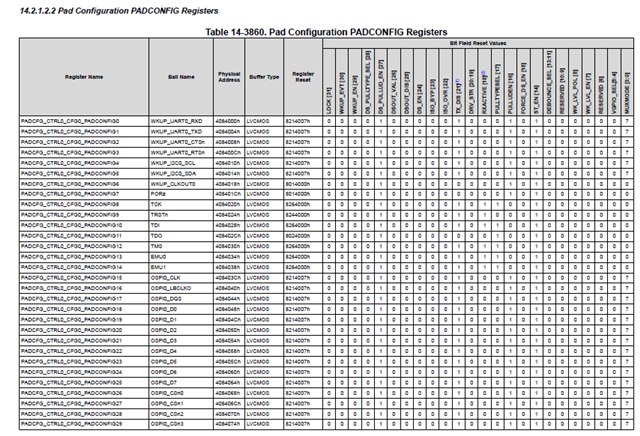

Hi TI Experts,
Could you please elaborate about PADCONFIG register bits and default configurations for PADCONFIG registers.
  • Hi Board designers
    Thank you for the interest.
    The FAQ is being updated.
    Please review the FAQ frequently for updates.
    Available device packages
    (+) [FAQ] AM625 / AM623 / AM620-Q1 / AM625-Q1 / AM625SIP / AM62Ax / AM62D-Q1 / AM62Px / AM62L Custom board hardware design - Available Device Packages - Processors forum - Processors - TI E2E support forums
    Example PADCONIG register bit description - AM62L
    Example PADCONIG register s default value summary - AM62L

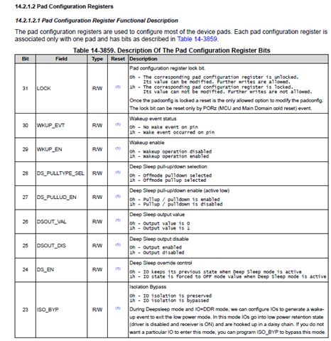

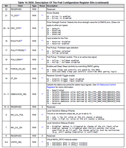

    Summary of the PADCONFIG register bits for AM62x (includes AM62A, AM62P, AM62L)
    PADCONFIG register description section reference
    14.2.1.2 Pad Configuration Registers
    14.2.1.2.1 Pad Configuration Register Functional Description
    Summary of the PADCONFIG register bits for AM62L
    Bit
    Field
    Description (bit function name)
    31
    LOCK
    Pad configuration register lock bit.
    0h - The corresponding pad configuration register is unlocked.
    Its value can be modified. Further writes are allowed.
    1h - The corresponding pad configuration register is locked.
    Its value can not be modified. Further writes are not allowed.
    Once the padconfig is locked a reset is the only allowed option to modify the padconfig.
    The lock bit can be reset only by PORz (MCU and Main Domain cold reset) event.
    30
    WKUP_EVT
    Wakeup event status
    29
    WKUP_EN
    Wakeup enable
    28
    DS_PULLTYPE_SEL
    Deep Sleep pull-up/down selection
    27
    DS_PULLUD_EN
    Deep Sleep pull-up/down enable (active low)
    26
    DSOUT_VAL
    Deep Sleep output value
    25
    DSOUT_DIS
    Deep Sleep output disable
    24
    DS_EN
    Deep Sleep override control
    23
    ISO_BYP
    Isolation Bypass
    22
    RESERVED
    Reserved
    21
    TX_DIS(3)
    Driver Disable
    0 - Driver is enabled
    1 - Driver is disabled
    20 - 19
    DRV_STR(4)
    Drive Strength Control. Selects the drive strength value for LVCMOS pins. (Does not apply to other pin types)
    18
    RXACTIVE(5)
    Input enable for the Pad
    0 - Receiver disabled
    1 - Receiver enabled
    17
    PULLTYPESEL
    Pad Pullup / Pulldown type selection
    0 - Pulldown selected
    1 - Pullup selected
    16
    PULLUDEN(2)
    Pad Pullup / Pulldown enable. This is an active low signal.
    0 - Pullup / Pulldown enabled
    1 - Pullup / Pulldown disabled
    15
    FORCE_DS_EN
    Enable pad Deep Sleep controls by overriding DMSC gating
    14
    ST_EN
    Receiver Schmitt Trigger enable
    0 - Schmitt trigger input disabled
    1 - Schmitt trigger input enabled
    13 - 11
    DEBOUNCE_SEL
    Selects the debounce period for select input signals. See I/O Debounce Control
    Registers for more information.
    10 - 9
    RESERVED
    Reserved
    8
    WK_LVL_POL
    Level Sensitive Wakeup Polarity
    7
    WK_LVL_EN
    Level Sensitive Wakeup Enable
    6
    RESERVED
    Reserved
    5-4
    VGPIO_SEL
    Virtual MAIN_GPIO instance select
    3 - 0
    MUXMODE
    Pad functional signal mux selection Field values (others are reserved):

    14
    ST_EN
    13 - 11
    DEBOUNCE_SEL
    10 - 9
    RESERVED
    Reserved
    8
    WK_LVL_POL
    7
    WK_LVL_EN
    6-4
    RESERVED
    Reserved
    3 - 0
    MUXMODE
    (1) See Pad Configuration Registers for reset values for Pad Configuration registers.
    (2) These bits do not apply to "I2C OD FS" buffer types as these IOs do not have internal pull registers.
    (3) To prevent unwanted glitches, software should disable the output driver by setting the TX_DIS bit before writing a new MUXMODE value. Once the new MUXMODE value is written, the TX_DIS bit can be reset in order to re-enable the pin driver.
    (4) Use of settings other than the reset value could invalidate datasheet timings.
    (5) The RXACTIVE bit must never be set without a valid logic state being sourced to the pin associated with the respective PADCONFIG register. This is very important since a floating input may damage the device.
    Many of the device pads support pad multiplexing. This means that their function can be independently chosen from two or more options. The selection of functions available on each pad is enumerated in table “Pin Multiplexing” of the device-specific Datasheet. The desired function is selected via the MUXMODE field of the associated pad configuration register
    PADCONFIG registers additional inputs
    (1) TX_DIS bit must be set before changing the MUXMODE value when the IO associated with a PADCONFIG register was previously configured to operate as an output. This is required
    to prevent a potential glitch propagating through the output buffer when the MUXMODE values is changed. A MUXMODE value change should be implemented with three PADCONFIG
    write operations, where the TX_DIS bit is set in the first write operation, the MUXMODE values is changed in the second write operation, and the TX_DIS bit is reset in the third write
    operation. This will disable the output buffer while the pin mux logic changes signal functions.
    (2) Use of settings other than the reset value could invalidate datasheet timings.
    (3) The RXACTIVE bit must never be set without a valid logic state being sourced to the pin associated with the respective PADCONFIG register. This is very important since a floating input
    Table 14-6172. Description Of The Pad Configuration Register Bits
    The table describes supported bit wise function for the 32-bit configuration register that can be referenced while configuring the PADCONFIG register for the specific functionality or use case (IO function)
    14.2.1.2.2 Pad Configuration PADCONFIG Registers
    The table below includes  PADCONFIG  Register Name & address, (includes padconfig registers that are not pinned out) and ball name (indicating one of the configurable function name) and default values for the 32 bits of all the supported PADCONFIG registers
    Table 14-6173. Pad Configuration PADCONFIG Registers

    The PADCFG_CTRL0_CFG0_PADCONFIG0 to PADCFG_CTRL0_CFG0_PADCONFIG150 registers control the
    signal multiplexing of modules in the device MAIN domain.
    The PADCFG_CTRL0_CFG0_PADCONFIG0 to PADCFG_CTRL0_CFG0_PADCONFIG33 registers control the
    signal multiplexing of modules in the device MCU domain.
