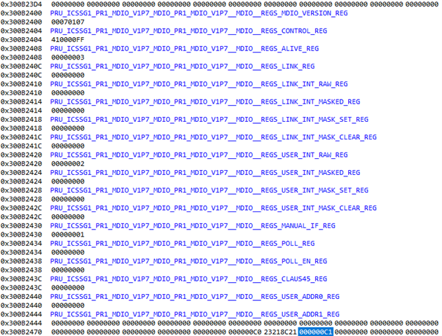

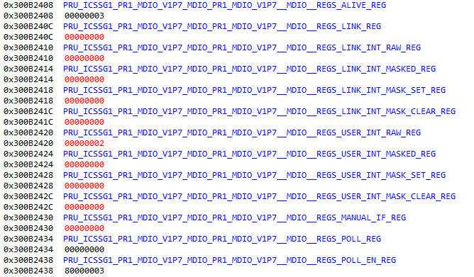

    Additionally, just to confirm, the MDIO link status is being observed at MDIO Link Register (offset: 0x30090E4C), right?
    0x30090E4C was empty, but I saw 0x300B240C instead.
    The value is 0x02, but what is actually connected is only 0x01 on the IN side.

    Thank you for the confirmation. So the issue seems to be Enhanced Link configuration.
    Maybe the link polarity is inversed such that before connecting the port, 0x300B240C was 0x03 and on connecting the IN port, it became 0x02 (bit0 reset). Or if the polarity is not inverted, then try configuring the PHY Address in Syscfg based on the link status in the MDIO Link Reg (that is, 1 for IN and 0 for OUT).

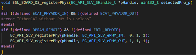

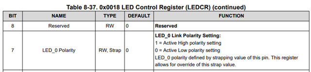

  • Hi Aaron,
    Since LEDCR(7)=1, ECAT_PHYPOLINVERT was set to TRUE.
    However, this did not work, so I rewrote EC_API_SLV_registerPhy() directly.
    As a result, the link on the In side was established and communication was possible, but the link on the Out side was no longer established.
    The settings for both PHYs are the same, so what should I check?

  • Hi Oyama,
    Please test with the latest EtherCAT firmware (with link detection enhancement done within firmware) shared to you and update us of the status.
    Also, can you provide the complete ICSS MDIO Memory dump (0x300B2400 to 0x300B248C) and also the PHY Register values, when both, the IN and OUT ports are connected to the AM243x device.
    Aaron

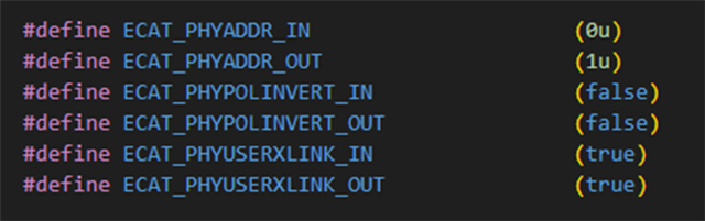

  • Hi Aaron,
    I applied the update and set ECAT_PHYPOLINVERT back to FALSE (the actual waveform was also active low) and the link and EtherCAT communication now works.
    In the Initial step, I have changed MDIO_POLL_EN_REG (0x300B2438) to 0.
    Best regard,
    Oyama
    Thank you for the confirmation. Can we mark this thread as 'Resolved'?

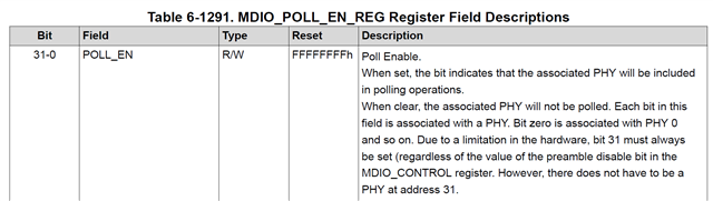

    As mentioned in the TRM, recommend to set bit31 in MDIO_POLL_EN_REG to take care of the HW limitation:
    Additionally, since "Enable MDIO Manual Mode" is checked in your application, you can also monitor for MDIO_ALIVE_REG and MDIO_LINK_REG at 0x30090E48 and 0x30090E4C, respectively.

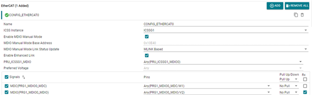

  • Hi Aaron,
    Is it recommended to enable polling in MDIO Manual Mode, In addition to Enhanced Link?
    MDIO Manual Mode a workaround for the errata mentioned in the documentation I shared in my previous reply and this workaround is independent of Enhanced Link. When MDIO Manual Mode is enabled, you can use the emulated register space for reading the link/alive status and writing/reading to the PHY Register space.
    The firmware loaded for the workaround will take care of the MDIO configuration based on Enhanced Link configuration from the application.
