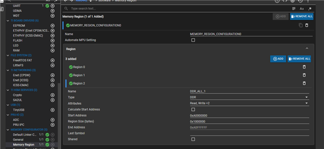

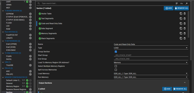

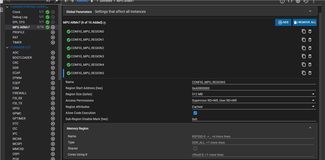

On our custom hardware based on AM6422 SoC we are trying to load application created for R5fss0-0 core based on "empty" template from CCS (Version: 20.2.0.12__1.8.0) into DDR memory, not MSRAM.
We have prepared below configuration in SysConfig (version 1.23.0) tool:

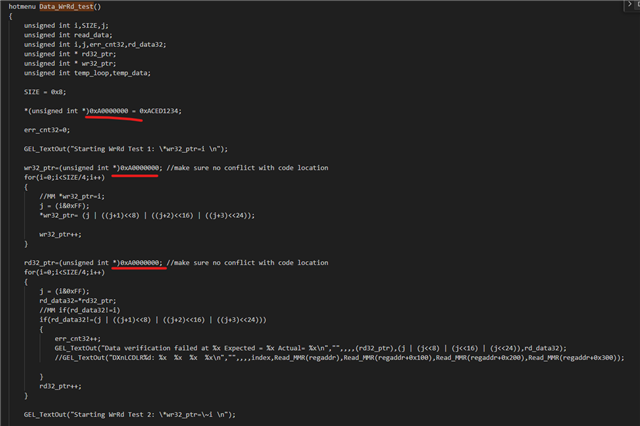

I tracked the gel file that is reporting this error (ccs/ccs_base/emulation/gel/AM64x/AM64_DDRS/AM64_DDRS_Confug.gel and found the function Data_WrRd_test()
which is printing this error. I replaces all the 0x8000000 address occurrences with the starting address of DDR memory region, but this still didn't help. Boot process on A53 core is stopped manually at u-boot shell so at this stage DDR memory is already initialized.

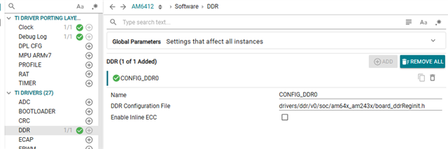

  • Data_WrRd_test() is just a test script that will not be executed unless the user initiates it.  Ensure you have added the DDRSS module,
    and added the DDR configuration file configured for the DDR on your board using the DDR Register Configuration Tool:   https://dev.ti.com/sysconfig/?product=Processor_DDR_Config&device=AM64x
    James
  • Hello James,
    Thanks for response. This error message I posted comes exactly from this GEL file. I do not even able to flash the application changing anything inside code won't help. DDR is already initialized by u-boot or SPL running at R5 core. Anyway I tried your approach but it didn't help.
    BR
    Jakub
  • I'm not sure why that GEL file would be executing if you already initialized the DDR.  If you have any kind of MMU enabled, that function won't work, it is just meant to be a very low level memory test.  Can you send the entire log in the CCS console window?
    James

  • In the third snapshot, you should a DDR region defined with a start address of 0xA0000000, end addr =0xA0FFFFFF.  But the file you are loading is trying to load to 0xA58000000, which is not in the defined region.  I think this may be why you are getting the error.
    James
