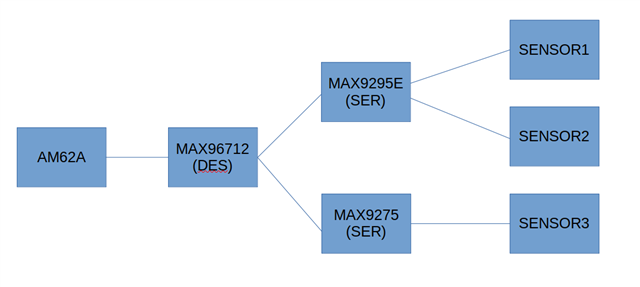

Currently, I am receiving 2 camera data via CSIRX as a virtual channel.
I created a video node via media-ctl.
However, when I stream one camera, it does not stream from the other camera.
After running it once, only one camera streams.
Are there any points to check?

  • Hi
    We have created a custom board that can be connected to the CSI PORT on the AM62A SK board.
    Two cameras are transmitted to one CSI port via SER/DES structure.

  • Hi
    We are using SER/DES (GMSL) from MAXIM company.
    We are connecting 2 cameras connected to SER to DES and transmitting them to AM62A via Virtual Channel.
  • Hi Kim,
    Is it possible to run video3 and video4 independently through virtua channels?
    This should be possible as long as your sensor driver and the serdes manage the virtual channels correctly.
    The "media-ctl -p" log looks fine to me, but your yavta log seems to show the following for both video3 and video4:
    max96712 4-0029: Mapping sink 0/1 to output VC 1, type 2,30
    Shouldn't the VC number be different?

    Which SDK version are you using? Do you have a sensor with 3 virtual channels or do you have 3 sensors?
    How did you set up the media device topology? Can you try not to use DMA context 0? Another word, do not use  "30102000.ticsi2rx context 0" and start from  "30102000.ticsi2rx context 1".
    Jianzhong
  • Hi
    I am using SDK version 10.01.00.05.
    I am using a total of 3 sensors.
    The above symptoms are the results of testing with 2 sensors.
    I plan to use 3 sensors in the future.
    I referred to the setup_scripts.sh file ov2312 settings for the media device topology.

  • Hi
    The overall structure is as follows.
    The media-ctl -p log you provided shows that each of the two ser devices has one sensor connected.
    Is this correct?
    Kim
  • Hi Kim,
    Thanks for sharing the diagram. You probably want to check with the serdes vendor on how the serdes manage and communicate with the sensors.
    Jianzhong
  • Hi
    e2e.ti.com/.../sk-am62a-lp-problems-with-multi-camera-connection
    The current situation seems similar to issue #2 in the link above.
    Is this correct?
    The answer says it will be resolved in version 10.0, but is this still not resolved?
    Kim
  • Hi Kim,
    The issue has been fixed, but skipping DMA context 0 can work around that issue.
    Jianzhong

    Kim
  • Hello Kim,
    As I said earlier, please check with the serdes vendor on how the serdes manage and communicate with the sensors.
    Jianzhong
  • Hi
    This issue was resolved after upgrading to 11.01.07.05.
    Kim
