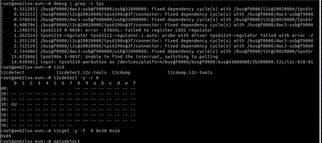

We are currently working with the TPS65214 PMIC on our custom AM62L3-based board. The PMIC is powered with a 5V input, and we are using GPIO0 (pin number 105) as the interrupt line connected to the SoC.
While configuring the PMIC interrupt, I initially tried various IRQ trigger types, but encountered the following issues:
  • Using trigger types like IRQ_TYPE_LEVEL_HIGH or IRQ_TYPE_EDGE_RISING led to errors during IRQ request.
  • However, setting the interrupt type to IRQ_TYPE_EDGE_FALLING resolved the IRQ request error.
That said, once the PMIC driver starts probing with IRQ_TYPE_EDGE_FALLING, I encounter different probing errors related to other interfaces that are not seen when the PMIC is disabled. Could you please clarify why this behavior might occur? Is there any known issue or specific requirement when configuring TPS65214 interrupts on AM62L3?
Additionally, I observed the following during boot:

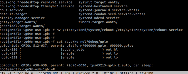

  • Normally, our GPIO pin (interrupt pin 105) belongs to the main_gpio0 controller.
  • However, after probing the PMIC, the system detects one additional gpiochip (gpiochip1), which corresponds to the PMIC GPIOs.
Is this behavior expected? Does the TPS65214 PMIC driver register its own gpiochip for PMIC GPIOs by default, even if the IRQ line is connected to the SoC's main GPIO controller?
FYR:

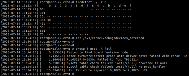

  • What could be the reason for probe failing of PMIC in the AM62L3 EVM board.
  • Hi ,
    Regarding the PMIC Failing in EVM board , i made the dts compatible to "ti,tps65215" and i have observed the following changes.Still i get the error prints from PMIC in the EVM board.
    What could be the reason for that?
    Could you please let me know is there any missing configuration in PMIC in my custom dts which i have shared above.Becuase my SW reboot for 12 hours test fails as i have already put a different thread for that and came to know the rootcause for that is because of the PMIC Configuration.
