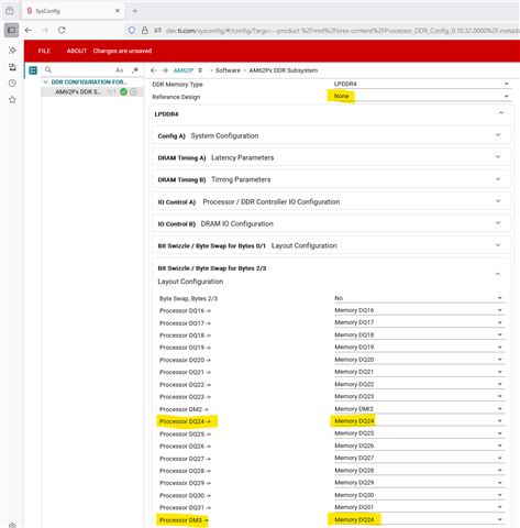

When I open this tool, the Reference Design "none" is selected.
Unfolding "Bit Swizzle / Byte Swap for Bytes 2/3", I see that "Processor DM3 ->" is mapped to "Memory DQ24". I am puzzled as seemingly two Processor Pins(?) are mapped to the same Memory Pin(?).
I would except DM3 to be mapped to DM3. Is there are specific reason why my expectation is incorrect?
  • Hi Michael, that is a bug in the tool.  Will get that fixed in the next release.  Thanks for pointing that out.
    The AM62P EVM (SK-AM62P-LP) actually has some of those signals swapped, so if you choose the EVM in the  Reference Design dropdown, you will see those bit swizzles represented.
