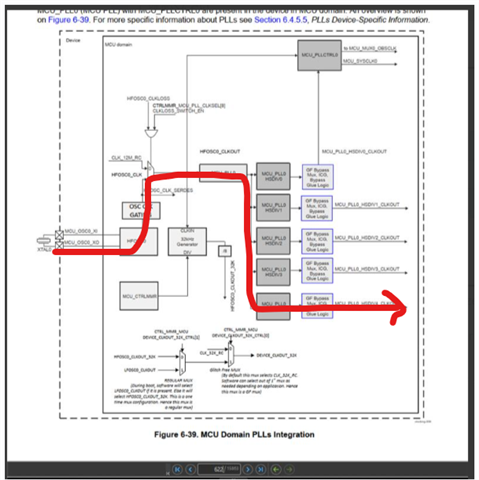

  • Hi Ito,
    I cannot find PLL drift to be characterized in the datasheet. I think that if MCU0_PLL was selected during chip design, then it should cover the CAN specific requirements.
    I think all the requirements in 4) are related to external components like system clock crystal / external system clock source, or external MCAN clock source like below:
    Stan
