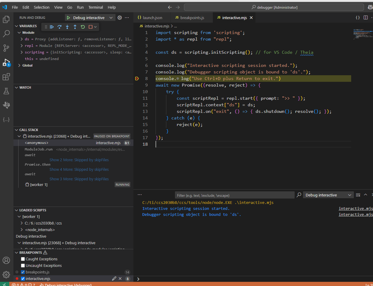

  • I didn't realize you were trying to debug it.
    Have you seen the section on debugging a script in the user's guide?
    https://software-dl.ti.com/ccs/esd/documents/users_guide_ccs/ccs_debug-scripting.html#debugging-a-script
    However, the example there is for a standard *.js file. For a *.mjs file I needed to make the following tweaks so that my interactive.mjs file looks like:
    import scripting from 'scripting';
    import * as repl from "repl";
    const ds = scripting.initScripting(); // for VS Code / Theia
    console.log("Interactive scripting session started.");
    console.log("Debugger scripting object is bound to 'ds'.");
    console.log("Use Ctrl+D plus Return to exit.")
    await new Promise((resolve, reject) => {
    	try {
    		const scriptRepl = repl.start({ prompt: ">> " });
    		scriptRepl.context["ds"] = ds;
    		scriptRepl.on("exit", () => { ds.shutdown(); resolve(); });
    	} catch (e) {
    		reject(e);
    I was then able to debug it with VS Code.

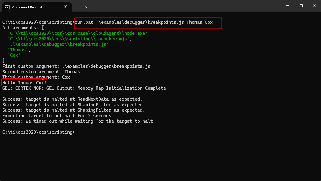

  • DSS had documentation on the parameters that should be passed to DSS.bat to execute a JavaScript file. I can find no description of the parameters that can be passed to run.bat in the CCS 20 scripting environment. Can you point me to documentation on that?
    It is not a DSS/CCScripting thing. It is simply passing arguments to node.js. The dss.bat allowed for arguments to be pass to the script. The run.bat would need to be updated to support extra parameters to mode.
    @"%~dp0\..\ccs_base\cloudagent\node.exe" "%~dp0\launcher.mjs" %1 %2 %3 %4 %5 %6 %7 %8 %9
    That would accept 9 arguments like dss.bat did.
    Then in your js script you can get the arguments like:
    const args = process.argv;
    Here is an example. I simply added the below lines to the top of the example script that comes with CCS.
     // yourScript.js
    console.log("All arguments:", args);
    console.log("First custom argument:", args[2]); // file name
    console.log("Second custom argument:", args[3]); // first argument passed to the script
    console.log("Third custom argument:", args[4]); // second argument passed to the script
    console.log("Hello " + args[3] + " " + args[4] + "!");
    And then ran it like:

    You only need this to debug in VS Code. You need to remove it if running from CLI.
  • The run.bat would need to be updated to support extra parameters to mode.
    I filed a ticket for this. Tracking link: https://sir.ext.ti.com/jira/browse/EXT_EP-12857
  • Your sample code to read and print arguments passed to run.bat is very instructive and useful. I have tried, as you did, adding the argument print logic to the front of interactive.mjs. and breakpoint.mjs.
    I am currently still stuck on the problem mentioned at the end of my last reply. Whether I run from the VSCode debugger or a CLI, whether or not I activate the line
    I get the error message:
    Error [ERR_MODULE_NOT_FOUND]: Cannot find package 'scripting' imported from <absolute_path>\interactive.mjs.
    Another anomaly which may be a clue: Although the first two active source code lines in each of the modified example scripts are the same as in your inteactive.mjs, i.e.
    interactive.mjs is displayed in VSCode editor panel with the first line dimmed, indicating an error, and in the editor panel display of breakpoint.mjs the 2nd line is dimmed indicating an error.
    If either script is run from CLI, the error message above is preceded by:
    node:internal/errors:490
    ErrorCaptureStackTrace(err);
  • I'm not sure why you are getting this error. You are calling the script with run.bat, correct? That should be setting up the scripting environment.

  • Ki - I compared your original interactive.mjs vs. my copy. I realized that yours does NOT contain the source line
    I removed that line from my copy. Now both your source and mine when executed from run.bat show:
    <absolute_path> C:\TI\ccs2020\ccs\scripting\run.bat interactive.mjs
    >> file:///<absolute_path>/JVScript/interactive.mjs:9
    ReferenceError: ds is not defined
    at file:///<absolute_path>/JVScript/interactive.mjs:9:30
    at new Promise (<anonymous>)
    at file:///<absolute_path>/JVScript/interactive.mjs:6:7
    at ModuleJob.run (node:internal/modules/esm/module_job:194:25)
    Node.js v18.16.0
    You had said that the source code line "const ds = scripting.initScripting(); // for VS Code / Theia" is only needed if running from the VSCode debugger. So I had commented it out. When I re-enabled that line for command line use, execution was normal.
    (To exit, press Ctrl+C again or Ctrl+D or type .exit)
    With that change in my application script, that script also starts to execute without a fault. Thanks very much for your help and patience!
