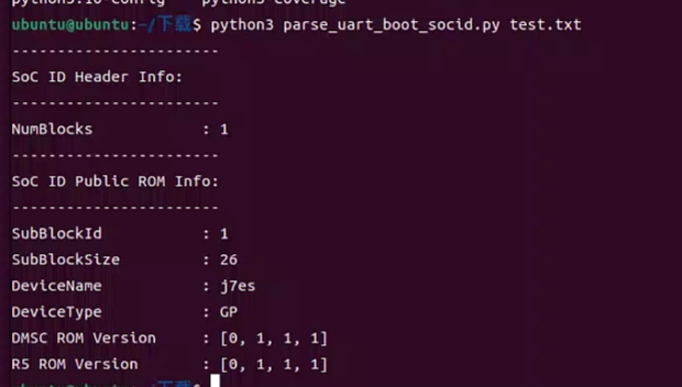

    Can you please share the device type you are using?  Is it GP, HS-SE?
    If it is HS-SE by default, debug prot is not enabled, so unlock JTAG before use.
    Please refer to FAQs:
    To check device type: [FAQ] TDA4VM: How to check device type (GP/HS-FS/HS-SE) ?
    To unlock JTAG: [FAQ] J721S2XSOMXEVM: How to unlock the JTAG using TISCI API ?

    The captured serial port information shows the device type as GP. Does this type still require unlocking the JATG?
    No, for the GP device, you need to unlock JTAG.

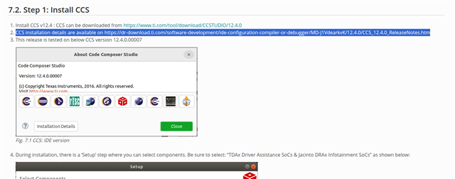

    Have you installed the drivers? If not, please follow the release notes, as pointed out in the RTOS SDK documentation.

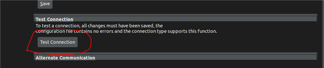

    Can you also check by running the test connection from CCS?

    When i  running the test connection from CCS,
    this is the error as below.

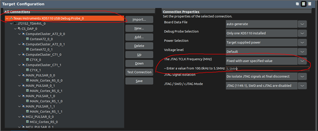

    Can you please check by lowering the JTAG clock?
    If the issue persists, could you please check with your hardware team regarding signaling?

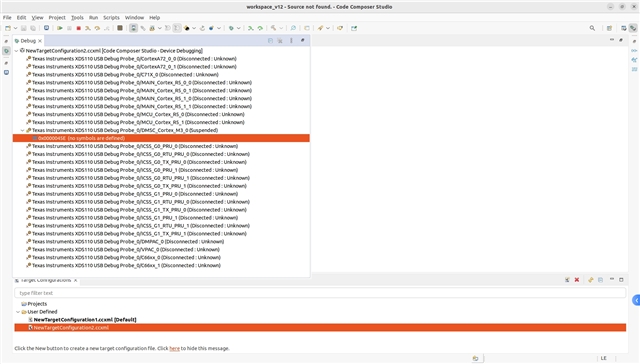

  • I have verified that DMSC_M3 can successfully connect, but C66xx_ fails to connect. Does connecting to the DSP SoC require additional configuration?
    What was the issue earlier, as you were unable to connect to DMSC as well?
    DMSC can be accessed by default without loading the JEL file, in order to access any other cores, you can only do so after loading the JEL file.

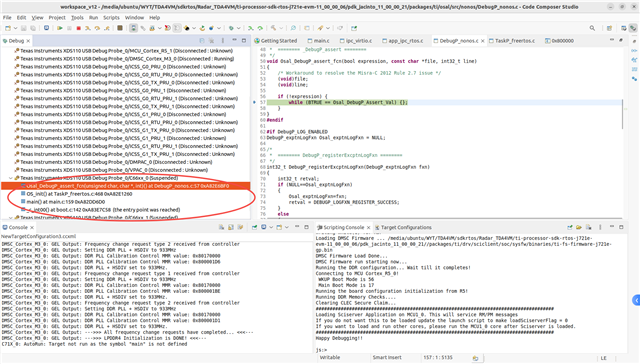

  • Now I can successfully connect to the core and am currently developing on C66. The vx_app_rtos_linux_c6x_1.out has been loaded, but it fails to run properly and gets stuck in the OS_init() function. I would like to ask: Can the C66 core run independently? Does it need to work in conjunction with other MCUs?
    It depends upon the application you are running on C6x. It can run independently no dependence on other cores, It will only depends upon MCU1_0 core for resources and power configuration of any module.
