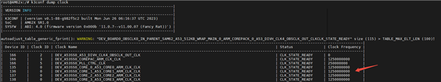

I would like to know two questions about the factory frequency of the CPU
1. The default CPU frequency now is 1250000000 Hz, but the maximum supported frequency for am6234 is 1.4GHz, as follows:
Why is the default frequency of SDK not set to 1.4GHz ?
2. If I want to change the CPU frequency to 1.4Ghz, how do I make the change?

    The frequency is hard-coded in U-Boot code, only because the max freq for 0.75v VDD_CORE is 1.25HGz. We don't want the processor to run at 1.4GHz if the VDD_CORE is 0.75v. The default frequency can always be changed in U-Boot code to set to the value you want.

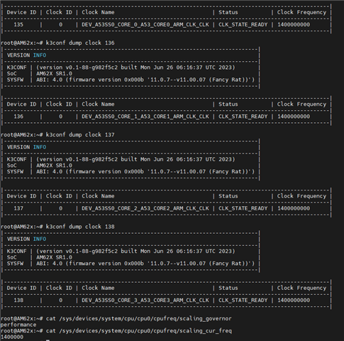

  • Have you enabled cpufreq in kernel config?
    Yes, after making the following modifications, the frequency of the system after startup is 1.4GHz
    diff --git a/arch/arm64/boot/dts/ti/k3-am62x-sk.dts b/arch/arm64/boot/dts/ti/k3-am62x-sk.dts
    index b7ee73d..33ca38e 100755
    --- a/arch/arm64/boot/dts/ti/k3-am62x-sk.dts
    +++ b/arch/arm64/boot/dts/ti/k3-am62x-sk.dts
    @@ -188,3 +188,33 @@
     &fss {
            bootph-all;
    +&a53_opp_table {
    +       opp-200000000 {
    +               /delete-property/ opp-supported-hw;
    +       opp-400000000 {
    +       opp-600000000 {
    +       opp-800000000 {
    +       opp-1000000000 {
    +       opp-1250000000 {
    +       opp-1400000000 {
    \ No newline at end of file
    diff --git a/arch/arm64/configs/defconfig b/arch/arm64/configs/defconfig
    index af2b8e0..94cbeeb 100755
    --- a/arch/arm64/configs/defconfig
    +++ b/arch/arm64/configs/defconfig
    @@ -525,7 +525,30 @@ CONFIG_ARCH_SUSPEND_POSSIBLE=y
     # CPU Frequency scaling
    -# CONFIG_CPU_FREQ is not set
    +CONFIG_CPU_FREQ=y
    +CONFIG_CPU_FREQ_GOV_ATTR_SET=y
    +CONFIG_CPU_FREQ_GOV_COMMON=y
    +CONFIG_CPU_FREQ_STAT=y
    +CONFIG_CPU_FREQ_DEFAULT_GOV_PERFORMANCE=y
    +# CONFIG_CPU_FREQ_DEFAULT_GOV_POWERSAVE is not set
    +# CONFIG_CPU_FREQ_DEFAULT_GOV_USERSPACE is not set
    +# CONFIG_CPU_FREQ_DEFAULT_GOV_ONDEMAND is not set
    +# CONFIG_CPU_FREQ_DEFAULT_GOV_CONSERVATIVE is not set
    +# CONFIG_CPU_FREQ_DEFAULT_GOV_SCHEDUTIL is not set
    +CONFIG_CPU_FREQ_GOV_PERFORMANCE=y
    +CONFIG_CPU_FREQ_GOV_POWERSAVE=y
    +CONFIG_CPU_FREQ_GOV_USERSPACE=y
    +CONFIG_CPU_FREQ_GOV_ONDEMAND=y
    +CONFIG_CPU_FREQ_GOV_CONSERVATIVE=y
    +CONFIG_CPU_FREQ_GOV_SCHEDUTIL=y
    +# CPU frequency scaling drivers
    +CONFIG_CPUFREQ_DT=m
    +CONFIG_CPUFREQ_DT_PLATDEV=y
    +# CONFIG_ARM_SCMI_CPUFREQ is not set
    +CONFIG_ARM_TI_CPUFREQ=y
     # end of CPU Frequency scaling
     # end of CPU Power Management

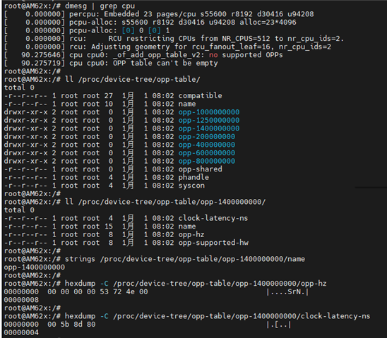

    But if I don't delete the "opp-supported-hw" attribute in the device tree, there will be the following error message
    By analyzing the following source code under the kernel, it can be known that the setting of "opp-supported-hw" is related to register 0x43000018
    Documentation/devicetree/bindings/opp/opp-v2-base.yaml
    drivers/cpufreq/ti-cpufreq.c
    The specific model of the chip we are currently using is AM6232ATCGHAALW, FCCSP-425, TI.
    The value of register 0x43000018 in Linux as follows
    My first question is, if we don't delete the opp-supported-hw in the device tree, how can we modify it to correctly configure the cpufreq driver so that the CPU frequency is 1.4Ghz when the system starts up?
    [    0.996124] cpu cpu0: _of_add_opp_table_v2: no supported OPPs
    [    0.996143] cpu cpu0: OPP table can't be empty
    [    0.996215] cpu cpu0: _of_add_opp_table_v2: no supported OPPs
    [    0.996221] cpu cpu0: OPP table can't be empty
