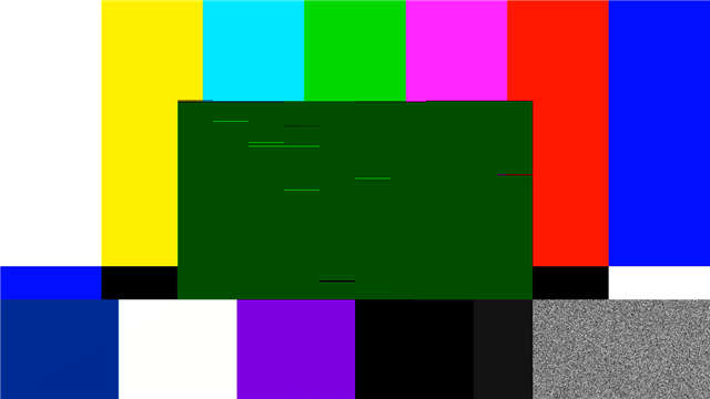

We are using edgeai-gst-plugins in our GStreamer pipeline with OpenVX and v4l2h265enc. We noticed image corruption when v4l2h265enc uses dma-buf import. Our "simplified" pipeline:
gst-launch-1.0 videotestsrc pattern=smpte num-buffers=30  ! video/x-raw, format=NV12, width=1920, height=1080 , framerate=30/1 ! tiovxmultiscaler  !  video/x-raw, format=NV12, width=1280, height=720, framerate=30/1   ! OUR_CUSTOM_ELEMENT ! tiovxmemalloc ! video/x-raw,stride-y-align=32 ! v4l2h265enc output-io-mode=5 ! h265parse ! mp4mux ! filesink location=/tmp/out.mp4 sync=false -v
With this pipeline, we see image corruption like shown below:
The corruption pattern is not consistent and changes from frame to frame. It looks like a cache coherency issue. However, the pipeline that doesn't use dma-buf import (output-io-mode=0) works without problems. But this causes video frame copying, which we need to avoid for performance reasons.
gst-launch-1.0 videotestsrc pattern=smpte num-buffers=30  ! video/x-raw, format=NV12, width=1920, height=1080 , framerate=30/1 ! tiovxmultiscaler  !  video/x-raw, format=NV12, width=1280, height=720, framerate=30/1   ! OUR_CUSTOM_ELEMENT ! tiovxmemalloc ! video/x-raw,stride-y-align=32 ! v4l2h265enc output-io-mode=0 ! h265parse ! mp4mux ! filesink location=/tmp/out.mp4 sync=false -v
OUR_CUSTOM_ELEMENT: Our custom GStreamer element is very simple in this case. It just gets the vx_image from the buffer, maps it, sets the content, and unmaps it. Below is example code that shows the corruption. In both working and non-working cases, our custom element is the same. The corruption only happens with v4l2h265enc output-io-mode=5.

Could you please look into this and help fix the issue? Are there any interoperability issues? Is there anything we missed here to keep tiovx and dma buf consistent
