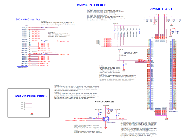

There are different pull up values recommended on different documents for MMC0(eMMC) DAT0 and CMD lines.
sprad21h and sprado3a suggest 10kΩ or 47kΩ
whereas
SK-AM62B-P1 schematic shows 49.9
Which should they follow?
