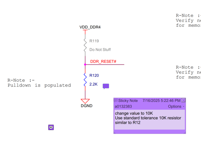

Hi Team,
There are different pull up values recommended on different documents for DDR(DDRSS) DDR_RSTN lines.
sprad21h and sprado3a suggest 10kΩ
whereas
SK-AM62B-P1 schematic shows 2.2
Which should they follow?
Mari Tsunoda
  • Hi Mari,
    please have your customer refer to Proc142A_Schematic_Revision_Readme.pdf in the design package for the board.  These have updated notes and addresses errors in the original EVM schematics.  It mentions the resistor should be changed to 10K pull down, no pull up necessary
    James
