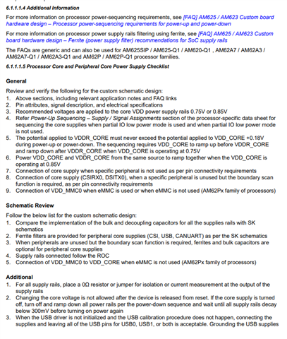

In the schematic checklist documents sprad21h and sprado3a, it lists general and additional recommendations.
What is the difference in nuance of general vs. additional? Is general recommendation a MUST whereas additional is a nice to have?
Mari Tsunoda
  • Hello Mari Tsunoda
    Thank you for the query.
    You said it right.
    Additional section adds some details to the general recommendation section recommendations.
    This is mostly for FYI and sometime can have similar content like general recommendations with additional data.
