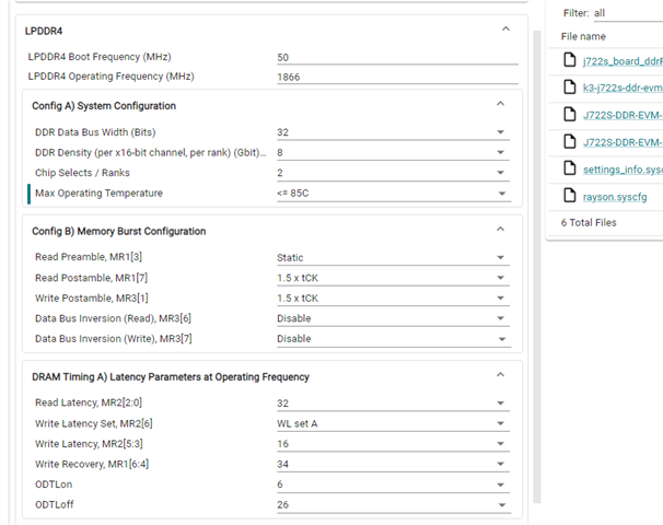

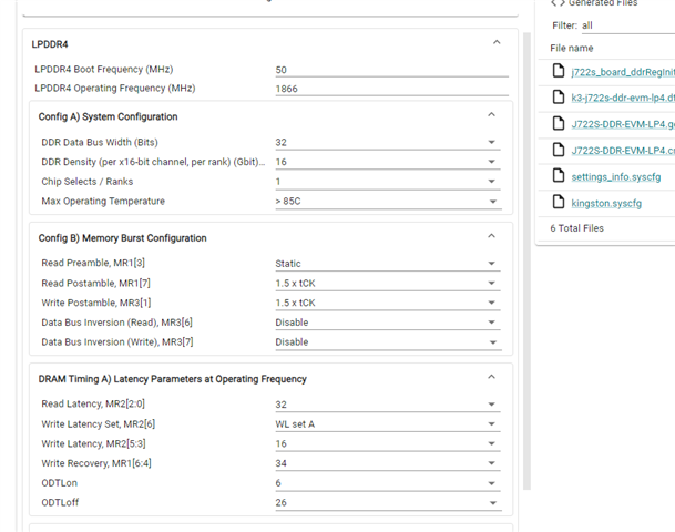

    Sorry for the confusion. We produced two of the our custom AM67A board. But, for the experiment, we installed different DDRs to boards. (So, the boards are the same except for the DDR.)
    The first board has a 4GB Rayson DDR.
    The second board has a 4GB Kingston DDR.
    Are you using the same DDR register configuration for both? If so, that would definitely be an issue for whichever memory has the incorrect configuration.
    You're right. I misled you. We already use two different configurations for the this two DDRs:
    Rayson:

    Kingston:
    LPDDR4 Boot Frequency (MHz) : 50
    LPDDR4 Operating Frequency (MHz) : 1866
    DDR Data Bus Width (Bits) : 32
    DDR Density (per x16-bit channel, per rank)(Gbit) : 16
    Chip Selects / Ranks : 1
    Max Operating Temperature : > 85C
    I don't know how to send you sysconfig file that includes all the configurations. These are screenshots:
    For Rayson:
    For Kingston:

    If so, I would suggest building more boards to give insight as to whether this may be a systematic issue or unique to the one failing board.
    You could also replace the Rayson memory with a Kingston memory to see if that resolves the issue, and then put the Rayson memory back on the board to confirm the original issue still exists. This would also give insight as to whether the problem is unique to the Rayson memory. However, I would suggest building additional boards first as removing / replacing the memory may start to wear out the PCB pads.
    Kevin
  • I understand your approach. Thanks for the advices. There are a lot of new boards being produced right now, already.
    But, is there a way(tools, scripts?) we can test the DDR memories before the new boards arrives? We tried it with memtest tool, but I'm not sure if it tested all the DDR addresses.
  • If you able to get to a linux prompt, you should run memtester to test the integrity of your DDR interface.
    If you can't get to a linux prompt, you can add the patch described here: https://e2e.ti.com/support/processors-group/processors/f/processors-forum/1358039/faq-board-bring-up-tips-for-sitara-devices-am64x-am243x-am62x-am62l-am62ax-am62d-q1-am62px#:~:text=Running%20memtester%20(DDR%20memory%20test)%20from%20R5
    which will add memtester to R5 code and it will run immediately after DDR initializes.
    Initially you can run it at room temp overnight to see if you get any errors.  Ideally, you should eventually run it across your operating temperature to ensure the robustness of your design and DDR configuration.  If you don't get any errors, you can be pretty confident that your are not dealing with any DDR errors, and you can focus on possible software problems.
    James
  •  This is the tooI needed. Thank you so much.
  • Hello JJD,
    Is it generally necessary to exclude reserved memory addresses while using memtester? Because, normally I was running memtest at u-boot terminal avoiding reserved memory adresses.
    Does this patch access all DDR addresses, including reserved memory?
    I'm asking because I don't know if I should remove the reserved-memory fields in u-boot DTS.
    And, does the patch work for 4GB DDR?
    Because the upper and lower 2GB are not contiguous at AM67A. I see that AM625-SK has 2GB DDR.
  • Memtester isn't intended to test memory cells or test the full DDR capacity.  It is intended to perform stress testing on the interface which will help identify possible signal integrity issues.  Thus is it not necessary to change anything about the memory map of the device.  Memtester patch will allocate 32MB of data to run the tests.
    James
