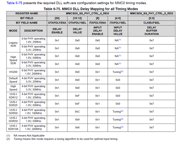

Is DDR Mode (4-bit, 8-bit) at up to 50 MHz supported? Based on the table below, it seems the fastest we can do at 3.3V is 52MHz at 8 bits.
Please advise.
I have asked for clarity as to his goals.  I am assuming it is the fastest speeds possible.  Would that be the HS200 8bit at 200 MHz rather than the 3.3v @ 50MHz he notes above?

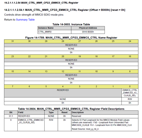

    1. I noticed that there don’t seem to be any bits to change the drive strength of the MMC pins. They all seem to be reserved:

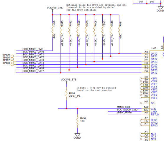

    2. Also, the EVB schematic has a few notes about the eMMC0 interface and its internal pulls.
    • Has TI done enough testing to confirm that external pull-ups are not needed?
    • What about R491 (50K pull-up on the clock signal)? Does TI have test results to show that it is needed or not needed?
    • What about R499 (10K pull-down on the clock signal)? Is that needed?
  • 52MHz is not mentioned anywhere in the table you inserted. We only support up to 50MHz for the modes defined to operate at 52MHz in the eMMC standard due to the AM62Lx PLL operating frequencies and internal clock dividers. The eMMC standard doesn't allow 3.3V signaling for any mode that operates over 52MHz. So, HS200 is limited to 1.8V operation.
    The table you inserted will be updated in the next revision of the datasheet. We will be adding a new row for "High Speed DDR" that includes operation at 1.8V or 3.3V, but the frequency will be limited to 40MHz in this mode. We are also removing the last three rows in the table. This is being done because the AM62Lx MMC0 port only supports eMMC and embedded SDIO. It does not support SD Cards and embedded SDIO devices only operate up to UHS-I SDR25.
    The SDIO buffer type implemented on MMC0 signal functions have a fixed 40-ohm source impedance.
    The schematic snapshot you inserted does not appear to be correct for AM62Lx. The recommended external pulls for the AM62Lx MMC0 signals when connected to an eMMC device is a pull-down on CLK, a pull-up on CMD, and a pull-up on DAT0. I recommend using standard tolerance 47k-ohm resistors. These pulls are required to hold a valid logic state on the unprotected eMMC inputs until software initializes the MMCSD0 host controller and the associated IOs since the AM62Lx IOs associated with these signals are turned off by default. The eMMC standard requires all eMMC device to provide internal protection on its DAT[7:1] inputs by turning on internal pull-up resistors by default. The eMMC device will turn off its internal pull-ups on DAT[7:1] when entering 8-bit mode or will turn off its internal pull-ups on DAT[3:1] when entering 4-bit mode. The host is expected to turn on its internal pull-ups on these signals when the eMMC devices turns off its internal pull-ups on these signals. Therefore, external pull-up resistors should not be required for DAT[7:1]. However, we recently found the TI software was not turning on the host pull-ups on these signals, which means these signals were floating when not driven. I assume this will be fixed in a new revision of the software.

     Regarding the schematics picture provided above:
    The schematics posted in the E2E seems to be customer schematics.
    Seems like customer reused the schematics of the SK and did not reconfigure the DNIs.
    We have this note in the Hardware design considerations document:
    When the SK design (schematic) is reused, the DNI settings for all the components can reset. Make sure the DNIs are reconfigured (populating DNIs can affect the functionality).

    In case customer is reusing the AM62L EVM schematics, there are a few DNI components in the clock, reset, OSPI, SD card, Ethernet USB and other sections.
    The recommendation is for the customer to verify the DNIs in the BOM or the SK EVM PDF schematics and make the required updates to DNI.
