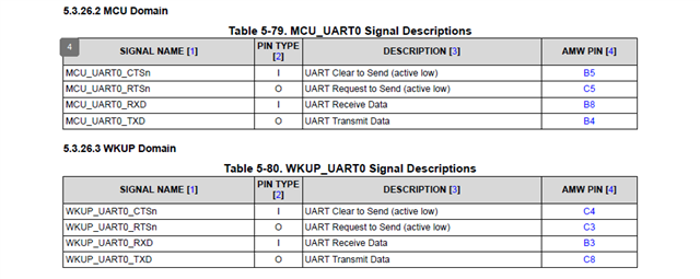

on the evaluation board J722SXH01EVM, I see the below UART ports of J722S are connected to FTDI FT4232HL (beside RTSN/CTSN for each):
A) F19/F20 (UART0_TXD/RXD)
B) C8/B3 (WKUP_UART0_TXD/RXD)
C) B4/B8 (MCU_UART0_TXD/RXD)
D) H27/J27 (SOC_UART5_TXD/RXD)
Could you suggest which are needed for designing a new board and do software development on it.
(UART to USB bridge like the FTDI chip won't be present on the board to be designed, and we might want to debug R5 tispl.bin-uboot as well).
The usecases inlude both "boot from UART and flash firmware" and "MCU R5F application runtime debug UART prints".
1. A) + B)
2. A) + B) + C)
3. A) only (re-route output to this by firmware change)
4. all of A) B) C) D) (I don't think D is quite needed though)
Less number of pins preferred if possible.

  • SPRSP96A datasheet: (comment in device tree k3-j722s-evm.dts mentions other balls but address register values do match the below)
    additionally:
    $ grep -n UART0_.XD mcu_plus_sdk_j722s_11_00_00_12/source/drivers/pinmux/j722s/pinmux.h
    138:    PIN_UART0_TXD            = 0x01CC,
    139:    PIN_UART0_RXD            = 0x01C8,
    302:    PIN_MCU_UART0_RXD                = 0x0014,
    303:    PIN_MCU_UART0_TXD                = 0x0018,
    308:    PIN_WKUP_UART0_RXD               = 0x0024,
    309:    PIN_WKUP_UART0_TXD               = 0x0028,
    Using the image below from the J722S EVM, by default UART0 is used for flashing and booting via UART. MCU_UART is used for logs from MCU R5F core and WKUP_UART is used for logs from WKUP_UART.
    If we went for option 3. would it complicate development of boot code (R5 side uboot) or MCU R5F application uart debug?
    All of the UARTs are configurable, however, I would say it is easier to use another UART for MCU R5F application debug rather than using another UART for developing R5 boot. You are also able to adjust which UART is used for UART flashing but it is slightly more complicated than changing a UART for simply debugging.
