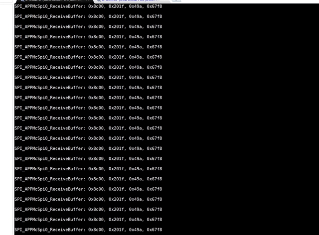

During SPI debugging, we observed inconsistent data between the actual MISO signal and the received data printed by the system. The problem was reproduced in TI SDK's reference example:
mcusw/mcal_drv/mcal/examples/Spi.
Observed Behavior
  1. Physical MISO Signal (captured via logic analyzer)
​        2. Printed Data​ (from system log):
The SPI reception data is now printed correctly after applying the modifications depicted in the following figure to Spi_Mcspi.c.
Attached is my code implementation. Could TI experts review whether there are issues in the SPI software configuration?

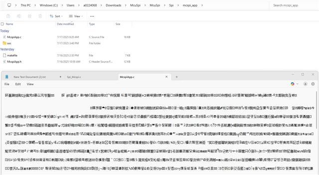

    Which SDK version is this ?
     McuSpi.zip
    None of your files are opening at my end
    Not able to open this image as well here.
    Tarun Mukesh
  • Hi bingxian,
        The code is encrypted! Please check. Thanks.
    Linjun
  • Dear Bingxian,
    I still can not see the code.
    would you please double check that and upload plain code files again?
    thanks a lot!

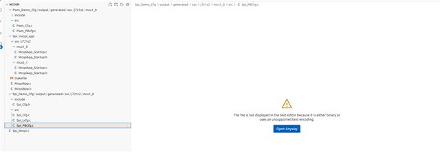

    Dear Bingxian,
    Yes i cannot still see the code.
    Tarun Mukesh
  • Dear Tarun.
    got new compressed package from customer.
    checked that and the source code can be read.
    6622.McuSpi.rar
    thanks a lot!
    yong
  • 6622.McuSpi.rar

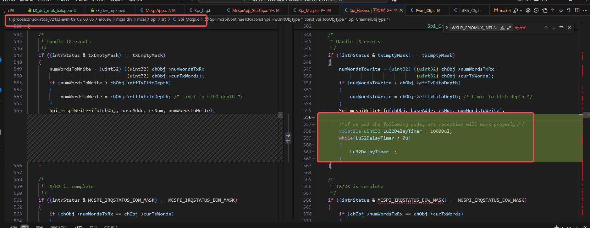

  • Dear Mr. Lu,
        I checked the source code and I don't think we need to add delay there to wait. Could you please share more detail info of the context. Such as the test case and the binary with debug info.  Thanks.
    Linjun

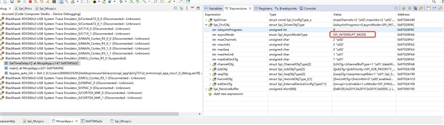

  • Dear Mr.Lu,
       Please check the SpiDriver  configure info firstly. especially the extDevCfg.
        Add I checked the Spi_DrvObj  info ,now is asyncMode = SPI_POLLING_MODE . Could you please check which mode should meet the current scenario.
        Thanks.
    Linjun

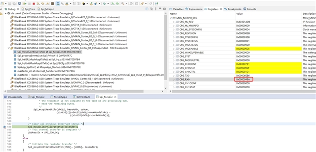

  • Hi Linjun
     Spi_DrvObj  info ,now is asyncMode = SPI_INTERRUPT_MODE
    when break in Spi_mcspiContinueTxRx with intr status MCSPI_IRQSTATUS_EOW_MASK, the MCSPI_RX_0 register data is not the last word in MISO
    I did couple of changes in Spi_Mcspi.c file , Can you compare with SDK 9.2 and see this gets fixed ?

    Tarun Mukesh
  • Hi
    It gets fixed and works. Now there are problems after starting the SOC, we are currently checking. If there are any issues, we will provide feedback
  • Dear Wenbin.
    may I ask your help to upload the patch on your side in this ticket after you make sure the issue fixed?
    thanks a lot!
    yong
  • This is a mcal  bug before sdk10.0 when use FIFO mode,  it was fixed on SDK11.

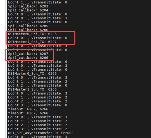

  • Hi yong
    We have observed that the SPI interrupt experiences a delay of approximately 60ms when the SOC loads the DSP image. This delay is measured from the start of Spi_AsyncTransmit until the end of McuMcspiSeqEndNotification.
    This issue only occurs when U-Boot loads either image; there is no problem if U-Boot loads neither image. Loading just one image is sufficient to trigger the interrupt delay.
    We attempted modifying the C7x image content to make it invalid, but this approach was unsuccessful.
    The difference between channel 0 and channel 1 lies in the fact that the CS pins used are CS0 and CS1 respectively, and the SPI devices are both MCU_MCSPI_0
    Sorry i did not understand the issue clearly. What does uboot has to do some thing with SPI driver ? You should disable usage of SPI instances from uboot if you are using it from MCAL.
    What SPI pins are you using on which core ? The changes i gave introduced this issue ?

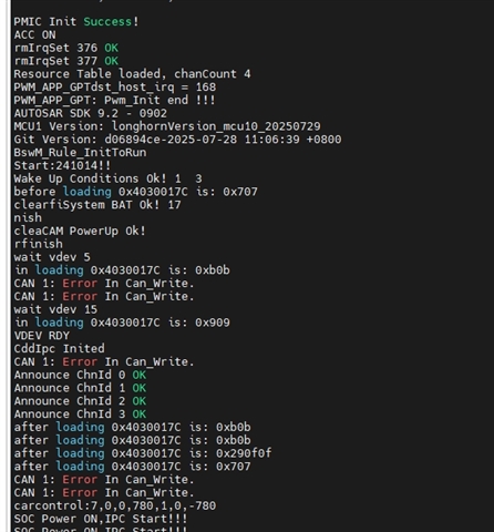

  • Hi Wenbin,
        Could you please print the value of register 0x4030 017C before loading  and in loading the c7x image? Thanks.
    Linjun
  • Hi linjun
    the register 0x4030 017C shown above. When AK2 application use SPI to start transmit, the data length is not fixed, but no more than 256 byte.
    It is not clear whether this change was the cause of the issue.
    We used MCU SPI0 on MCU1_0. The current startup sequence is that MCU1_0 initiates uboot, and then uboot in turn initiates other cores. The reason for this issue is that MCU1_0 starts the SPI transmission operation before starting other cores. If the transmission operation is initiated after all cores have been started, then this problem will disappear.
