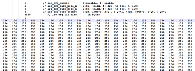

Hi TI experts
The above is the xm of the LSC module.
The default format is Q8+1.
Do the other formats AM62A support? If supported, how should it be configured?

Hi Qeng Qiang,
Are you aware of this FAQ: https://e2e.ti.com/support/processors-group/processors/f/processors-forum/1405138/faq-tda4vm-how-to-create-lens-shading-correction-lut-for-vpac-viss-lsc?
I suppose you can use the Matlab code provided in this FAQ to generate the LUT and modify the xml file. The Q value is an input parameter to the Matlab function.

What should I do to set the LSC gain to less than 1?
Hi Peng,
We don't normally use LSC gains (or any other pipeline gains) that are less than 1.0x as that may cause false color.

May I ask if AM62A supports gain less than 1? If so, how should I set it specifically?

Yes, H/W can support that.
For the gain formats without "+1", the gain can be less than one.
