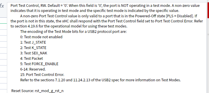

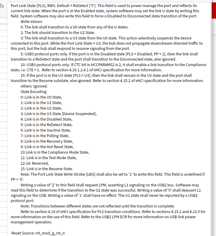

    Besides, setting devmem2 0x31210484 w 0x40000000 will get this register become 0xF0000000 which cannot make USB1 enter test mode.
    I check the register name and setting in register excel file and found the register bits are same as USB0 but still cannot make sure the registers are for USB1 or not.
    Could you double confirm this?
    I think it is because the port is not in the powered-off state that the register is getting set as 0xF0000000 when trying to set a non-zero value like 0x40000000 indicating port test control error.
    I tried on AM67x EVM but there is a USB Hub on USB1 so it will re-emurate after set  devmem2 0x31210480 w 0xA0
    Hence I think we might have to go to PLS=Disabled state before setting the port test control bits.
    Hence can you try the following sequence once;
    devmem2 0x31210480 w 0x80  (Sets it to PLS=Disabled state)
    devmem2 0x31210080 w 0x4

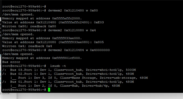

  • Gokul,
    For USB0, it works. Customer connect a USB 2.0 flash disk then input all the commends then remove USB flash disk, connect the test fixture after remove USB flash disk.
    For USB1, customer is connecting USB1 (USB2.0) + SERDES0 (USB3.0) as a USB 3.0 type A connector. Customer tried the comment you provided for USB1 but it still see bus error.
    Test procedure is same as USB0.
    I original think the commend for USB1 should be same as USB0 but just change the base address.
    Is this correct?  For USB1, we tried devmem2 0x31210480 w 0xA (and 0xA0, I thought it should be 0xA0) but both fail.
    Then we tried the new commend sets with PLS disable and result is as the capture console screen.
    Please help to confirm the commend we should use for USB1.

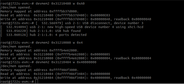

  • Gokul,
    You result on EVM is same as mine.
    You are just reproduced what I reported on EVM since there is Hub on EVM.
    The last commend "devmem2 0x31210484 w 0x40000000" actually will get 0xF0000000 if you read out after write.

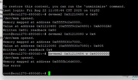

  • root@ecu1270-6800d0:~# devmem2 0x31210480
    /dev/mem opened.
    Memory mapped at address 0xffff88cfc000.
    Value at address 0x31210480 (0xffff88cfc480): 0xA0002A0
    root@ecu1270-6800d0:~# devmem2 0x31210480 w 0xA0
    /dev/mem opened.
    Memory mapped at address 0xffffb8037000.
    Value at address 0x31210480 (0xffffb8037480): 0xA0002A0
    Written 0xA0; readback 0x80
    /dev/mem opened.
    Memory mapped at address 0xffff90d46000.
    Value at address 0x31210480 (0xffff90d46480): 0x80
    root@ecu1270-6800d0:~# devmem2 0x31210080
    /dev/mem opened.
    Memory mapped at address 0xffff8d530000.
    Value at address 0x31210080 (0xffff8d530080): 0x805
    root@ecu1270-6800d0:~# devmem2 0x31210080 w 0x4
    /dev/mem opened.
    Memory mapped at address 0xffff83c3e000.
    Value at address 0x31210080 (0xffff83c3e080): 0x805
    Written 0x4; readback 0x4
    /dev/mem opened.
    Memory mapped at address 0xffff83112000.
    Value at address 0x31210080 (0xffff83112080): 0x4
    root@ecu1270-6800d0:~# devmem2 0x31210484
    /dev/mem opened.
    Memory mapped at address 0xffffa104f000.
    Bus error
    root@ecu1270-6800d0:~# devmem2 0x31210484 w 0x40000000
    /dev/mem opened.
    Memory mapped at address 0xffff94bb6000.
    Bus error
    /dev/mem opened.
    Memory mapped at address 0xffffb97b3000.
    Bus error
  • Gokul,
    The log from my input is on DRA821 EVM and I believe the result is same as yours on DRA821 EVM.
    The log from customer is on their own board which USB1 with SERDES0 as a USB 3.0 connector.
    They originally (previous hardware version) have USB0 with SERDES0 as a USB 3.0 connector and they can use the commends we provide for USB0 to enter USB 2.0 test mode.
    Now on their current version board (USB1 + SERDES0), they will see bus error when access 0x31210484.
    Need to complete USB2.0 test mode on USB1.
    Is there a internal test or validation way to prove this?
    BR, Rich
  • Hi Rich chen,
    On DRA821EVM, it doesnt fail as it readbacks the same value which is written. hence showing that it is working.
    However it could be failing on their custom boarrd because of their change from (USB0 with SERDES0) to (USB1 with SERDES1).

    Rich,
    No, the first command would be devmem2 0x31210480 w 0xA0. Since the bits 0:3 are read-only.
    We had not tested the USB1 since there was a hub and hence cannot test the USB2.0 test mode.

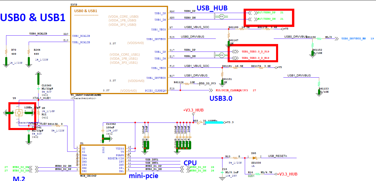

  • Hi Rich,
    Sorry for the delayed response.

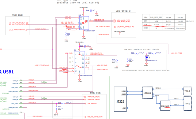

    Can you share the schematics of USB and serdes for the custom board. I have requested Shreyas to have a look into it.
    Gokul
  • Gokul,
    Here you go.
    BR, Rich
  • Hi Rich,
    As I had discussed internally, a couple of things to note:
    In the device tree, you need to have the usb1 dr_mode set to host and not in otg or device mode. Please check and confirm.
    Also, we need to not have a USB hub on USB1, since this will block the compliance. I will check the USB schematics along with my schematic expert.
    I can check on the AM62P EVM to see if it can be reproduced on that. If it has the USB hub, it might be a problem but I will let you know nevertheless.

  • root@j722s-evm:~# devmem2 0x31210480 w 0xA0
    /dev/mem opened.
    Memory mapped at address 0xffffbb6fd000.
    Read at address 0x31210480 (0xffffbb6fd480): 0x00000D60
    Write at address 0x31210480 (0xffffbb6fd480): 0x000000A0, readback 0x000000A0
    root@j722s-evm:~# devmem2 0x31210080 w 0x4
    /dev/mem opened.
    Memory mapped at address 0xffffa4d57000.
    Read at address 0x31210080 (0xffffa4d57080): 0x00000004
    Write at address 0x31210080 (0xffffa4d57080): 0x00000004, readback 0x00000004
    root@j722s-evm:~# devmem2 0x31210484 w 0x40000000
    /dev/mem opened.
    Memory mapped at address 0xffffb2787000.
    Read at address 0x31210484 (0xffffb2787484): 0x40000000
    Write at address 0x31210484 (0xffffb2787484): 0x40000000, readback 0x40000000
    root@j722s-evm:~#
    /dev/mem opened.
    Memory mapped at address 0xffff86f40000.
    Read at address 0x31210484 (0xffff86f40484): 0x40000000

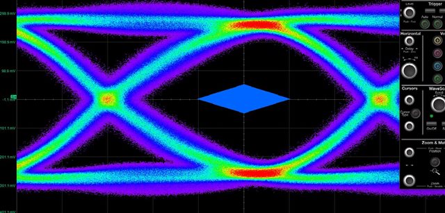

    I dont see the bus error on my end on the AM67 EVM.
    This is currently what I see on the scope. I am still looking into this.

    On customer board, they will not see USB Hub disconnect then connect message when issue 0xA0 to 0x31210480.
    However, after write 0x4 to 0x312100080 (no bus error), writing 0x40000000 to 0x31210484 will get bus error.
    What is causing the difference on our board? Could you check what the SOC remarking on the EVM you use?
    Where there be possibility the SOC PG version are different?
    /dev/mem opened.
    Bus error
    /dev/mem opened.
    Bus error
    /dev/mem opened.
    BR, Rich

    root@am67-sk:~#
    Shreyas,
    I found you were using J722S EVM so not sure why you don't encounter usb 1-1 port 2 cannot reset (err = -71)?
    How do you get the USB eye diagram on J722S EVM?
    Is there not a USB Hub behind?
    /dev/mem opened.
    Memory mapped at address 0xffffb995d000.
    Read at address 0x31210480 (0xffffb995d480): 0x00000E03
    Write at address 0x31210480 (0xffffb995d480): 0x000000A0, readback 0x000000A0
    root@j722s-evm:~# [ 68.887098] usb 1-1-port2: cannot reset (err = -71)
    [ 68.892120] usb 1-1-port2: cannot reset (err = -71)
    [ 68.897081] usb 1-1-port2: cannot reset (err = -71)
    [ 68.902058] usb 1-1-port2: cannot reset (err = -71)
    [ 68.907067] usb 1-1-port2: cannot reset (err = -71)
    [ 68.911947] usb 1-1-port2: Cannot enable. Maybe the USB cable is bad?
    [ 68.918489] usb 1-1-port2: cannot disable (err = -71)
    [ 68.923626] usb 1-1-port2: cannot reset (err = -71)
    [ 68.928579] usb 1-1-port2: cannot reset (err = -71)
    [ 68.933576] usb 1-1-port2: cannot reset (err = -71)
    [ 68.938536] usb 1-1-port2: cannot reset (err = -71)
    [ 68.943489] usb 1-1-port2: cannot reset (err = -71)
    [ 68.948372] usb 1-1-port2: Cannot enable. Maybe the USB cable is bad?
    [ 68.954890] usb 1-1-port2: cannot disable (err = -71)
    [ 68.960062] usb 1-1-port2: cannot reset (err = -71)
    [ 68.965021] usb 1-1-port2: cannot reset (err = -71)
    [ 68.969976] usb 1-1-port2: cannot reset (err = -71)
    [ 68.974935] usb 1-1-port2: cannot reset (err = -71)
    [ 68.979892] usb 1-1-port2: cannot reset (err = -71)
    [ 68.984774] usb 1-1-port2: Cannot enable. Maybe the USB cable is bad?
    [ 68.991328] usb 1-1-port2: cannot disable (err = -71)
    [ 68.996459] usb 1-1-port2: cannot reset (err = -71)
    [ 69.001454] usb 1-1-port2: cannot reset (err = -71)
    [ 69.006407] usb 1-1-port2: cannot reset (err = -71)
    [ 69.011402] usb 1-1-port2: cannot reset (err = -71)
    [ 69.016391] usb 1-1-port2: cannot reset (err = -71)
    [ 69.021273] usb 1-1-port2: Cannot enable. Maybe the USB cable is bad?
    [ 69.027788] usb 1-1-port2: cannot disable (err = -71)
    [ 69.032917] usb 1-1-port2: cannot disable (err = -71)
    [ 69.038152] hub 1-1:1.0: hub_ext_port_status failed (err = -71)
    [ 69.150496] sda: detected capacity change from 60995328 to 0
    BR, Rich
  • Yes, there is a Hub on the J722S EVM.
    Yesterday, we totally disabled USB0 and enabled USB1, also selected the USB_MUX_SEL as active high and with output_high to ensure that the USB1 mux is being selected and then measured at the input of the HUB and I see the test packet come out.
    I will request the patch that I used for you to try.
