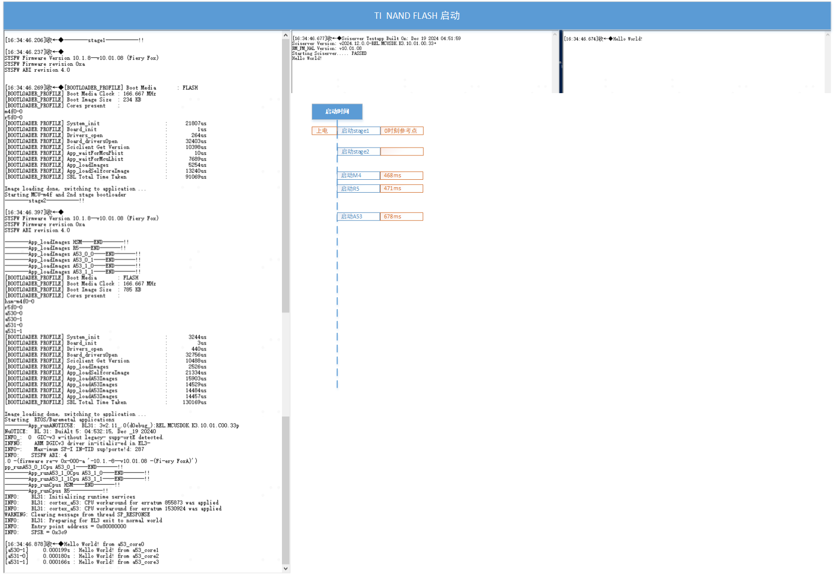

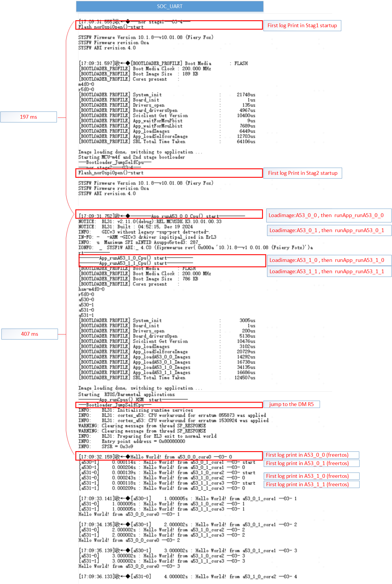

SK-AM62 board with OSPI NAND BOOT:  678ms
Custom board,   with OSPI NOR BOOT: 572ms
SDK: mcu_plus_sdk_am62x_11_00_00_16
I measured the time it took for the OSPI SBL in the SDK to boot up, load other core, and then run the A53 core. It takes about 600ms, which is too long. I want to know where this time is spent and whether it can be optimized. Here are our testing procedures:

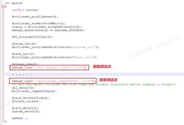

1. Add serial port test points to the examples. After completing the serial port initialization in the main() function, add a start test point, and add an end test point before performing the image jump.
2、Download the image according to the method software-dl.ti.com/.../GETTING_STARTED_FLASH.html,Below is the information about the loaded image.
3. In the boot mode, use the ospi mode. Power on, check the serial port output log to observe the startup time of each image and the execution time of each module. Below are the test data.

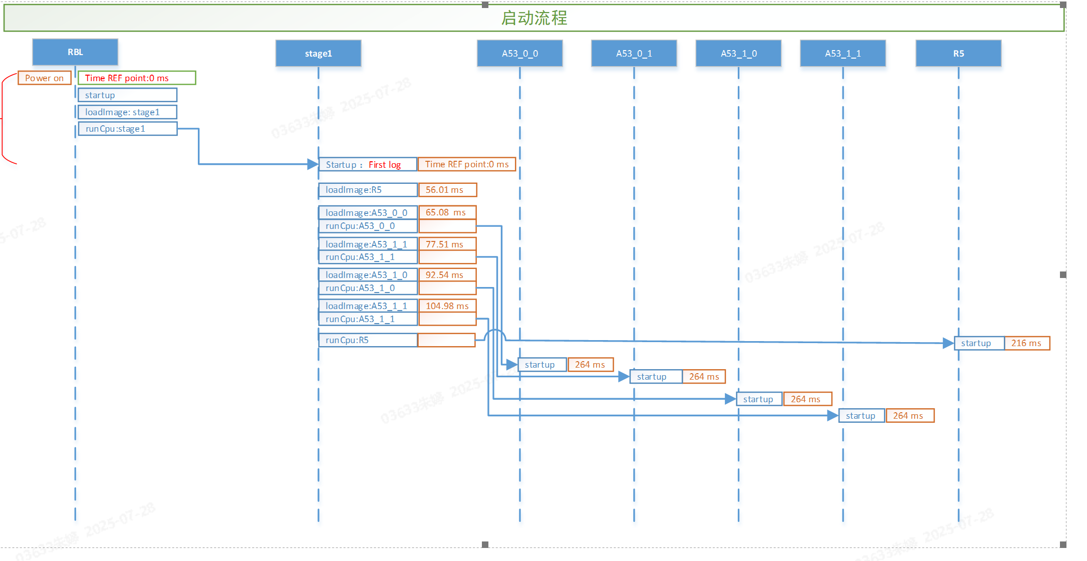

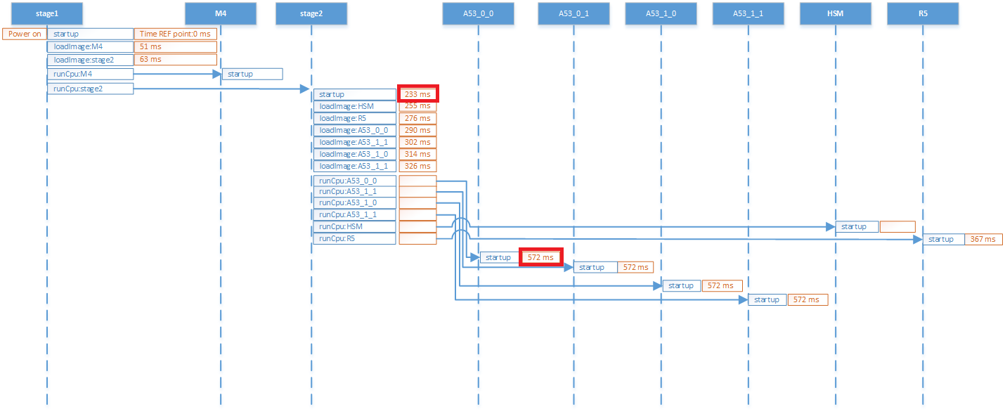

During stage 1: loadimage:stage2 and startup: 63ms to 233ms.
During stage 2: loadimage:A53_0_0 and startup:A53_0_0: 325ms to 572ms.
They are too long, where is the time spent? How to optimize the startup time?

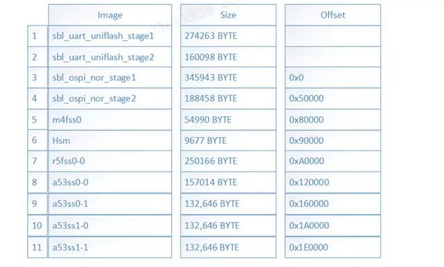

    In default SBL OSPI example, first all the images are loaded in the memory using App_loadA53Images API and then at the last the core are started(released from reset) using Bootloader_runCpu APIs: mcupsdk-core-k3/examples/drivers/boot/sbl_ospi_multistage/sbl_ospi_stage2/am62x-sk/r5fss0-0_nortos/main.c at k3_main · TexasInstruments/mcupsdk-core-k3 · GitHub
    I am not sure how much impact on the timing it would cause but you can try to call this App_runA53Cpu shortly after App_loadA53Images is done executing, at least for the A53 application images, for DM R5 you have to be careful because you are first supposed to load every other code, release them from reset and then only perform the jump to the DM R5 application, this is why you see  Bootloader_JumpSelfCpu being called at the very end: mcupsdk-core-k3/examples/drivers/boot/sbl_ospi_multistage/sbl_ospi_stage2/am62x-sk/r5fss0-0_nortos/main.c at k3_main · TexasInstruments/mcupsdk-core-k3 · GitHub

    My objective is: to optimize the startup time of the A53 core and the R5 core. Regarding the two pieces of time in the question, I don't know where I'm spending them now. They are too long and I want to know if it's possible to optimize them.

    We make below test result based on my understanding to your suggestion, most time consumed from startup A core to run(release reset) A core.

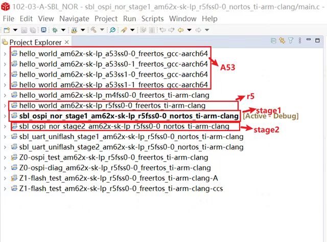

    1. What testing methods and test cases should I use to verify the real startup time of A53 and R5 cores?

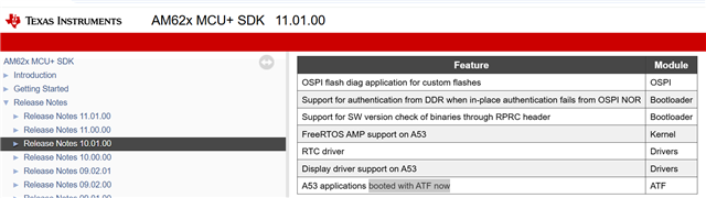

    2. Is ATF must exist?  if yes, is it must to execute ATF before running the application?
    #3. There is guide to disable ATF from makefile, can disable ATF in CCS?

    I assume your goal is to reduce the total time it takes to print the hello_world/display something on the UART terminal, and not the just the boot time, please confirm the same.

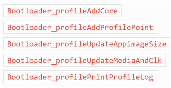

    You can configure a GPIO pin in SBL and toggle it to mark different timestamps in your application, for example, make that pin high just before calling API App_runA53Cpu and then make that pin low in your A53 application. The amount of time for which that pin stays should indicate the time from App_runA53Cpu to the time your application starts to run. Please try to use direct register write to toggle the pin, so as to avoid any delay caused by the API calls.
    I would also suggest, using the release mode binaries instead of debug binaries, as when using CCS debug binaries are generated by default.
    It is not really recommended to remove the ATF from application.

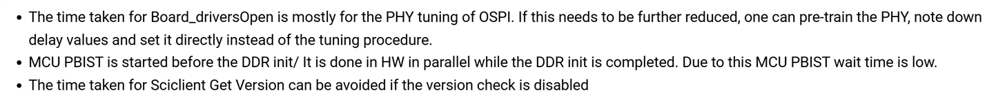

    We have some SBL benchmarks recorded here in the datasheet for some reference: AM62x MCU+ SDK: Datasheet
    Please also note that time taken to load an image also depends upon the size of the image.
    We have not benchmarked the time it takes from App_runA53Cpu to printing something on the UART, the thing is A53 core starts executing the first instruction (in this case the ATF/bl31_entrypoint) as soon as it is released from the reset.

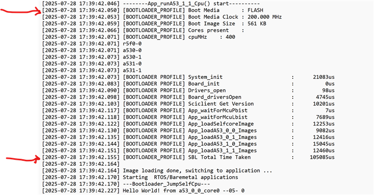

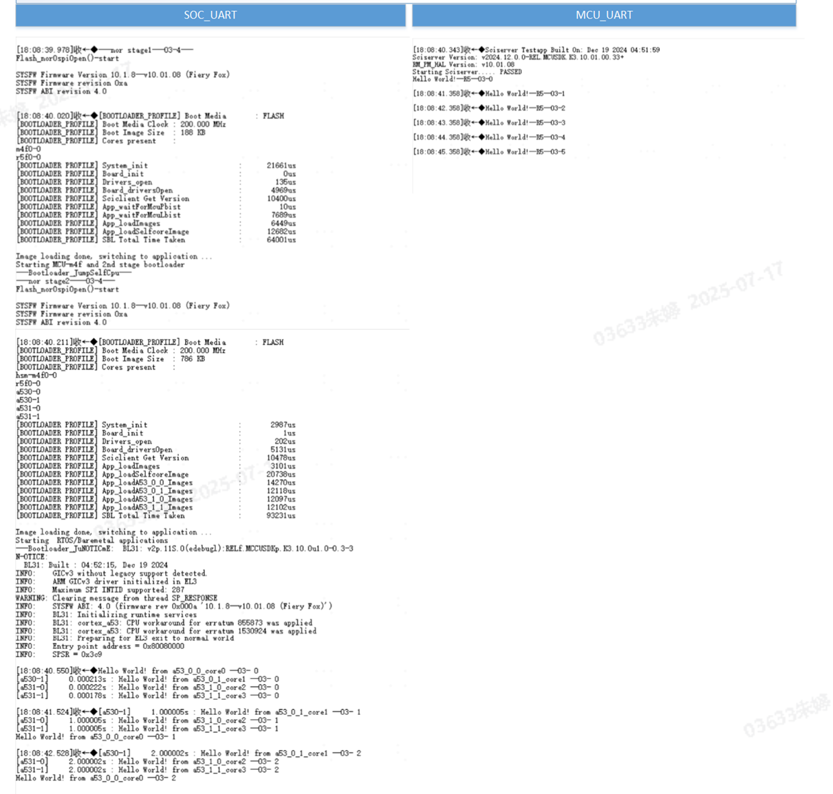

  • Hello Meet:
    Below is the UART print log with timestamps added, this is common tool/method to measure time of output log:
    [2025-07-22 19:16:17.458]---nor stage1---03-4---
    [2025-07-22 19:16:17.461]Flash_norOspiOpen()-start
    [2025-07-22 19:16:17.467]
    SYSFW Firmware Version 10.1.8--v10.01.08 (Fiery Fox)
    [2025-07-22 19:16:17.470]SYSFW Firmware revision 0xa
    [2025-07-22 19:16:17.472]SYSFW ABI revision 4.0
    [2025-07-22 19:16:17.503][BOOTLOADER_PROFILE] Boot Media       : FLASH
    [2025-07-22 19:16:17.509][BOOTLOADER_PROFILE] Boot Media Clock : 200.000 MHz
    [2025-07-22 19:16:17.512][BOOTLOADER_PROFILE] Boot Image Size  : 189 KB
    [2025-07-22 19:16:17.517][BOOTLOADER_PROFILE] Cores present    :
    [2025-07-22 19:16:17.524]m4f0-0
    r5f0-0
    [BOOTLOADER PROFILE] System_init                      :      21700us
    [2025-07-22 19:16:17.530][BOOTLOADER PROFILE] Board_init                       :          1us
    [2025-07-22 19:16:17.539][BOOTLOADER PROFILE] Drivers_open                     :        135us
    [2025-07-22 19:16:17.545][BOOTLOADER PROFILE] Board_driversOpen                :       4968us
    [2025-07-22 19:16:17.551][BOOTLOADER PROFILE] Sciclient Get Version            :      10398us
    [2025-07-22 19:16:17.557][BOOTLOADER PROFILE] App_waitForMcuPbist              :         10us
    [2025-07-22 19:16:17.566][BOOTLOADER PROFILE] App_waitForMcuLbist              :       7690us
    [2025-07-22 19:16:17.572][BOOTLOADER PROFILE] App_loadImages                   :       6449us
    [2025-07-22 19:16:17.577][BOOTLOADER PROFILE] App_loadSelfcoreImage            :      12702us
    [2025-07-22 19:16:17.583][BOOTLOADER_PROFILE] SBL Total Time Taken             :      64055us
    [2025-07-22 19:16:17.590]Image loading done, switching to application ...
    [2025-07-22 19:16:17.592]Starting MCU-m4f and 2nd stage bootloader
    [2025-07-22 19:16:17.596]---Bootloader_JumpSelfCpu---
    [2025-07-22 19:16:17.601]---nor stage2----03-4---
    [2025-07-22 19:16:17.604]Flash_norOspiOpen()-start
    [2025-07-22 19:16:17.610]SYSFW Firmware Version 10.1.8--v10.01.08 (Fiery Fox)
    [2025-07-22 19:16:17.614]SYSFW Firmware revision 0xa
    [2025-07-22 19:16:17.615]SYSFW ABI revision 4.0
    [2025-07-22 19:16:17.657]--------App_runA53_0_0_Cpu() start----------
    [2025-07-22 19:16:17.664]NOTICE:  BL31: v2.11.0(debug):REL.MCUSDK.K3.10.01.00.33
    [2025-07-22 19:16:17.669]NOTICE:  BL31: Built : 04:52:15, Dec 19 2024
    [2025-07-22 19:16:17.672]INFO:    GICv3 witho-ut legacy -support detect-ed.
    [2025-07-22 19:16:17.677]INFO:    A-RM GI-Cv3 dri-ver initia-lized in -EL3
    [2025-07-22 19:16:17.683]INAFO:  p  Mapximum _SPIr INTIDu sunpported:A 287
    [2025-07-22 19:16:17.689]INFO:  5  SYSF3W ABI: 4_.0 (f0irmwar_e rev 10x00_0a C'10.1p.8--v10.01.0u8 (Fie(ry F)ox)')
    [2025-07-22 19:16:17.692] start----------
    [2025-07-22 19:16:17.708]--------App_runA53_1_0_Cpu() start----------
    [2025-07-22 19:16:17.725]--------App_runA53_1_1_Cpu() start----------
    [2025-07-22 19:16:17.728][BOOTLOADER_PROFILE] Boot Media       : FLASH
    [2025-07-22 19:16:17.734][BOOTLOADER_PROFILE] Boot Media Clock : 200.000 MHz
    [2025-07-22 19:16:17.741][BOOTLOADER_PROFILE] Boot Image Size  : 786 KB
    [2025-07-22 19:16:17.744][BOOTLOADER_PROFILE] Cores present    :
    [2025-07-22 19:16:17.747]hsm-m4f0-0
    r5f0-0
    [2025-07-22 19:16:17.750]a530-0
    a530-1
    a531-0
    a531-1
    [2025-07-22 19:16:17.756][BOOTLOADER PROFILE] System_init                      :       3000us
    [2025-07-22 19:16:17.761][BOOTLOADER PROFILE] Board_init                       :          1us
    [2025-07-22 19:16:17.767][BOOTLOADER PROFILE] Drivers_open                     :        198us
    [2025-07-22 19:16:17.773][BOOTLOADER PROFILE] Board_driversOpen                :       5124us
    [2025-07-22 19:16:17.783][BOOTLOADER PROFILE] Sciclient Get Version            :      10460us
    [2025-07-22 19:16:17.789][BOOTLOADER PROFILE] App_loadImages                   :       3104us
    [2025-07-22 19:16:17.795][BOOTLOADER PROFILE] App_loadSelfcoreImage            :      20734us
    [2025-07-22 19:16:17.801][BOOTLOADER PROFILE] App_loadA53_0_0_Images           :      14292us
    [2025-07-22 19:16:17.809][BOOTLOADER PROFILE] App_loadA53_0_1_Images           :      16734us
    [2025-07-22 19:16:17.815][BOOTLOADER PROFILE] App_loadA53_1_0_Images           :      34166us
    [2025-07-22 19:16:17.822][BOOTLOADER PROFILE] App_loadA53_1_1_Images           :      16687us
    [2025-07-22 19:16:17.828][BOOTLOADER_PROFILE] SBL Total Time Taken             :     124503us
    [2025-07-22 19:16:17.834]Image loading done, switching to application ...
    [2025-07-22 19:16:17.837]Starting  RTOS/Baremetal applications
    [2025-07-22 19:16:17.841]--------App_runCpus() HSM  start----------
    [2025-07-22 19:16:17.844]---Bootloader_JumpSelfCpu---
    [2025-07-22 19:16:17.860]INFO:    BL31: Initializing runtime services
    [2025-07-22 19:16:17.866]INFO:    BL31: cortex_a53: CPU workaround for erratum 855873 was applied
    [2025-07-22 19:16:17.875]INFO:    BL31: cortex_a53: CPU workaround for erratum 1530924 was applied
    [2025-07-22 19:16:17.878]WARNING: Clearing message from thread SP_RESPONSE
    [2025-07-22 19:16:17.883]WARNING: Clearing message from thread SP_RESPONSE
    [2025-07-22 19:16:17.886]INFO:    BL31: Preparing for EL3 exit to normal world
    [2025-07-22 19:16:17.892]INFO:    Entry point address = 0x80080000
    [2025-07-22 19:16:17.895]INFO:    SPSR = 0x3c9
    [2025-07-22 19:16:18.062]Hello World! from a53_0_0_core0 --03- 0
    [2025-07-22 19:16:18.077][a530-1]     0.000128s : Hello World! from a53_0_1_core1 --03- start
    [2025-07-22 19:16:18.082][a530-1]     0.000219s : Hello World! from a53_0_1_core1 --03- 0
    [2025-07-22 19:16:18.087][a531-0]     0.000137s : Hello World! from a53_1_0_core2 --03- start
    [2025-07-22 19:16:18.093][a531-0]     0.000239s : Hello World! from a53_1_0_core2 --03- 0
    [2025-07-22 19:16:18.098][a531-1]     0.000116s : Hello World! from a53_1_1_core3 --03- start

    You can refer to the previously highlighted red text to understand the printing information:
     The too long startup time should spend there, there are too many stages during booting, each takes several ms, we need you help to figure out how to reduce the time.
  • Hi Zegeng,
    Thanks for providing these detailed logs, I would try to go through and analyze which part might be taking longer to execute and if there is any space to optimize the same. From our earlier discussion I assume that your final goal is to complete the execution of both SBL stages and a53 application and print the hello world to the UART terminal within 300ms, please confirm if my understanding is correct, based on that I will try to check whether it is possible to achieve this timing or not.
    Please confirm if you are building the binary in debug mode or release mode? If you are using debug mode, then please try once using the release mode binaries. Here are the number for SBL OSPI NOR mentioned in the MCU+SDK datasheet: AM62x MCU+ SDK: Datasheet, In the first screenshot shared by you for SBL OSPI NOR (for the custom board) I see that the timings there don't match with the numbers in the MCU+SDK datasheet, so I suspect that you could be testing with debug binaries.
  • Hello Meet,
    Thank you very much for your reminder. We indeed used the binary in debug mode before. Below are the serial port log data we obtained using the binary in release mode. The time less compared to the debug mode is about 100 milliseconds. Please review this log for analysis.
    [2025-07-23 14:04:45.905] ---nor stage1---03-4---
    [2025-07-23 14:04:45.906] Flash_norOspiOpen()-start
    [2025-07-23 14:04:45.910]
    [2025-07-23 14:04:45.910] SYSFW Firmware Version 10.1.8--v10.01.08 (Fiery Fox)
    [2025-07-23 14:04:45.915] SYSFW Firmware revision 0xa
    [2025-07-23 14:04:45.918] SYSFW ABI revision 4.0
    [2025-07-23 14:04:45.922]
    [2025-07-23 14:04:45.942] [BOOTLOADER_PROFILE] Boot Media       : FLASH
    [2025-07-23 14:04:45.950] [BOOTLOADER_PROFILE] Boot Media Clock : 200.000 MHz
    [2025-07-23 14:04:45.962] [BOOTLOADER_PROFILE] Boot Image Size  : 149 KB
    [2025-07-23 14:04:45.962] [BOOTLOADER_PROFILE] Cores present    :
    [2025-07-23 14:04:45.974] [BOOTLOADER_PROFILE] cpuMHz    : 400
    [2025-07-23 14:04:45.974] m4f0-0
    [2025-07-23 14:04:45.974] r5f0-0
    [2025-07-23 14:04:45.974] [BOOTLOADER PROFILE] System_init                      :      21012us
    [2025-07-23 14:04:45.992] [BOOTLOADER PROFILE] Board_init                       :          0us
    [2025-07-23 14:04:45.992] [BOOTLOADER PROFILE] Drivers_open                     :         98us
    [2025-07-23 14:04:45.992] [BOOTLOADER PROFILE] Board_driversOpen                :       4836us
    [2025-07-23 14:04:46.001] [BOOTLOADER PROFILE] Sciclient Get Version            :      10201us
    [2025-07-23 14:04:46.001] [BOOTLOADER PROFILE] App_waitForMcuPbist              :          5us
    [2025-07-23 14:04:46.012] [BOOTLOADER PROFILE] App_waitForMcuLbist              :       7689us
    [2025-07-23 14:04:46.021] [BOOTLOADER PROFILE] App_loadImages                   :       4657us
    [2025-07-23 14:04:46.021] [BOOTLOADER PROFILE] App_loadSelfcoreImage            :       9188us
    [2025-07-23 14:04:46.040] [BOOTLOADER_PROFILE] SBL Total Time Taken             :      57690us
    [2025-07-23 14:04:46.040] Image loading done, switching to application ...
    [2025-07-23 14:04:46.040] Starting MCU-m4f and 2nd stage bootloader
    [2025-07-23 14:04:46.048] ---Bootloader_JumpSelfCpu---
    [2025-07-23 14:04:46.058] ---nor stage2----03-4---
    [2025-07-23 14:04:46.058] Flash_norOspiOpen()-start
    [2025-07-23 14:04:46.058] SYSFW Firmware Version 10.1.8--v10.01.08 (Fiery Fox)
    [2025-07-23 14:04:46.058] SYSFW Firmware revision 0xa
    [2025-07-23 14:04:46.068] SYSFW ABI revision 4.0
    [2025-07-23 14:04:46.069]
    [2025-07-23 14:04:46.084] --------App_runA53_0_0_Cpu() start----------
    [2025-07-23 14:04:46.101] NOTICE:  BL31: v2.11.0(release):REL.MCUSDK.K3.10.01.00.33
    [2025-07-23 14:04:46.102] NOTICE:  BL31: Built :- 04-:57:09,- Dec- 19- 20-24
    [2025-07-23 14:04:46.102] --App_runA53_0_1_Cpu() start----------
    [2025-07-23 14:04:46.116] --------App_runA53_1_0_Cpu() start----------
    [2025-07-23 14:04:46.125] --------App_runA53_1_1_Cpu() start----------
    [2025-07-23 14:04:46.127] [BOOTLOADER_PROFILE] Boot Media       : FLASH
    [2025-07-23 14:04:46.140] [BOOTLOADER_PROFILE] Boot Media Clock : 200.000 MHz
    [2025-07-23 14:04:46.140] [BOOTLOADER_PROFILE] Boot Image Size  : 568 KB
    [2025-07-23 14:04:46.146] [BOOTLOADER_PROFILE] Cores present    :
    [2025-07-23 14:04:46.150] [BOOTLOADER_PROFILE] cpuMHz    : 400
    [2025-07-23 14:04:46.150] hsm-m4f0-0
    [2025-07-23 14:04:46.157] r5f0-0
    [2025-07-23 14:04:46.157] a530-0
    [2025-07-23 14:04:46.157] a530-1
    [2025-07-23 14:04:46.157] a531-0
    [2025-07-23 14:04:46.157] a531-1
    [2025-07-23 14:04:46.157] [BOOTLOADER PROFILE] System_init                      :       2851us
    [2025-07-23 14:04:46.167] [BOOTLOADER PROFILE] Board_init                       :          1us
    [2025-07-23 14:04:46.171] [BOOTLOADER PROFILE] Drivers_open                     :        115us
    [2025-07-23 14:04:46.179] [BOOTLOADER PROFILE] Board_driversOpen                :       4982us
    [2025-07-23 14:04:46.183] [BOOTLOADER PROFILE] Sciclient Get Version            :      10274us
    [2025-07-23 14:04:46.189] [BOOTLOADER PROFILE] App_loadImages                   :       2911us
    [2025-07-23 14:04:46.200] [BOOTLOADER PROFILE] App_loadSelfcoreImage            :      12375us
    [2025-07-23 14:04:46.200] [BOOTLOADER PROFILE] App_loadA53_0_0_Images           :       9269us
    [2025-07-23 14:04:46.212] [BOOTLOADER PROFILE] App_loadA53_0_1_Images           :      12722us
    [2025-07-23 14:04:46.216] [BOOTLOADER PROFILE] App_loadA53_1_0_Images           :      15040us
    [2025-07-23 14:04:46.222] [BOOTLOADER PROFILE] App_loadA53_1_1_Images           :      12508us
    [2025-07-23 14:04:46.234] [BOOTLOADER_PROFILE] SBL Total Time Taken             :      83055us
    [2025-07-23 14:04:46.243]
    [2025-07-23 14:04:46.243] Image loading done, switching to application ...
    [2025-07-23 14:04:46.243] Starting  RTOS/Baremetal applications
    [2025-07-23 14:04:46.243] --------App_runCpus() HSM  start----------
    [2025-07-23 14:04:46.247] ---Bootloader_JumpSelfCpu---
    [2025-07-23 14:04:46.303] Hello World! from a53_0_0_core0 --03- 0
    [2025-07-23 14:04:46.312] [a530-1]     0.000060s : Hello World! from a53_0_1_core1 --03- start
    [2025-07-23 14:04:46.319] [a530-1]     0.000128s : Hello World! from a53_0_1_core1 --03- 0
    [2025-07-23 14:04:46.330] [a531-0]     0.000063s : Hello World! from a53_1_0_core2 --03- start
    [2025-07-23 14:04:46.330] [a531-0]     0.000129s : Hello World! from a53_1_0_core2 --03- 0
    [2025-07-23 14:04:46.340] [a531-1]     0.000088s : Hello World! from a53_1_1_core3 --03- start
    [2025-07-23 14:04:46.348] [a531-1]     0.000147s : Hello World! from a53_1_1_core3 --03- 0
    [2025-07-23 14:04:47.303] Hello World! from a53_0_0_core0 --03- 1
    [2025-07-23 14:04:47.316] [a530-1]     1.000004s : Hello World! from a53_0_1_core1 --03- 1
    [2025-07-23 14:04:47.323] [a531-0]     1.000003s : Hello World! from a53_1_0_core2 --03- 1
    [2025-07-23 14:04:47.344] [a531-1]     1.000004s : Hello World! from a53_1_1_core3 --03- 1
    [2025-07-23 14:04:50.578] Hello World! from a53_0_0_core0 --03- 2
    [2025-07-23 14:04:50.578] [a530-1]     2.000001s : Hello World! from a53_0_1_core1 --03- 2
    [2025-07-23 14:04:50.578] [a531-0]     2.000001s : Hello World! from a53_1_0_core2 --03- 2
    [2025-07-23 14:04:50.578] [a531-1]     2.000001s : Hello World! from a53_1_1_core3 --03- 2
    [2025-07-23 14:04:50.582] Hello World! from a53_0_0_core0 --03- 3
    [2025-07-23 14:04:50.582] [a530-1]     3.000001s : Hello World! from a53_0_1_core1 --03- 3
    [2025-07-23 14:04:50.582] [a531-0]     3.000001s : Hello World! from a53_1_0_core2 --03- 3
    [2025-07-23 14:04:50.582] [a531-1]     3.000001s : Hello World! from a53_1_1_core3 --03- 3
    [2025-07-23 14:04:50.582] Hello World! from a53_0_0_core0 --03- 4
    [2025-07-23 14:04:50.582] [a530-1]     4.000001s : Hello World! from a53_0_1_core1 --03- 4
    [2025-07-23 14:04:50.582] [a531-0]     4.000001s : Hello World! from a53_1_0_core2 --03- 4
    [2025-07-23 14:04:50.582] [a531-1]     4.000001s : Hello World! from a53_1_1_core3 --03- 4
    Hello world is a simple example, our final target is  is to complete the execution of both SBL stages and a53 application and output display within 300ms. I think at this point you can proceed based on your current understanding to help us assess whether it is possible to achieve this time requirement.

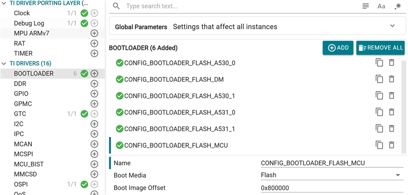

  • Hi Tony, Zegeng,
    As the first stage of the bootloader must runs from HSM RAM, you can't load the HSM application using this boot flow, you can't directly remove stage-1. You will have to merge both the stages into a single bootloader application for this.
    For this you will have to add additional bootloader instances from syscfg in Stage-1 for a53 images and will also have to add the code that loads these images, you can copy the code for the same from stage-2 to stage-1. Also, instead of loading SBL Stage-2 image on R5 in Stage-1, you have to load the application image for R5. Some other optimization steps are suggested at the end of the datasheet numbers:
    If you check the timestamps, then it seems that, printing these many logs is also taking some time, you can remove BOOTLOADER_PROFILE logs for now and see how much optimization you can achieve with this.
    Meet.

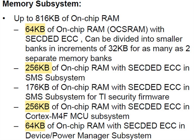

  • Meet,
    #1. It is private e2e, customer can't access.
    #2. I took a look at that post, didn't find detail instructions.  almost same as upper content. a detail steps would help.
    #3. Why stage-1 must run on HSM RAM? is HSM RAM the 256KB SMS subsystem?
    #4. Can change to other on chip RAM space? like M4F,
  • Hi Tony,
    You can follow the steps I mentioned in my previous response:
    - Add additional bootloader instances in the syscfg in Stage-1 for a53 images, for the R5 Core, load the DM application instead of SBL Stage-2:
    - You will also have to add the code that loads these images, you can copy the code for the same from stage-2 to stage-1:
    -  We only have around 240kB of HSMRAM available for SBL, so you might not be able to load your SBL appimage if it exceeds this limit.
    Yes
    This is not possible as the ROM Code loads the stage-1 code to HSM RAM and it is not possibe to change the ROM Code.
    Meet.

    #1. assume it is taken by ATF, remove ATF can save a lot of time.
    #2. Is ATF must or necessary for this RTOS based use case?
    #3. What did it do in so long time?
  • Hi Tony,
    Removing ATF is really not recommended, if customer's use case of running the application within 300ms is satisfied then you shouldn't try to remove this.
    I also think that this extra time is due to printing the BOOT_PROFILE logs, the time it takes to print these logs is not included when SBL Total Time taken is calculated, you can also estimate from the timestamps on how long it takes to print these logs .Can you once try disabling the logs and check the timings again, comment the calls to following API calls:
    You can also disable Sciclient get version API, that will save like 10ms, it doesn't really seem possible to optimize the boot time further than this, you can ask them to try these 2 things for now.
    Best Regards.
    Meet.
  • Hello Meet,
    We followed your guide to integrity to stage 1 only. Below are the serial port log data, the still take fairly long between runCPU:A53 and startup, as this is simple example, final example will be larger. We need to optimize as possible.
    [2025-07-28 17:39:41.963] ---nor stage1---05----
    [2025-07-28 17:39:41.965] Flash_norOspiOpen()-start
    [2025-07-28 17:39:41.969]
    [2025-07-28 17:39:41.969] SYSFW Firmware Version 10.1.8--v10.01.08 (Fiery Fox)
    [2025-07-28 17:39:41.977] SYSFW Firmware revision 0xa
    [2025-07-28 17:39:41.977] SYSFW ABI revision 4.0
    [2025-07-28 17:39:41.978]
    [2025-07-28 17:39:42.007] --------App_runA53_0_0_Cpu() start----------
    [2025-07-28 17:39:42.012] NOTICE:  BL31: v2.11.0(release):REL.MCUSDK.K3.10.01.00.33
    [2025-07-28 17:39:42.016] NOTICE:  BL31: Bui-lt : 0-4:57:-09,- Dec -19 2024-
    [2025-07-28 17:39:42.024] --App_runA53_0_1_Cpu() start----------
    [2025-07-28 17:39:42.035] --------App_runA53_1_0_Cpu() start----------
    [2025-07-28 17:39:42.046] --------App_runA53_1_1_Cpu() start----------
    [2025-07-28 17:39:42.050] [BOOTLOADER_PROFILE] Boot Media       : FLASH
    [2025-07-28 17:39:42.053] [BOOTLOADER_PROFILE] Boot Media Clock : 200.000 MHz
    [2025-07-28 17:39:42.059] [BOOTLOADER_PROFILE] Boot Image Size  : 561 KB
    [2025-07-28 17:39:42.066] [BOOTLOADER_PROFILE] Cores present    :
    [2025-07-28 17:39:42.071] [BOOTLOADER_PROFILE] cpuMHz    : 400
    [2025-07-28 17:39:42.071] r5f0-0
    [2025-07-28 17:39:42.071] a530-0
    [2025-07-28 17:39:42.073] a530-1
    [2025-07-28 17:39:42.073] a531-0
    [2025-07-28 17:39:42.073] a531-1
    [2025-07-28 17:39:42.073] [BOOTLOADER PROFILE] System_init                      :      21083us
    [2025-07-28 17:39:42.083] [BOOTLOADER PROFILE] Board_init                       :          0us
    [2025-07-28 17:39:42.090] [BOOTLOADER PROFILE] Drivers_open                     :         98us
    [2025-07-28 17:39:42.098] [BOOTLOADER PROFILE] Board_driversOpen                :       4745us
    [2025-07-28 17:39:42.103] [BOOTLOADER PROFILE] Sciclient Get Version            :      10201us
    [2025-07-28 17:39:42.117] [BOOTLOADER PROFILE] App_waitForMcuPbist              :          7us
    [2025-07-28 17:39:42.118] [BOOTLOADER PROFILE] App_waitForMcuLbist              :       7689us
    [2025-07-28 17:39:42.122] [BOOTLOADER PROFILE] App_loadSelfcoreImage            :      12253us
    [2025-07-28 17:39:42.130] [BOOTLOADER PROFILE] App_loadA53_0_0_Images           :       9082us
    [2025-07-28 17:39:42.135] [BOOTLOADER PROFILE] App_loadA53_0_1_Images           :      12416us
    [2025-07-28 17:39:42.144] [BOOTLOADER PROFILE] App_loadA53_1_0_Images           :      15045us
    [2025-07-28 17:39:42.151] [BOOTLOADER PROFILE] App_loadA53_1_1_Images           :      12460us
    [2025-07-28 17:39:42.155] [BOOTLOADER_PROFILE] SBL Total Time Taken             :     105085us
    [2025-07-28 17:39:42.164]
    [2025-07-28 17:39:42.164] Image loading done, switching to application ...
    [2025-07-28 17:39:42.170] Starting  RTOS/Baremetal applications
    [2025-07-28 17:39:42.170] ---Bootloader_JumpSelfCpu---
    [2025-07-28 17:39:42.227] Hello World! from a53_0_0_core0 --05- 0
    [2025-07-28 17:39:42.240] [a530-1]     0.000058s : Hello World! from a53_0_1_core1 --05- start
    [2025-07-28 17:39:42.243] [a530-1]     0.000120s : Hello World! from a53_0_1_core1 --05- 0
    [2025-07-28 17:39:42.250] [a531-0]     0.000066s : Hello World! from a53_1_0_core2 --05- start
    [2025-07-28 17:39:42.259] [a531-0]     0.000129s : Hello World! from a53_1_0_core2 --05- 0
    [2025-07-28 17:39:42.259] [a531-1]     0.000088s : Hello World! from a53_1_1_core3 --05- start
    [2025-07-28 17:39:42.265] [a531-1]     0.000149s : Hello World! from a53_1_1_core3 --05- 0
    [2025-07-28 17:39:43.227] Hello World! from a53_0_0_core0 --05- 1
    [2025-07-28 17:39:43.241] [a530-1]     1.000004s : Hello World! from a53_0_1_core1 --05- 1
    [2025-07-28 17:39:43.244] [a531-0]     1.000004s : Hello World! from a53_1_0_core2 --05- 1
    [2025-07-28 17:39:43.250] [a531-1]     1.000004s : Hello World! from a53_1_1_core3 --05- 1
    [2025-07-28 17:39:44.229] Hello World! from a53_0_0_core0 --05- 2
    [2025-07-28 17:39:44.235] [a530-1]     2.000001s : Hello World! from a53_0_1_core1 --05- 2
    [2025-07-28 17:39:44.245] [a531-0]     2.000001s : Hello World! from a53_1_0_core2 --05- 2
    [2025-07-28 17:39:44.254] [a531-1]     2.000001s : Hello World! from a53_1_1_core3 --05- 2
    [2025-07-28 17:39:45.228] Hello World! from a53_0_0_core0 --05- 3
    [2025-07-28 17:39:45.246] [a530-1]     3.000001s : Hello World! from a53_0_1_core1 --05- 3
    [2025-07-28 17:39:45.246] [a531-0]     3.000001s : Hello World! from a53_1_0_core2 --05- 3
    [2025-07-28 17:39:45.250] [a531-1]     3.000001s : Hello World! from a53_1_1_core3 --05- 3
    #1. What did it do in so long time?
    #2. Why is it not recommended to delete ATF? there is not ATF before MCU SDK10, seems it is not must.
    #3. UART print takes some time, but it is trivial, we can see time spend on each line, we can disable it in final integration. but for now, leave it here for reference.

  • Hi Zegeng,
    Please refer to this document on ATF integrated flow: AM62x MCU+ SDK: Understanding ATF integrated flow for A53
    If you want to build the application without the ATF then you would have to set ATF_INTEGRATED_BOOT to no instead of yes, this will allow you to build the application without ATF: mcupsdk-core-k3/examples/hello_world/am62x-sk/a53ss0-0_freertos/gcc-aarch64/makefile at k3_next · TexasInstruments/mcupsdk-core-k3 · GitHub
    Most of the time I think is still attributed to printing logs, removing ATF can save you 20-30ms I assume.
    Please check the following timestamps:
    Printing these logs itself is taking around 100ms, please note that this time is not counted in SBL Total Time Taken, also as Tony mentioned before, A53 can't start the application until SBL completes its execution and DM application starts running on R5. Please note that this will delay the SBL completion and will attribute to total time taken to boot A53.
    Meet.
