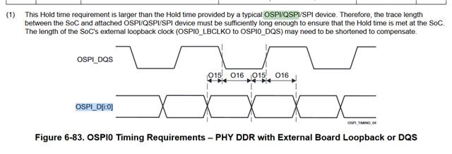

Is there QSPI timing specification for AM64x?
In Data Manual, there is only timing specification for McSPI and OSPI but not for QSPI.
BR, Rich
  • Hi Rich,
    The OSPI timing requirements are valid also for QSPI chips. The point is, OSPI0 controller is supporting both OSPI and QSPI memories.
    You can see in the OSPI section that the number of data pins is represented with variable 'i' and QSPI is sometimes mentioned :
    I agree the section title may has to be adjusted.
    Stan
  • Stan,
