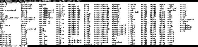

    and can't find the pcie device in /dev/
    how to fix it?
       Semon
  • Hi Semon,
    [ 396.483339] pci_epf_test pci_epf_test.2: Failed to get private DMA rx channel. Falling back to generic one
    This error is fine. This is just saying that the PCIe controller itself does not have a built-in DMA channel, so the PCIe example driver is falling back to the generic system DMA channel.
    PCIe device will be found on the second TDA4VM configured as RC. The PCie EP/RC is a demo that requires two different EVMs.
