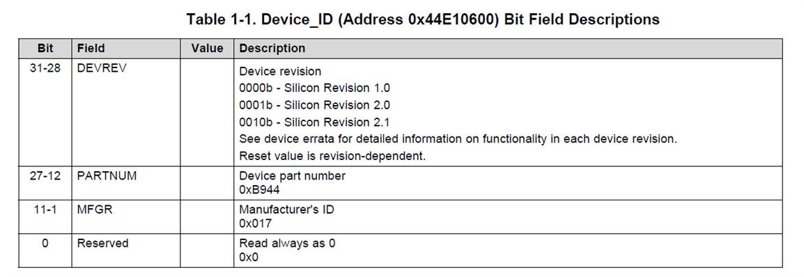

Hello Sir/Madam,
We are planning to migrate our platform based on AM335x Sitara family processor with part# AM3356BZCZA60 to the latest SDK. At the moment it is running on Linux Kernel (4.14.67), U-Boot (2018.01-00444-g96cdbef-dirty), and filesystem built using a Non-SDK variant of Yocto with SysV init system. Our intent is to migrate this what the latest SDK has to offer, skipping incremental SDK variants. As per the info on TI website https://www.ti.com/tool/PROCESSOR-SDK-AM335X#downloads, we see that the latest version is 09.03.05.02 release on Dec 13, 2024. On the Supported products & hardware sections it lists AM3356 which is the name of our SoC.
But since we are leapfrogging to a much higher version of the SDK with accompanying Kernel, U-Boot, Build tool chain, and Yocto distro; We wanted to check whether our hardware revision of the SoC will be fully supported by the components of this SDK. As per the part number and info printed on the chip and from the line "36CLGXW G1" we assume that the "G1" corresponds to Silicon Revision 1.0. Please correct us, if this interpretation is wrong!
We understand that with the latest SDKs may drop support for very old kernel/U-boot features or boot modes. They also might have errata which need to be applied/patched which may bring in some constraints. At the moment we are only considering the built-in devices/config of the SoC. External peripherals, and their specific driver/config need to be considered in the second stage.
Our current platform looks like this...
1GB DDR3
ISSI IS43TR16512B-125KBLI
1GB NAND Flash
MICRON MT29F8G08ABACAH4-IT:C
Attaching DTS for reference
So, our questions are...
- Although the support page mentions AM3356, it doesn't specifically mention about anything about hardware revisions. The latest SDK docs https://software-dl.ti.com/processor-sdk-linux/esd/docs/latest/linux/Release_Specific_Supported_Platforms_and_Versions.html#release-specific-supported-platforms-and-versions mentions EVMs, But again no direct mention of SoC revisions. Also the version on this page shows "07_03_00_005", not the 09.xx on the SDK download page.
- What is the recommended approach we should be taking for this upgrade? Will the SDK contain all the necessary patches, and guidance to apply those? The hardware and board design will not be changed.
- Can this be considered like a medium effort upgrade (only till the SoC is up, not including external peripherals), or will it be tall order?
- Are there any other factors we need to be considering?
