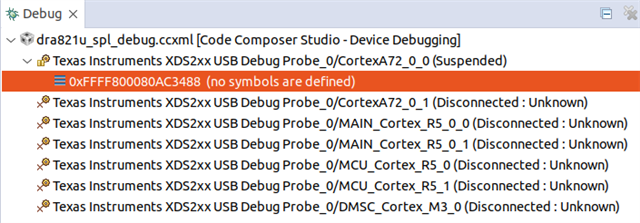

    but it seems that JTAG remains enabled.
    How can I disable JTAG?
    mizutani
  • Hi mizutani
    Are you loading boot loader image and then connecting to A72 ? If yes make sure your bootloader certificate doesn't have debug extension.
    Diwakar
    We managed to boot the kernel by referring to the following forum.
    https://e2e.ti.com/support/processors-group/processors/f/processors-forum/1445146/sk-am62b-p1-fit-signature---secure-boot-clarification/5596064?tisearch=e2e-sitesearch&keymatch=custMpk.pem#5596064
    By "bootloader certificate" do you mean "custMpk.crt"? Or "prim_cert_config.txt"? Or maybe another file?
    How can I be sure that I don't have any "debug extensions"?

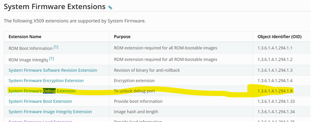

  • Hi mizutani,
    Certificate of tiboot3.bin binary.
    Does your x509 cert template contain OID  1.3.6.1.4.1.294.1.8.
    If it is present in the bootloader certificate will try to open the debug ports.
    Diwakar
