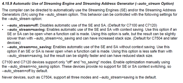

We are using TI C7000 Compiler v5.0.0 with CCS12.8.1 for a C7120 development. We need to use the --auto_stream=no_saving option described in Section 4.15.9 of the Compiler user's guide www.ti.com/lit/spruig8 (excerpt below), but we do not see this option in the CCS project options. Please show us how to specify this option for a CCS based build.
