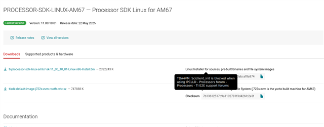

    For AM67, we have only the Linux SDK from TI. Please refer to the page below.
    https://www.ti.com/product/AM67#software-development
    AM67 Linux SDK:

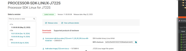

    For TDA4AEN/J722S, we have both Linux, RTOS SDK from TI. Please refer to the page below.
    https://www.ti.com/tool/download/PROCESSOR-SDK-RTOS-J722S
    TDA4AEN Linux SDK:
    Note: RTOS SDK is only for the TDA4AEN EVM compatible with Linux SDK as pointed above, If you are using with AM67 Linux SDK, you need to take care of pins and functional mapping.
