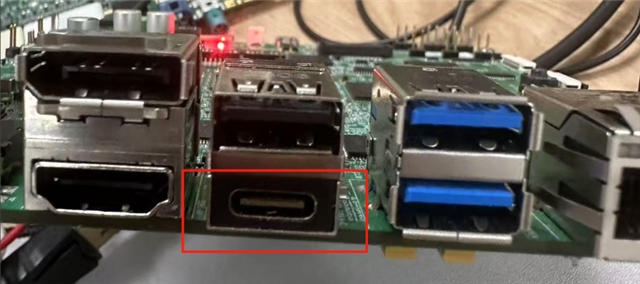

1. linux sdk 11 version;
2. Use the evm board to test the usb0, Type-C interface;
3. When a usb2.0 USB flash drive is inserted into type C, The evm board did not detect device insertion.

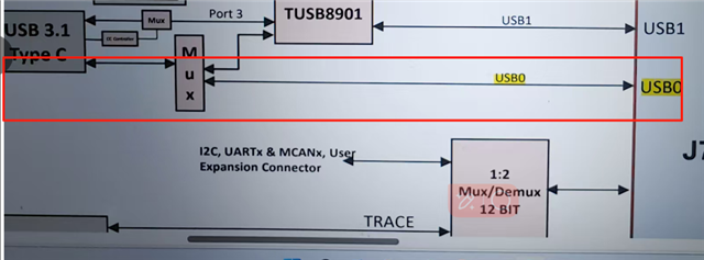

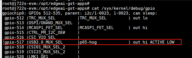

  • Hi Gokul,
    1. Your modification is incorrect. By default, it connects to usb0
    gpios = <5 GPIO_ACTIVE_LOW>;
    - output-high;
    + output-low;
    Your configuration will actually output a high level;
    I measured it with a multimeter and it indeed outputs a high level.
    In this way, he will be connected USB1_HUB_DN4_D_P
    2. Now I'm only making modifications
    &usb0 {
    - dr_mode = "otg";
    + dr_mode = "host";
    usb-role-switch;
    There is still no device-to-device insertion.

  • Hi Cesar,
    • Can you add the gpio patch as well which I provided once and check as it is working on my end with that patch.
    • Additionally, please ensure that the DIP Switch SW2 has its pins 2 and 3 set to "0" which corresponds to Downstream Facing Port (DFP).
    • Also test by connecting the C type cable in both orientations(ie:connect in one orientation, then check. If not working, power off the board, change the orientation of the C type cable connected,power-on and check) as only one orientation is supported by the J722S board.
    NOTE: Please try switching the orientation of type C cable  with and without the gpio patch as well.
