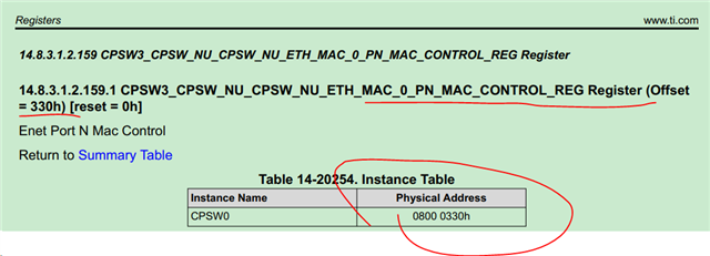

Hello
THe MAC control register is different in two version of TRM. Could you please clarify?
for version Nov,2024, the following address is :
for vrsion Aprial, 2025, the address for this register is:

Hello Changxing Du
Thank you for the query.
Let me check internally and update.
Sreenivasa
Hello Changxing Du,
Please refer below inputs i received.
It looks like the latest TRM is incorrect.
The previous address is correct.
I am checking on the plan to update the TRM and will update you at the earliest.
Sreenivasa
