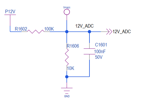

TDA4VH-Q1: The ADC cannot read the data
Part Number: TDA4VH-Q1
Other Parts Discussed in Thread: TDA4VH
Hi
SDK:10.00.08
Hardware:TDA4VH, custom board
My adc schematic diagram is
my devicetree of adc is
    //k3-j784s4-evm.dts
	mcu_adc0_pins_default: mcu-adc0-default-pins {
		pinctrl-single,pins = <
			J784S4_WKUP_IOPAD(0x0cc, PIN_INPUT, 0) /* (P36) MCU_ADC0_AIN0 */
			J784S4_WKUP_IOPAD(0x0d0, PIN_INPUT, 0) /* (V36) MCU_ADC0_AIN1 */
			J784S4_WKUP_IOPAD(0x0d4, PIN_INPUT, 0) /* (T34) MCU_ADC0_AIN2 */
			J784S4_WKUP_IOPAD(0x0d8, PIN_INPUT, 0) /* (T36) MCU_ADC0_AIN3 */
			J784S4_WKUP_IOPAD(0x0dc, PIN_INPUT, 0) /* (P34) MCU_ADC0_AIN4 */
			J784S4_WKUP_IOPAD(0x0e0, PIN_INPUT, 0) /* (R37) MCU_ADC0_AIN5 */
			J784S4_WKUP_IOPAD(0x0e4, PIN_INPUT, 0) /* (R33) MCU_ADC0_AIN6 */
			J784S4_WKUP_IOPAD(0x0e8, PIN_INPUT, 0) /* (V38) MCU_ADC0_AIN7 */
	mcu_adc1_pins_default: mcu-adc1-default-pins {
			J784S4_WKUP_IOPAD(0x0ec, PIN_INPUT, 0) /* (Y38) MCU_ADC1_AIN0 */
			J784S4_WKUP_IOPAD(0x0f0, PIN_INPUT, 0) /* (Y34) MCU_ADC1_AIN1 */
			J784S4_WKUP_IOPAD(0x0f4, PIN_INPUT, 0) /* (V34) MCU_ADC1_AIN2 */
			J784S4_WKUP_IOPAD(0x0f8, PIN_INPUT, 0) /* (W37) MCU_ADC1_AIN3 */
			J784S4_WKUP_IOPAD(0x0fc, PIN_INPUT, 0) /* (AA37) MCU_ADC1_AIN4 */
			J784S4_WKUP_IOPAD(0x100, PIN_INPUT, 0) /* (W33) MCU_ADC1_AIN5 */
			J784S4_WKUP_IOPAD(0x104, PIN_INPUT, 0) /* (U33) MCU_ADC1_AIN6 */
			J784S4_WKUP_IOPAD(0x108, PIN_INPUT, 0) /* (Y36) MCU_ADC1_AIN7 */
	&tscadc0 {
	pinctrl-0 = <&mcu_adc0_pins_default>;
	pinctrl-names = "default";
	status = "okay";
	adc {
		ti,adc-channels = <0 1 2 3 4 5 6 7>;
&tscadc1 {
	pinctrl-0 = <&mcu_adc1_pins_default>;
	status = "okay";
	adc {
I tested the voltage values of TP2937 and TP2941 with a multimeter and confirmed that there was input voltage at both test points. But when I use the command cat/sys/bus/iio/devices/iio: device1 / in_voltage * _raw, to check the adc value, found that all the value is 0.
Meanwhile, I would like to ask how to confirm whether the ADC module has received the voltage input? Is there a certain register value to represent the status value of GPIO Y38? Or could you offer suggestions for the next step of investigation
Could you take a look ?
    Thanks for the details. Could you please also confirm the SDK version that's being used?
    Keerthy
    The SDK version is ti-processor-sdk-linux-adas-j784s4-evm-10_00_00_08.
    could you offer suggestions for the next step of investigation?
  • Apologies for the delay. I am checking internally, I will get back to you in a couple of days.
    - Keerthy
  • Hello BoWen,
    Please share the complete boot logs for us to analyze if there are any evident failures & also attach the file: k3-j784s4-j742s2-mcu-wakeup-common.dtsi for us to check.
    - Keerthy

    Hi Keerthy,
    the boot log is shown as above.
    I conducted tests according to both modes mentioned in the document and found that the results were both 0.
  • Hey BoWen,
    I verified the same SDK on J784s4-evm for ADC. I cannot see any obvious differences in the device tree you are using, can you please attach your k3-j784s4-j742s2-mcu-wakeup-common.dtsi as well. From a software perspective things seems to be ok on your end.

    root@j784s4-evm:~# modprobe ti_am335x_adc
    root@j784s4-evm:~# cat /sys/bus/iio/devices/iio\:device0/scan_elements/in_voltage1_type
    le:u12/16>>0
    root@j784s4-evm:~# cat /sys/bus/iio/devices/iio\:device0/in_voltage4_raw
    1104
    1105
    root@j784s4-evm:~#

    I test ADC0 which connect to power directly, the value of 1 read out is also 0,and i test TP1601 with a multimeter and confirmed that there was input voltage
    so i am confused.I want to know how to determine that the ADC0_AIN0(P36) pin has received the voltage value? And whether there is a corresponding register to store this value.
    Bowen
    No such register.
    - Keerthy
