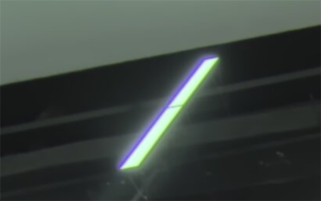

Can AM62P ISP support such Chromatic Aberration tuning?
Xingxing
Ok. AM62A7's ISP can do chromatic aberration correction.
I guess the purple line was caused by Chromatic Aberration, right? The AM62A7 ISP should be able to correct that.
We see an CAC module in the tuning tool. We tried different parameters. but did not see any effect. Any newer sdk version needed to support this feature?
Have checked this FAQ: e2e.ti.com/.../faq-tda4vh-am62a-how-to-create-the-cac-mesh-lut-for-dcc-tuning-tool-input
