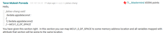

TDA4AL-Q1: How to make sure .cinit section has the same load address after compiler linker
Part Number: TDA4AL-Q1
Hi, Dear Expert
This thread is an extend discussion of this thread.
 J721S2XSOMXEVM: Who and What to generate the .cinit of freertos_mcu1_0_release.xer5f.map ?
I am not sure this is a right question, because I an not understand compiler linker use case.
As far as I know, the compiler creates .cinit records for each "statically" initialized variable, which containing the "variable's location" and "initial value" The linker then gathers these records into the final .cinit section
For example, we define some constant "static variable" in code, and try to make alignment w/ section "fardata.appdataconst"
Should we expect APP_DATA_CONST has the same memory load address after code compiler and link w/ each time compiling?

For example, we know fardata.appdataconst.load address  = a08bc6a8
.cinit     0    a08a5300    00026300
                  a08a5300    00000008     (__TI_handler_table)
                  a08a5308    00000030     (__TI_cinit_table)
                  a08a5338    00000008     (.cinit..bss.load) [load image, compression = zero_init]
                  a08a5340    00017356     (.cinit..data.load) [load image]
                  a08bc696    00000002     --HOLE-- [fill = 00000000]
                  a08bc698    00000008     (.cinit..bss.devgroup.load) [load image, compression = zero_init]
                  a08bc6a0    00000008     (.cinit..tracebuf.load) [load image, compression = zero_init]
                  a08bc6a8    0000ee58     (.cinit..fardata.appdataconst.load) [load image]
                  a08cb500    00000008     (.cinit..bss.appdatavar.load) [load image, compression = zero_init]
                  a08cb508    000000f8     --HOLE-- [fill = 00000000]
then Link generated,
.fardata.appdataconst: load addr=a08bc6a8
LINKER GENERATED COPY TABLES
__TI_cinit_table @ a08a5308 records: 6, size/record: 8, table size: 48
	.bss: load addr=a08a5338, load size=00000008 bytes, run addr=a0728000, run size=0013ad26 bytes, compression=zero_init
	.data: load addr=a08a5340, load size=00017356 bytes, run addr=a0880700, run size=00017380 bytes, compression=copy
	.bss.devgroup: load addr=a08bc698, load size=00000008 bytes, run addr=a0726c30, run size=000013c5 bytes, compression=zero_init
	.tracebuf: load addr=a08bc6a0, load size=00000008 bytes, run addr=a0100400, run size=00080004 bytes, compression=zero_init
	.fardata.appdataconst: load addr=a08bc6a8, load size=0000ee58 bytes, run addr=a0fa0000, run size=0000ee50 bytes, compression=copy
	.bss.appdatavar: load addr=a08cb500, load size=00000008 bytes, run addr=a0f90000, run size=00009be4 bytes, compression=zero_init
Could we let this section "fardata.appdataconst" always keep the same address , example like  a08bc6a8 ?
Because customer feedback, this address may sometime changes for each code build.
Is it possible to fix this address location?
