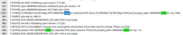

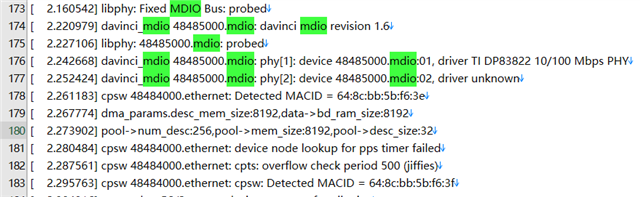

    The following information was found in the startup log:
    Search for printing information(TI DP83822 10/100 Mbps PHY) in SDK as follows:
    It can be seen that the driver of this phy chip is dp83848.c
    However, upon reading the information on dp83848, it was found that it does not support optical transmission or RGMII.
    So I want to confirm if I can use this driver to adapt to the DP83822 chip for optical port transmission? Do we still need the DP83822 driver to achieve optical transmission?
    If it's the latter, the dp83822.c you gave me last time is not working well, I put it in the SDK directory: /ti-processor-sdk-linux-am57xx-evm-04.03.00.05/board-support/linux-4.9.69+gitAUTOINC+9ce43c71ae-g9ce43c71ae/drivers/net/phy/
    After changing the Makefile in the directory, the compilation failed. Is this issue caused by the need to change other content or a mismatch with the SDK version? Please help me.

    2.I don't know how to get PHY register dump. Is it in the startup log? The attachment is the startup log.
    Thank you,
    Jiabin

    [    8.698054] libphy: PHY 48485000.mdio:02 not found
    [    8.698061] net eth1: phy "48485000.mdio:02" not found on slave 1, err -19
    [    8.742356] cpts ptp bc clkid 0
    [    8.755032] IPv6: ADDRCONF(NETDEV_UP): eth1: link is not ready
    [    8.773759] net eth0: initializing cpsw version 1.15 (0)
    [    8.921077] ata1: SATA link down (SStatus 0 SControl 300)
    [    8.938412] TI DP83822 10/100 Mbps PHY 48485000.mdio:01: attached PHY driver [TI DP83822 10/100 Mbps PHY] (mii_bus:phy_addr=48485000.mdio:01, irq=168)
    [    8.970960] IPv6: ADDRCONF(NETDEV_UP): eth0: link is not ready

    1.Because in the development of optical modules, this unique optical port network device is connected to the other end through a switch's regular electrical port, displaying 100Mbps full duplex.
    The communication is working as expected when viewing status from the link partner?
    It is not in startup log - please see this FAQ for guide on register access:
    https://e2e.ti.com/support/interface-group/interface/f/interface-forum/1164499/faq-how-to-read-and-write-ethernet-phy-registers-using-a-linux-terminal?tisearch=e2e-sitesearch&keymatch=how%20to%20access%20registers%20using%20linux#

    1.Because my computer's Ethernet is an electrical port and the board is an optical port, I tested the communication using a switch. All my computer looks normal, and the communication performance can reach 93Mbps when tested with iperf. It seems normal, but I don't know if the iperf testing mechanism is consistent with normal practicality.
    2. Please refer to the attachment for the phy register dump of the board.
