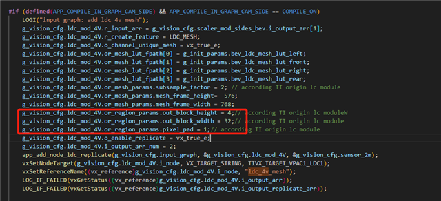

TDA4VH-Q1: LDC MESH performance optimization
Part Number: TDA4VH-Q1
Other Parts Discussed in Thread: TDA4VH
TDA4VH custom board
SDK 11.0 linux + freertos
Our board is equipped with 6 cameras, a 8M front camera, a 2M rear camera, and four 3M side camera.
The following log is the performance data we have obtained. We have the following questions regarding this:
1.We have observed that the load of LDC MSC in the HWA performance exceeds 100% in all cases. Is this reasonable? And if this continues for a long period of time, will it lead to any abnormalities?
2.We used VPAC1 LDC for LDC MESH and VPAC2 LDC for LDC COLOR CONVERT. We found that both LDCs could reach 700 MP/S when the percentage was 100%, but VPAC1 LDC could only reach 60 MP/S.
We want to know if this is reasonable and whether we can optimize the LDC. Because the current frame rate cannot meet our requirements.
3.Does TI have any tools or documentation for the performance testing of the VPAC LDC MSC, similar to the edgeai-benchmark?
4.Does TI have any documentation on how to optimize the performance of LDC?

    What's the block size that you are in LDC?
    We did not configure the block size parameter, so it is possible that the default value was used.What configuration did you suggest?
    Furthermore, the ldc_4v_mesh node consumed 35ms. Do you have any suggestions for optimizing this node?
  • Do you mean to replace LDC color convert with DSS M2M? Are there any corresponding examples or documentation in the SDK?
    Yes, there isn't any example in the usecase, but you can refer to conformance test example in the file video_io\kernels\video_io\test\test_display_m2m.c.
    The default block size could be small, so can you please check and try to increase it?
    Are you running through DCC tool for this LUT to calculate out optimal block size for this LUT?

    The block size configuration of the ldc_4v_mesh node is as follows, and the input is 1920*1536, the output is 768*576. It is also a four-channel image.
  • Can the ldc_4v_mesh node be further optimized? Or how can we determine if this has reached its limit?
    One possible way is to check this LUT and these parameters in standalone environment.
    The performance really depends on the LDC LUT, so lets first check the performance in the standalone environment.
    Additionally, can you run through this LUT using DCC tool? DCC tool can provide optimal block size for this LDC LUT.

    We referred to the following documents and the corresponding configurations are as follows.
    https://www.ti.com.cn/cn/lit/an/zhcabz8/zhcabz8.pdf?ts=1684133481903&ref_url=https%253A%252F%252Fwww.ti.com.cn%252Fproduct%252Fcn%252FTDA4VM
    We tested the performance of the ldc mesh nodes using the final generated binary file. Currently, it is around 40ms. Frame rate is 25.
    Does increasing the size of SL2 have any impact on performance optimization? Where is the configuration for SL2 size in the SDK?
  • ok, can you please try increasing this number and see if there is any difference?
  • hi
    We attempted to increase this value to 36864, but it seemed to have no effect. We suspect that we need to modify the default values in the SDK simultaneously
    Where is the SL2 size parameter configured in the SDK?

  • We have modified your demo according to the actual usage method. The time consumed for testing one frame of image is approximately 7.7ms. Could you please check if it can be optimized?
  • Let me check the way you are using LDC.
  • What's the input and output image and block size that you are using?
  • Hello
    It is very likely the block side is too small in your setting. can you try block size 64x64?
    Your block size is too small
    cc
    Adam
  • hi
    After modifying the block size to 64x64, the time consumed by LDC decreased to around 1ms. However, when comparing with the generated images, it appears that they are somewhat blurry.

    Did you check your LUT with the DCC tool and have calculated the optimal block size required for the LUT?
    Brijesh
  • Hi
    echo Brijesh said.
    I use your settings and fine search mode in dcc.
    and the processing time is about 4ms per frame:

    We used the "fine search" mode to obtain the configuration of the "output block width" and "height", and we also checked the "tuning output" image, which appeared to be normal.
    We exported the dcc bin file and synchronized the corresponding parameter settings to the demo program. However, the image generated by the demo program at the end was blurry.
    root@tda4vh-dt2vh:/hirain/data/debug_ldc_mesh/linlin# ./vx_app_ldc_dcc_fine_search.out 1920 1536 1920 1536 ./csix_raw_output_1920x1536_ch_0_00000154.yuv img_out_ch0_88x56.yuv ./cid42_asamplesensor_mesh_ldc2_dcc_fine_search.bin 5253 0 1

    May be there is some pitch issue in the generated DCC file for the lut. I am not able to figure out from the shared dcc bin file. So can you please read below register and share its value.. I am assuming that you are using VPAC0 on TDA4VH.
    0x03820020
    This value should be 512 (((1920/16 + 1)+15 & ~0xF) * 4). If not, it can potentially create the issue in reading Lut.
    Brijesh
