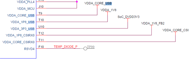

1. as below show, what's the VDDA_1P8_USB for?
2. as below show, how to know USB0_DM powered by 1P8 or 3P3? i mean in application, where can config this voltage? or decide by what?
thanks!
thanks!
Hi Liujian Zhang,
There is no need to worry about any configuration here. VDDA_1P8_USB pin needs 1.8 V and VDDA_3P3_USB needs 3.3 V at the same time. Both are needed for proper USB PHY operation.
Stan
does this mean VDDA_1P8_USB and VDDA_3P3_USB both will supply to inside USB PHY? could you pls help to share more details?
thanks!
Yes, correct, both pins need to be connected to 1.8- and 3.3-V filtered power supplies.
I cannot share internal USB PHY details as this is internal data.
Stan
