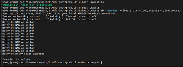

 I am implementing the following boot sequence in UART boot mode and encountering an error:

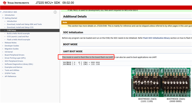

1.switch dip switch to "uart boot mode", and make sure char "C" appears on /dev/ttyUSB2. Is ttyUSB2 "MAIN_UART" ?
BOOTMODE [ 8 : 15 ] (SW4) = 0000 0000
BOOTMODE [ 0 : 7 ] (SW3) = 1101 1100
2.downloading the tiboot3 via the below command:
sb --xmodem ./tiboot3.bin > /dev/ttyUSB2 < /dev/ttyUSB2
3. dowonloading Timeout,as show below:
Can you please help to solve the error(above setp3)? could you please correct the setps mentioned  above ?
