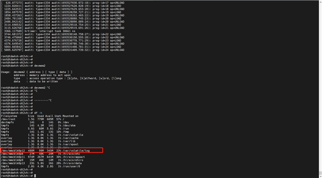

    So where are you hosting the rootfs?
    Our storage medium is EMMC, so the rootfs is stored on the EMMC.
    Is this a custom eMMC?
    yes
    What use cases were running?
    Our app mainly involves the processing of camera images, the transmission and reception of Ethernet packets, as well as the execution of some models.
    Was the Linux Idle or some rootfs is being accessed contnuously?
    Our app will continuously store logs to the emmc via syslog.
  • Hi Hongyao,
    This is happening because the eMMC EXT4 partition ran out of memory as you are continuously logging information for 8 hours
    Gokul
  • hi
    We have a 480M log partition. However, after we encountered this issue, we restarted the board and by using the "df -h" command, we could see that the log partition still had free space and was not completely filled.
  • Hi Hongyao,
    I will look into this and get back to you.
    Gokul
  • hi
    We have disabled the logs for all our apps. Currently, the apps are generating very little log output, except for some error messages.
    But this problem still occurred.

  • Hi Hongyao,
    The error coming up now is very different from the earlier error as now the errors are not related to memory running out.
    Can you try storing the logs in a different boot media like SD card, as I don't think the storage media is the issue here.
