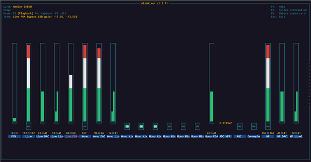

  • Hi Sajan,
    Are you trying to run on AM62A EVM or custom board? Have you modified the Device tree or any custom changes related to audio?
    Also, can you try to run the below amixer controls first and then give it a try:
    amixer -c 0 cset numid=71 on
    amixer -c 0 cset numid=70 on
    amixer -c 0 cset numid=64 on
    amixer -c 0 cset numid=65 on
    amixer -c 0 cset numid=15 127
    arecord -D hw:0,0 -r 48000 -c 2 -f S16_LE test.wav -d 10
    aplay test.wav
    Let me know how it goes.
    Suren
  • Hello Suren,
    Using AM62A EVM
    No
    Yes, It working
