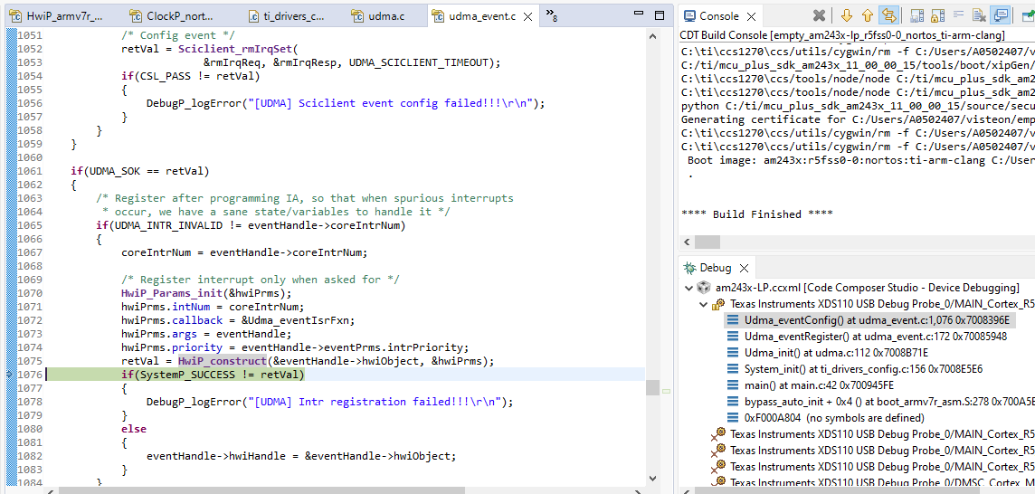

    I investigated the DMA settings.
    HwiP_construct is called in Udma_eventConfig, but priority=1 was set.
    The 20kHz interrupt priority is 1.
    This causes a delay in calling the 20kHz interrupt handler.
    Therefore, it is necessary to lower the DMA interrupt priority in MCSPI.

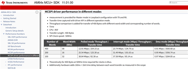

    I looked at the performance numbers for the different modes.
    According to the report, the throughput in DMA mode is slow. Interrupt mode is the fastest, so why is DMA mode slower?
    Kiyomasa Imaizumi.

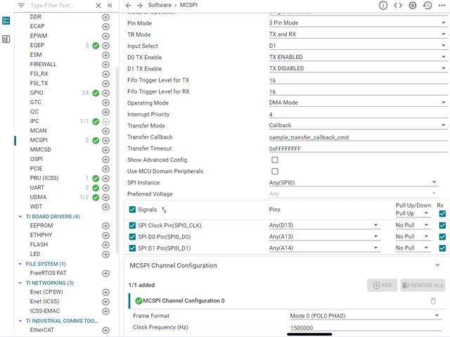

    The clock is 1.5MHz
    I would recommend using one of the supported clock frequencies from the list shown here:  RE: [FAQ] SK-AM64B: MCSPI Integration Guide

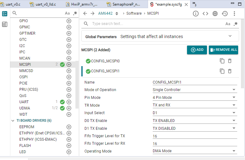

    From your sysconfig setting, I see you have configured 3 pin mode, please set that to 4 pin mode to make sure all the 4 lines Clock, MISO, MOSI and CS is used.

    I have observed that the interrupt priority is set to 1 for me as well.
    The place where it is called/set is as shown in the screenshot above. You might also notice that I have ran the above program in AM243-EVM but that will be not a problem as the flow is almost similar to AM64x-EVM in this case TMDS64EVM. For me as well, the interrupt number is 75 and the priority is shown as 1.
    So we are on the same grounds as per the information shared by you.
    I would say, the best way to set the interrupt priority is hardcoding the value to your custom value(in this case you choose 5) in the file udma_event.c itself.
    So basically, hardcoding the value
    hwiPrms.priority  = 5
    and then rebuilding the libraries to make sure changes are saved, Then you would need to rebuild the application you are using.

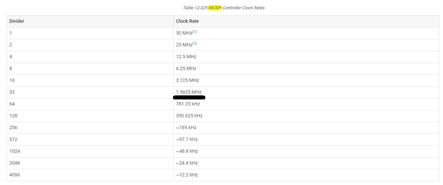

    Regarding 1.5MHz (1500000Hz), does that mean it should be set to 1.5625MHz (1562500Hz)
    I'm not using CS pin so I'm deliberately using 3pin mode.

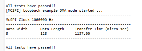

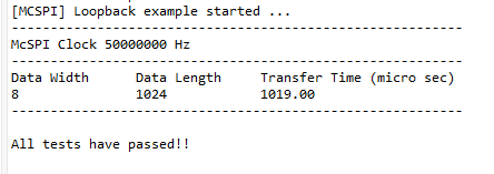

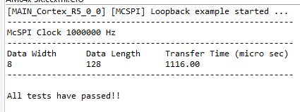

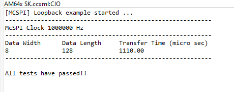

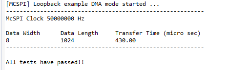

  • For 128 bytes transfer:
    Interrupt
    Polled
    DMA
    For 1024 bytes transfer: I see improvement for Polled vs DMA.
    Polled
    DMA

    What I would like to know is why the throughput decreases in DMA mode in the throughput graph below.

    Regarding 1.5MHz, does that mean I should set it to 1562500Hz in sysconfig instead of 1500000Hz?
    Kiyomasa Imaizumi.
    Yes 1562500 should be ideal as the divider value which is acting on 50 MHz as 32, will yield 1562500. We cannot achieve 1.5 MHz as the dividers are in powers of 2.
    Please let me know if upon setting 1.5 MHz are you seeing the exact frequency on the waveform? This would be a good approach to decide if 1.5 or 1.56 is the way to go.

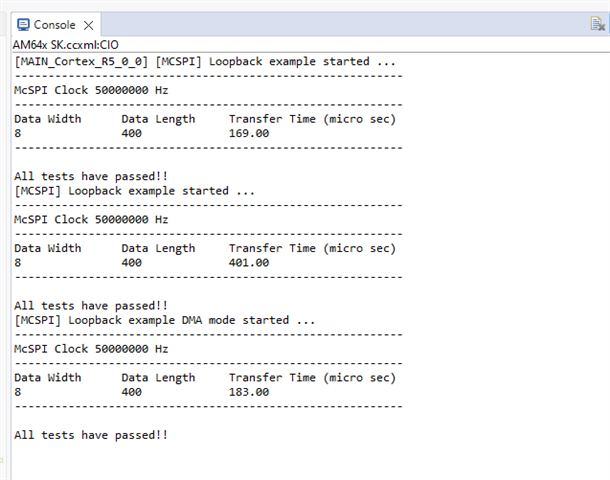

    On the throughput, I believe the time written for DMA is incorrect and I will propose to have this fixed for the next release.
    Currently with the setting as mentioned in the performance datasheet linked, this is what I see.
    Please note the following is in order of Interrupt, Polled and then DMA.
    Vaibhav
    I have filed a documentation bug to fix these numbers, thank you.

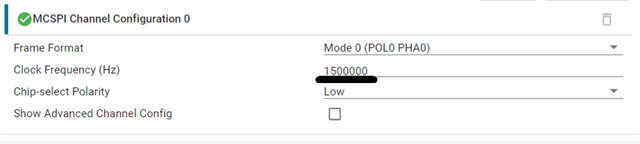

  • Hello Vaibhav Kumar.
    When I set "Clock Frequency (Hz)" in sysconfig to 1500000, the actual measured clock value was 1.449MHz.
    However, when I set it to 1562500 or 1562000, no clock waveform appears at all.
    Why is no clock displayed?
    Is it correct that 1.449MHz appears when set to 1500000?
    I was expecting 1.56MHz, but that doesn't seem to be the case.

    Regarding the MCSPI build error, I solved it by deleting the MCSPI instance in sysconfig and then reconfiguring it.
