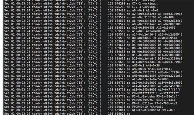

TDA4VH-Q1: After the model was exported, there was an abnormal crash issue on the EVM.
Part Number: TDA4VH-Q1
Other Parts Discussed in Thread: J784S4XEVM, TDA4VH
When this model is exported based on the TIDL11_00_08 version in 8-bit or partial 16-bit format and is run on the EVM using C7X, a crash occurs. However, the PC simulation results show no problem.
The relevant program will be placed in the attached file at the end. The execution command is as shown in the following figure.
The phenomenon of EVM crash is shown in the following figure.

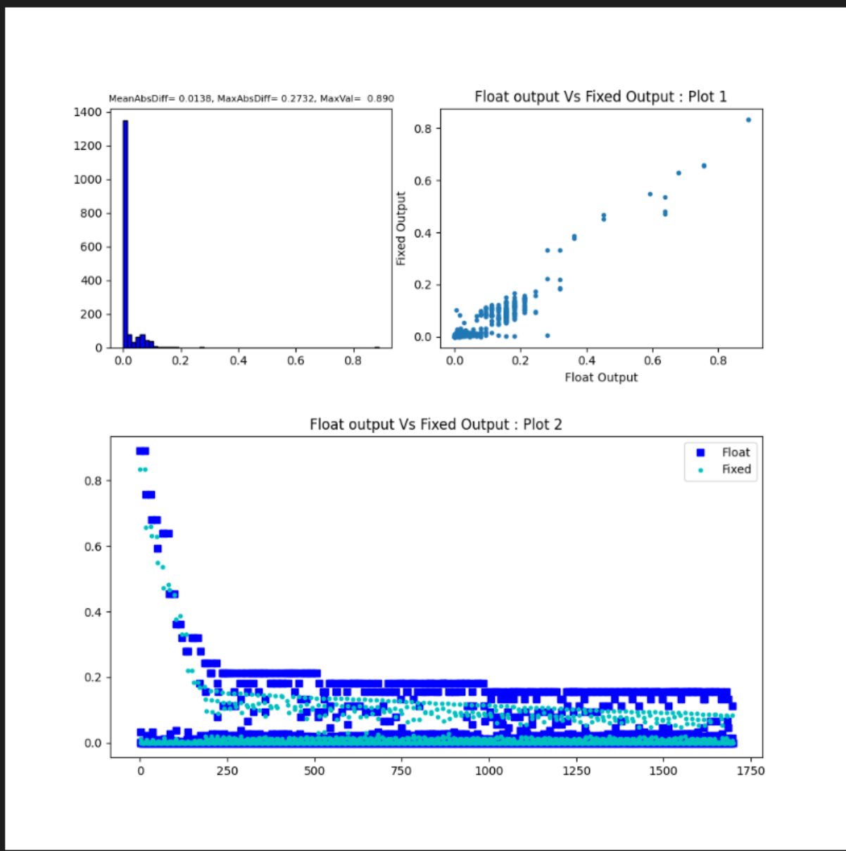

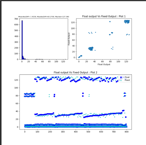

The PC simulation has output results.

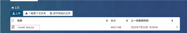

  • Hi Wenli
    For the attachment, please check https://tidrive.ext.ti.com/a/LF5HNu7eR3s-Xkcu/0cf65a13-1543-471e-b4f5-f8271d9bef1e?l The file is too large for e2e.

  • Adam asked me to upload it to this link: https://tidrive.ext.ti.com/u/rhCtoWyQreu8EK25/be82eaa2-15a4-499e-86cf-b0b09afca3a1?l     密码是:7_JuHpD2
  • Thanks Hongyao and Adam; I got the files. And I will have the EVM board available tomorrow morning and will try to test it.

  • Hello;
    I tried to do the inference on the EVM by using the artifacts generated from 11.0, but it has some problems running on the EVM.
    I then used the latest version 11.1 to check the model again. The compiler had some problems during the model parsing and optimization. I attached the error message here.
    We will need to start with the model first. Make sure it can pass the compiling and inference when it stands alone. Have you done model only inference on your end?
